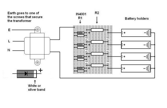

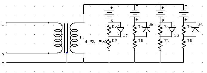

Chris-b’s voltage bargraph thread prompts me to describe a circuit I found in a magazine article 20 years back, which some may find interesting. The thrust of the article was that “non-rechargeable” zinc-carbon or alkaline cells can be recharged by “periodic current reversal”. The explanation given as to how periodic current reversal works whereas DC doesn’t (at least, not very well) is too long to repeat here.
The circuit applies AC current from the secondary of a mains transformer to the cell(s) to provide the periodic current reversal at 50 or 60Hz, depending on your local mains frequency. For each cell, a diode and two current limiting resistors are arranged so that (putting it simply) much less current is drawn during the discharge periods than is applied during the charge periods.
It is best not to let the cells get completely flat, but to recharge when the radio begins to sound distorted or the torch bulb begins to dim. I recharge alkaline cells (Duracell, for example) about 10 times before throwing them away. Their capacity is greater than NiCad or NiMh cells, and they give 1.5V rather than 1.2V. Thus, when a gadget calls for 6V supplied by four cells in series, it gets 6V rather than the 4.8V provided by four rechargeables.
My version was cheap to build, using a scrap mains to 4.5V transformer, a handful of resistors and diodes, battery holders and a box. I used 4 sets of resistors, diodes and battery holders to recharge up to four AA cells, and another 4 sets for AAAs. So far, none of the cells I have recharged has leaked, and if leaks do occur, this would be in the charger rather than in the appliance where the cells are to be used.
http://i689.photobucket.com/albums/vv257/andyf1108/Recharger.jpgRecharging non-rechargeable batteries
http://i689.photobucket.com/albums/vv257/andyf1108/AlkalineandZincChloridecellcharg-1.jpgRecharging non-rechargeable batteries
Being a cheapskate at heart, I feel very smug every time I use the thing  :ddb:

Much longer than you would a regular rechargeable, Bernt. Up to 24 hours for AAs (which are the ones I'm most concerned with).  A typical AA cell has a capacity of just under 3Ah, which is about twice that of a NiMH rechargeable, and because you are using AC it's only being charged for half the time. Actually, rather less than half the time, because the sine waveform needs to rise to 2.2V:  0.7V before the diode will conduct, and a further 1.5V to start pushing electrons into the cell. For the other half of the time the cell is being discharged at about 20% of the charge rate.
The article uses a charge current of about 50mA.  :smart: Using 4.5V AC from the transformer, I = (4.5 - 0.7 - 1.5) / R2, where the 0.7 represents the voltage drop across the diode and the 1.5 is the voltage of the cell. So, where R2 is 47 ohms, I = 50mA (almost).
If you have a scrap transformer of different voltage V like 12V, find R2 using the same formula rearranged as:
R2 = (V - 0.7 - 1.5) / 0.05, where the 0.05 represents the 50mA charge current.
For R1, which comes into play in series with R1 during discharge,  use the formula R1 = [(V + 1.5) / 0.01] - R2, where the 0.01 represents the discharge current which is set at around 10mA, being 20% of the charge current. During discharge the diode doesn't conduct, so doesn't come into this calculation.
I suppose the resistor ratings need to be increased if a higher voltage is used.

Has anyone got an build pictures for one of these. If anyone does build one, please take some step pictures if you don`t mind!?
Chris
Re: Recharging non-rechargeable batteries
« Reply #18 on: May 17, 2012, 01:22:36 PM »
I didn't take any build pics, Chris. But it's just simple soldering; the hardest bit is finding a suitable box and fastening the transformer and a 12 x 20 hole stripboard inside it, and the battery holders to its outside.
Here's a pic showing how things are laid out, and the track breaks.
Diagram deleted.  It contained so many errors that John Swift kindly took it in hand and his corrected version version appears a few posts further down. Read the following paragraphs in conjustion with his diagram.
This only shows four battery holders; as you will see from the first post, mine has four for AAs and another four for AAAs. Just use a 12 x 40 hole bit of stripboard and put another four sets of resistors and diodes on it, with further track breaks.
Component values are in a table in the first post. The diodes needn't be IN4001; just about any rectifier diodes will do. If you have a scrap transformer giving more than 4.5V, the calculations for it are in the fifth post in the thread. You want unrectified AC out of the transformer, so it's no good substituting it with a phone charger giving DC output.
« Last Edit: May 17, 2012, 05:15:17 PM by andyf »

« Reply #19 on: May 17, 2012, 02:29:50 PM »
The layout in the picture won't work. The top transformer secondary wire is shown connected to an unused strip on the Veroboard. The wire should go to the first strip not the second.
« Reply #20 on: May 17, 2012, 02:54:17 PM »
Oops  :bang: ! Thanks, John.
I've amended the text (the pc is on P'bucket, which I hate using) to add an Erratum note. That, of course, is a more dignified way of saying "Glaring error I should have noticed before posting this".
« Reply #21 on: May 17, 2012, 03:13:43 PM »
I think you better check that erratum text over. I think it should be as follows or am I loosing it.(wouldn't be the first time). Thanks for this idea in the first place.
ERRATUM: The top connection from the transformer secondary should go to the second first track on the PCB, not the first second.
« Reply #22 on: May 17, 2012, 03:27:09 PM »
No Don, you're not the one who's losing it. Duly edited (again!).
For me, once things start going wrong, they just get worse and worse :bang: :bang:
« Reply #23 on: May 17, 2012, 03:49:02 PM »
Andy,
While you're in the swing of posting Erratum messages you might want to look at the diode symbol - you've got it the wrong way round - the white or silver band should be on the cathode side!
Offline John Swift
  • Posts: 344
« Reply #24 on: May 17, 2012, 04:09:43 PM »
Hi Andy
I've re done your diagram

The magazine was not totally fruitless. The diagram shown is slightly different than the reconstructed
one done on page one, I have attached a screen print from expresssch/easypcb.
I think the idea is have at least two batteries charging at any one time, and have them in either the 1
& 2, or the 3 & 4 positions, to ‘balance’ out the cct.

In true Darren style I have not tested the ‘AA’ resistor array that I found already constructed, I have
calculated Ra/b values for a PP3 9V battery after finding an old 30VA 13V(16.5VAC) transformer and am
currently testing my timer cct with it! I’ll let you all know if there is any success.
I was a little puzzled with the original writer’s W values for the resistors?!? Take the ‘AA’ Rb value
of 47R posted at 1W. If you use the original formula I=(Vsupply-Vdiode-Vbatt)/Rb:
I=(4.5-0.7-1.5)/47=49mA
P=I2*R=0.0024*47=113mW – not even a 1/8W and P=IV=0.049*2.3(Vs-Vd-Vb)=113mW
Anyone who can corroborate my sanity eitherway, please post…!
I reached for dictionary and then skratchen my head - got splinters under my nails. That circuit looks a little dodggy (not really a current regulator or anything of that nature) - I believe succes depends on fitting the battery and transformer characteristics close enoug. Something similar to tricle charge e.g. when battery voltage rises "full", very little charge current is left over battery, making charging SLOW but dispenses with delta cutout and timers and such.
RE: resistance and wattage ratings of the shunt resistor you are calculating. You are assuming in your calculation nice constant book value of battery internal resitance. Real life batteries always don't behave well. The ones building and using circuits don't behave taht well either.
What about if the battery has short circuit or fully charged battery is inserted wrong way? Or someone changes resistanced for big fat D-battery and then accidentaly rams in NiCd? Your variables here are transformer and resistors.
And resistors are not that ideal either, sometimes fairly much bigger wattage resistor is choosen to prevent it heatting (bad for circuit, fire, or resistance changes too much) and sometimes bigger is choosen because wirewound might suplly a inductance needed (very unlikely in this app). Then again if the writer/designer does not tell, it just might be what he had in the box and what worked for him!
