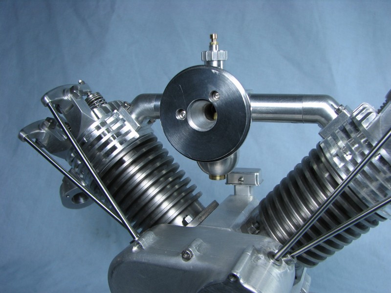

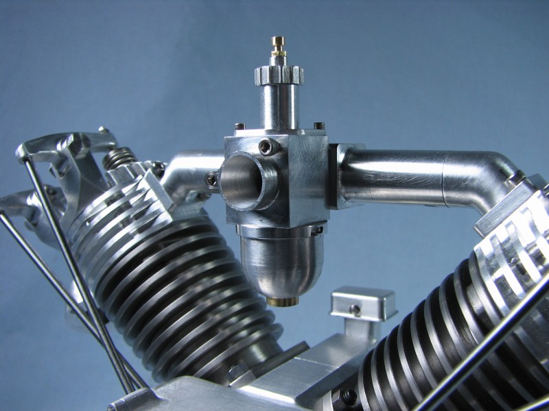

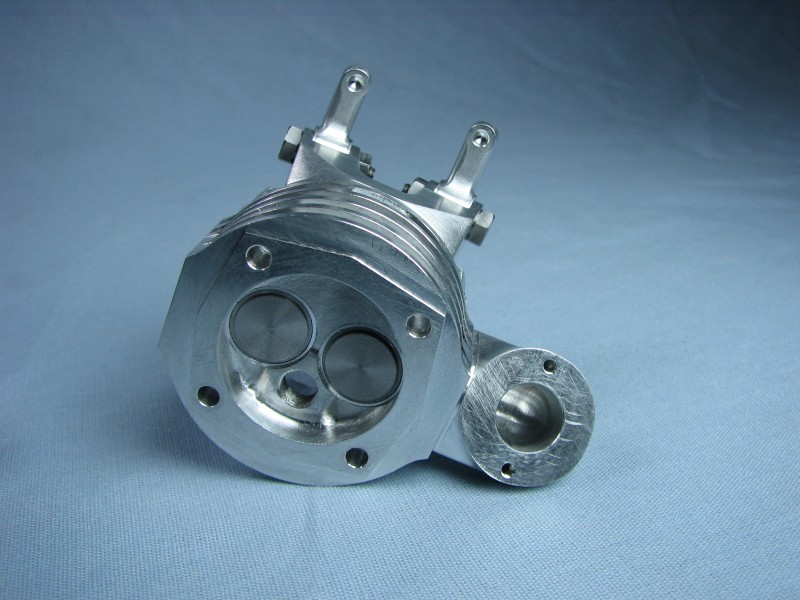

Gentlemen, here's some progress shots of my current project. It's a 90 degree V-twin engine, 1.00 bore 1.25 stroke, air cooled and pressure oiled. Everything is machined from solid material. The crankcase is 6061 aluminum as are the timing cover and rocker arms. The crank is 1144 steel and the rods are mild steel. The valves, keepers and spring holders are stainless. I designed it several months ago and got started on the build shortly after.
George

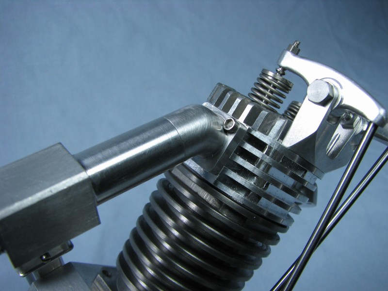

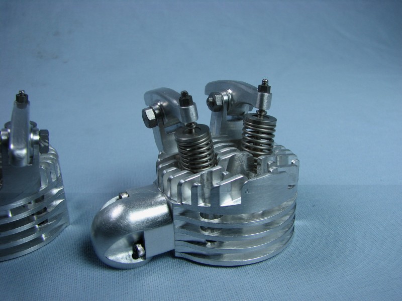

« Reply #1 on: January 03, 2010, 08:59:22 AM »

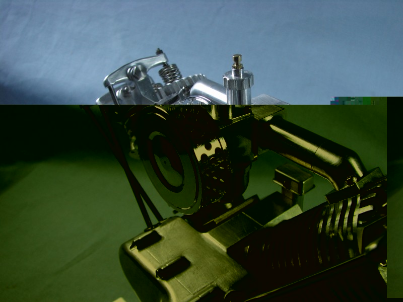

Some more pictures.

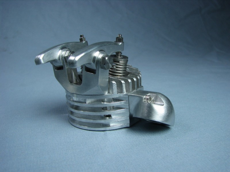

« Reply #2 on: January 03, 2010, 09:00:03 AM »
One last shot.

« Reply #3 on: January 03, 2010, 10:01:04 AM »
George,
That's some real nice fabrication job.  :thumbup:
Nice finish. I take it that is was done with a grinder, files and sand paper?

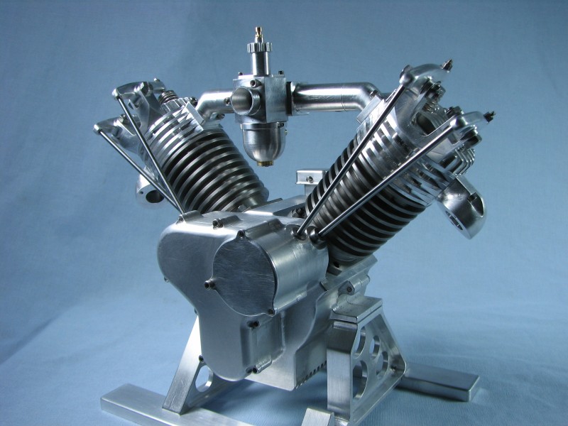

The next few shots are with the engine assembled and the intake manifold fitted.

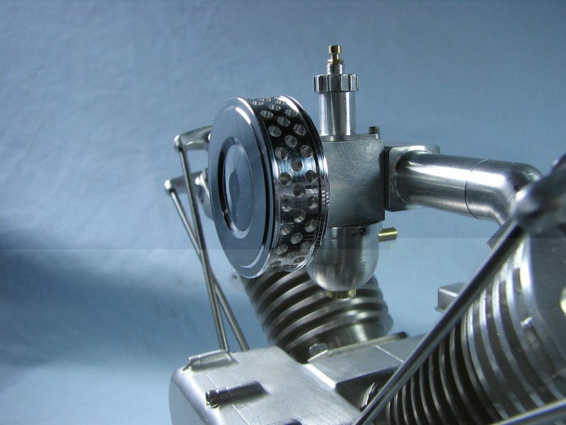

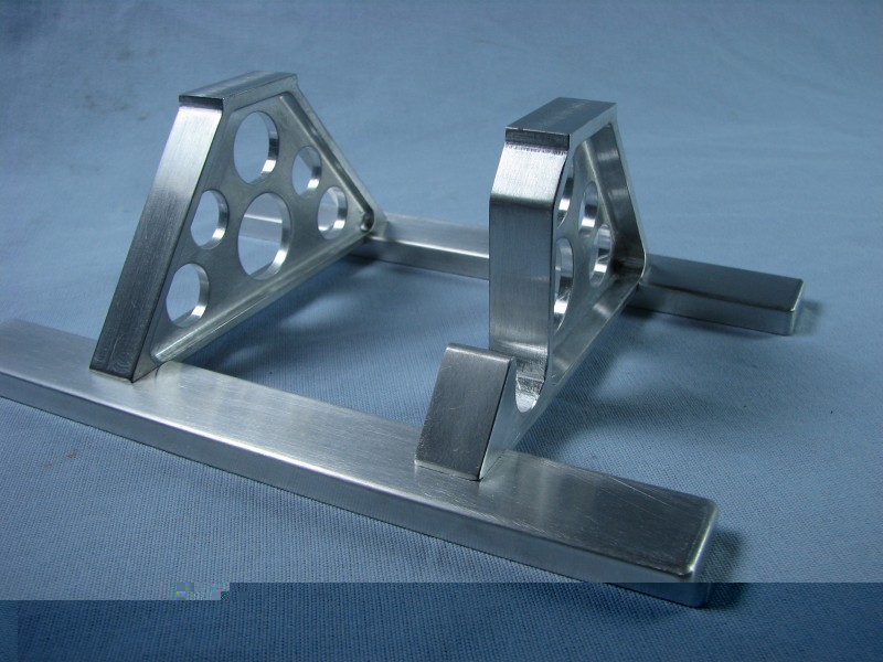

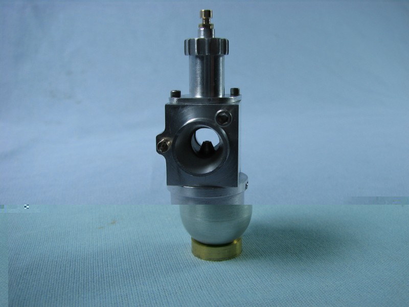

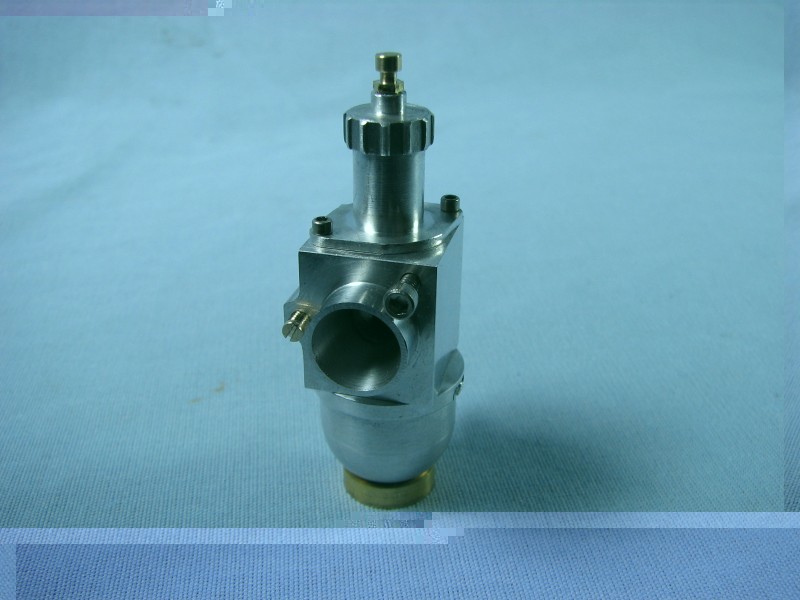

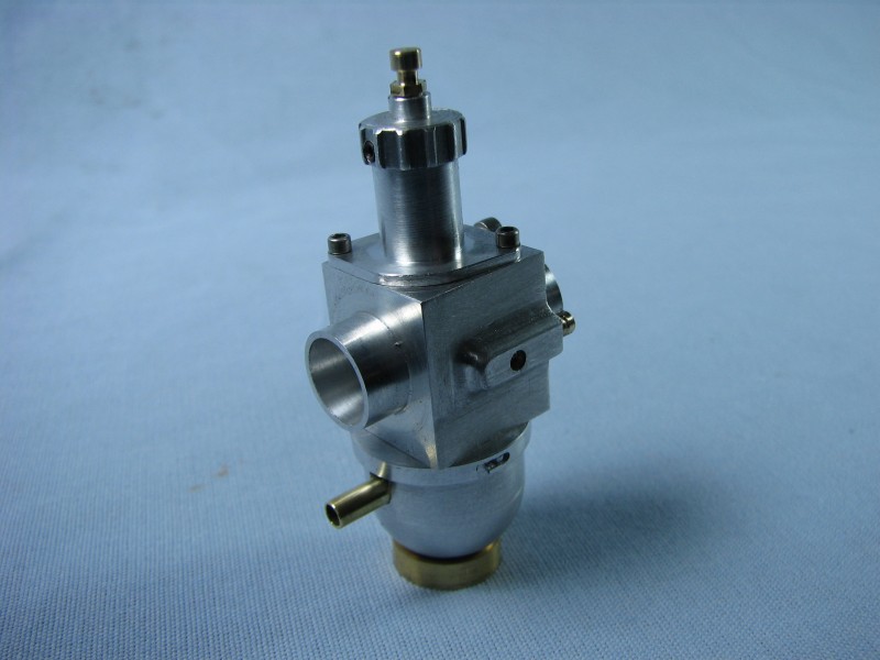

Within the last few days I have finished the engine base/motor mount and the carburetor. Although the carb is just a simple air bleed type I wanted it to look like it was made for this engine so I prettied it up by adding dummy pieces to it like the float bowl and upper barrel and cap. The upper cap was made to look like the cap on a motorcycle carb that holds the slide and spring in place. On my carb it is set screwed to the throttle barrel and will serve as the throttle link. I even went a step further and added a dummy cable adjuster to the top.
Offline gbritnell
  • Posts: 70
Re: 90 degree V twin engine (my own design)
« Reply #8 on: February 17, 2010, 06:16:38 PM »
Here's the final pics of the carb.
George

Today's update. I took the manifold off and bored the hole for the carb. It's a snug fit but will also have a small set screw in the bottom. I then made up an air cleaner cover and back plate. I didn't have enough room between the inlet tube on the carb and the head on the adjusting screws so I made the backplate a little bigger and drilled out the holes for the screw. I then relieved the back side around the boss and screw holes. The cover was machined and buffed, after which I drilled all the holes. I did it this way so that the buffing wouldn't round over all the holes. I thought that a shiny piece or two would contrast the finishes on the rest of the pieces.

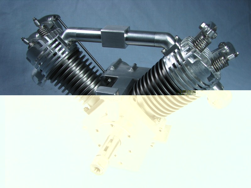

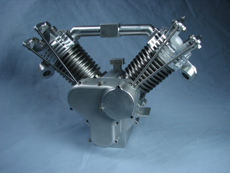

Here's an update on the engine. I wanted to built the exhaust from .375 stainless tubing. I didn't have a bender sturdy enough to do the bending so I had to make another one. In my experience bending tubing, even with a good bender I get somewhat of a flat on the outside radius of the pipe. I spoke with a fellow builder and asked if he had ever used Cerro alloy to fill the tubing prior to bending. He said he did and had good luck with it. I ordered a small cube from Ebay (expensive stuff!)
 Once the alloy arrived and I had the bender built I set about bending the tubing. I put the alloy in an old coffee can and put this into boiling water, the alloy I got has a melting point of 154 degrees. I filled the first piece of tubing and when the alloy cooled I took it out to my big shop vice and proceeded to try out my new process. I clamped the tube into the bender, put a 12" adjustable wrench on the lever arm and started bending. It bent much easier than I thought it was going to. I took the piece of pipe out of the bender to check the bend, wow, absolutely perfect, no flat spot whatsoever.
 Now it was just a matter of making up the other bends and slowly fitting everything together. Being that the front exhaust pipe had to pass through the motor mount I decided to make it in two pieces and silver solder it together. The construction of the bender and the radius that I used wouldn't allow me to get two bends close together and beside that I didn't know how many pieces of pipe I would go through trying to get a good one.
 The rear pipe required different bends than the front pipe because I wanted it to stack on top of the front pipe. I think I have about 24 hours in the bender, cutting the tubing, filling with alloy, bending, melting the alloy out, filling and fitting the pieces and silver soldering everything together.
 I must say that I am quite pleased with the outcome. Even with the small connecting sleeve on the pipes I think it looks good.
 The first several pictures show the fitting up of the front pipes. I turned down a piece of aluminum to locate and support the pipe for soldering.
The next pictures show everything polished and assembled.

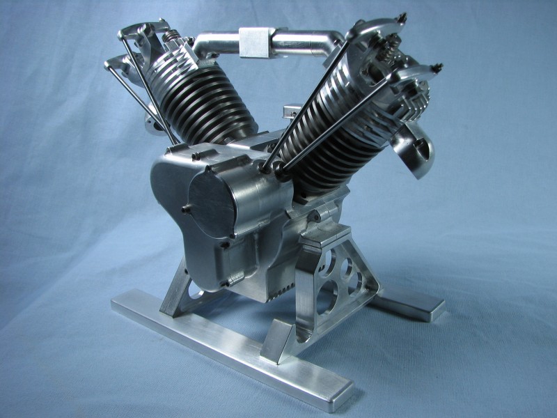

Gentlemen, well today was the second trial. I had started it the other day but ran into a few problems, starter setup, leaky valve, blown headgasket. I got those things taken care of and went out this morning for the second try. All it needs now is some fine adjustment on the carb and I think we'll have it.
George

Amazing, to me at least, that this was not even four months from paper to runner.  Pretty inspiring!
