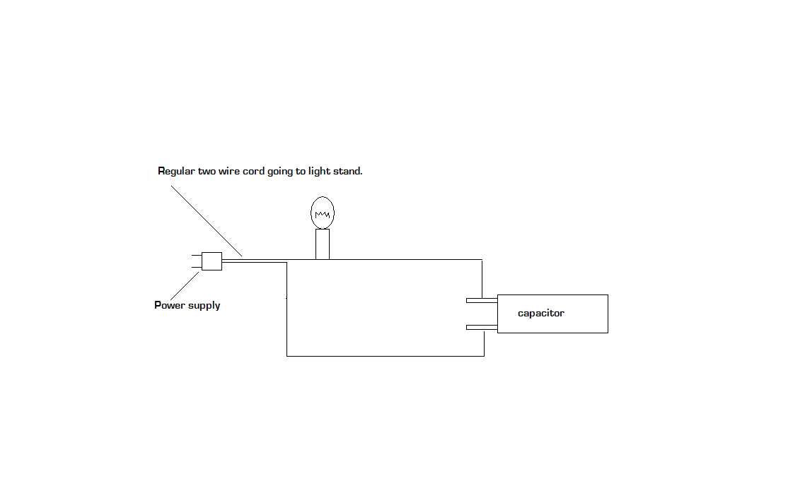

Now.  I have a multy meter any ideas to check if it is the capacitor or windings?
One more question!.. It seems to me that the stator and rotor are immersed in a thin oil maybe about 1 pint of oil why does it not short out?   Many thanks for all your help here... Anthony

The capacitor is definitely BAD. From the value it appears to be a run capacitor but it may be the reason the pump does not start properly. Replacing the capacitor should cure the heating problem. If there is a W.W. Grainger store anywhere near you they should have a replacement at a much better price than the pump maker.
As for the oil, these pumps run submerged in oil to preclude water from entering the housing. It is known as transformer oil and is dielectric (non conductive). A readily available substitute is common mineral oil sold as a laxative at most, if not all, drug stores. You will need to fill it to capacity and seal it well.
Let us know how you get on with it.

I'd also say deff the cap, it's only a baby one and should not cost more that a few dollars.
The oil is an insulator, as previously stated it makes a good coolant in many electronic devices.
You are not realistically going to be able to test the cap at home without the correct equipment, it's a relativity complicated process.
Caps are so cheap even the electronics guys just swap suspected caps rather than test them.

Been using this capacitor tester for over 20 years. Have yet to find a swollen capacitor that checked good.
Joe

There is still a bit we dont know about this problem but maybe this will help us along the way:
Get a mains light globe, put it in a socket and wire it across the capacitor (i.e. one wire from the light socket is wired to one terminal of the capacitor and the other light socket wire connected to the other capacitor).  Then try the start again.
If the motor was/is working properly the light will come on briefly as the motor gets up to speed then it will go off.  Also, provided the light bulb is good it will discharge the capacitor.
If the starting switch is not closed (as it should be when the motor is stopped)  the globe will never light, so that is useful information.
N.B. Take no chances with the capacitor and always consider it charged and lethal to the touch.

I will do this tomorrow I sent a little drawing of what I think is your idea as to do the light bulb thing.
This way I will have the pump stripped down again and I will probably tear into the bearings and such. But first I will try your idea.
Thank you   Anthony.

Anthony
That won't do anything. The lamp terminals are shorted. It won't light up!
As no-one has posted a circuit of a 'generic' single phase, capacitor start motor, I will e-mail you some info. if you want.
Can't be bothered to post pics. on P-bucket  ::)  copyright stuff anyway ..
Dave BC

I thank you for the little sketch, drawings are always the most important part of any explanation.
Now after reading again John Hills explanation I think as you look at the little crap o cad I got it wrong on what he was trying to get over. My fault not his.
I have printed out your idea and to the shop in the morning I will go give this a shot. your right this is a great chance for me to do a real time experiment with my meter.
