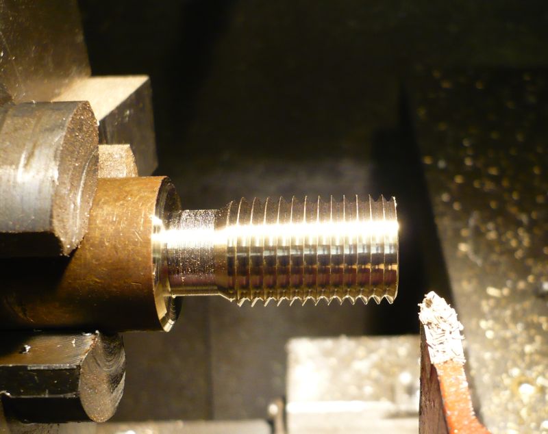

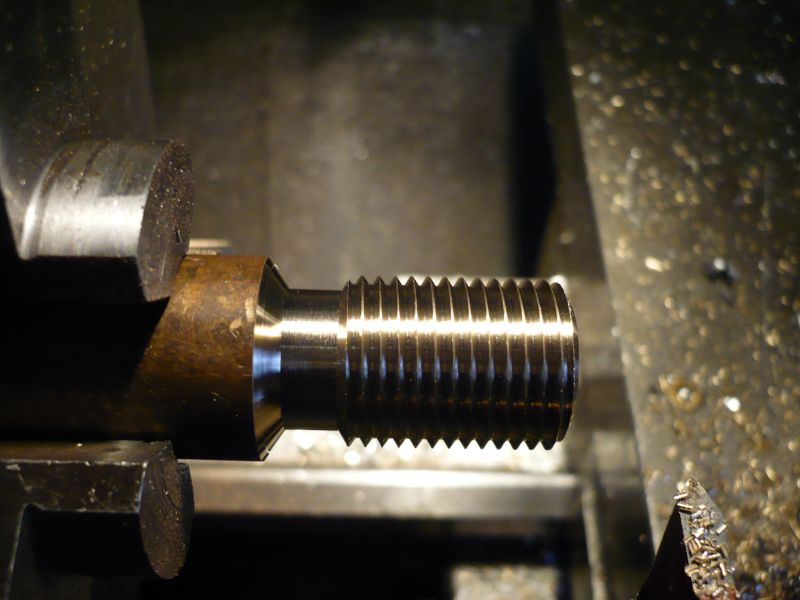

Please bear in mid the HSS threading tool is not at it's best as it needs resharpening and it's overhanging far too much. Also the swinging tool holder is set over at an angle due to the angle the HSS has been ground at. Even so it worked really well.
I will invest in a new tungsten cutter for this tool after the commercial period.
A 1.5mm pitch at 20mm dia. Not the best picture in the world, sorry. It did come out OK.
Here's a better one, 2.5mm pitch on the same bar ...
Now it's going to be hard to convey just how well this tool works and how much easier it makes cutting threads compared to the "proper" way of doing it.

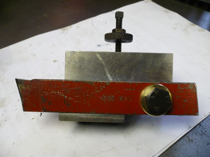

Here are some more pictures after I cleaned it up a little.
You may have noticed that I didn't use a bronze bush as Bogs did. Not being a high speed device I gathered something simpler would suffice.
Also note the front of the swinging too lholder overhangs the main body in an attempt to help keep swarf away.
You may have also noted that the keyway has stuck itself in the swinging part and not the main base section. This is not by design, that's where it chose to be  :)
I shall probably alter this with some Locktite ... :dremel:

I have been wondering just how simple this coud be made? It's all well and good doing loads of fancy shapes and over complicated engineering etc.
But what about just the tool as John has done, a flat plate with a bolt sticking out instead of the bottom ledge?
The bolt head could also act as the keyway and if the threads are bruised on the plate the bolt could be adjusted.
With no bottom ledge swarf wouldn't be an issues either, not that it seems to be anyway.

Finished thread,
John S.

Nowt wrong with that, John, judging by your result  :thumbup:. It won't do LH threads, but speaking for myself, 95% or more of those I cut are RH.
Being pedantic, there's positive rake on your tool, which will affect the thread angle, though only very slightly.

Why won't it do LH ?
The tool started life as a paring tool and I accurately marked the angles out with my trusty felt pit and took the positive rake into account when i was following the felt tip lines.
John s.

John S: Why won't it do LH ?
I was thinking that its only lateral support near the business end was on one side (the face of the fixed part), which will be fine for RH threading. But on LH threads, it will tend to be pushed to the left (from the operator's viewpoint), where the side support is from the nut and washer, a long way from the tooltip and perhaps thus subject to undue leverage. Or have I missed something (I expect I have!). Perhaps there's a tenon hidden beneath.

Excellent project Darren and I can see one of those lying in the scrap box just waiting to be discovered. :coffee:

Darren,
It's a TOS 14" swing x 40 BC and is fitted with forward and reverse clutches with a brake in neutral. You can bang it straight from forward to reverse with no problems which makes it ideal for this type of threading.
It's made to leave the 1/2 nuts enganged as reverse is 1 1/3 times faster than forward to save time going back, nice machine.
Did a LH thread tonight, same pitch, 2mm again no problems in fact it even easier as you are running away from the chuck.
Video here:-
Finished thread.
John S.
« Last Edit: December 27, 2009, 09:33:11 AM by John Stevenson »

Well I think that demonstrates it rather well, seemed to be no pulling there on the left handers  :clap:
Thanks for taking the time to do the vid  :thumbup:

Well, I can't argue with that, John :bow:. I'm happy to be proved wrong, but sorry if you've had to waste any steel in doing so. It certainly simplifies the design.

No problem and nothing wasted as I wanted to do this to use and not just as an exercise.
When threading I always leave the half nuts in and reverse the machine I find this far faster than waiting for the dial and making mistakes.
The fact you can put the next cut on whilst it's going back also saves time and because the infeed is always in the same direction you don't have to worry about backlash. For me it's a plus so any trials are just that.
I could see it being a problem for many who have machines that can't reverse easily and the screwed chuck problem is bound to raise it's head but I reckon that is overrated.
John S.
