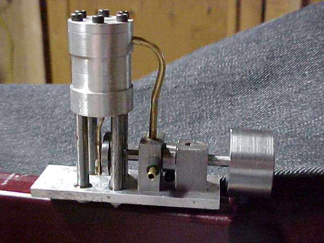

Eric here is a picture of my first River Queen Engine.  Ray

nice little engine but i have one question is the valve part of the crank shaft???

It is a rotary valve attached to the crankshaft.  It has 2 slots and rides in the block with the outlet/inlet tubes.  If that fit is not real close, you loose too much steam for it to run efficiently.  ironman

There are a few crank-valve designs around from David Kerzel - particularly his "Tube Engines".  These even include a 5-cylinder radial version.
His are all soldered together - I'd not thought of "separating" the parts as in the pic you posted.
