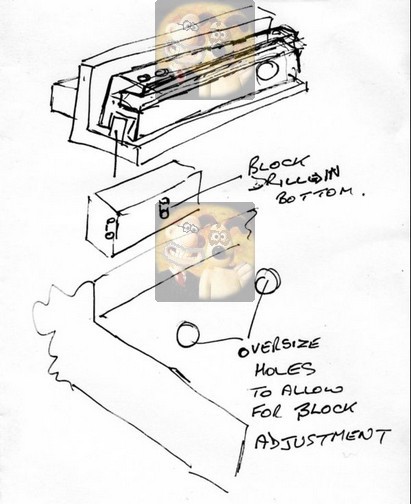

I didn't manage to get into the shop until this evening, so I rushed thru everything, then took some piccy's of what I had made.
The first thing was to get the holes drilled and tapped. I located the swing arm onto the little block and clamped it down onto the block top face, then the pivot position was drilled and threaded. The other holes were just for tool clamping screws and the height adjustment for the main block.
http://i202.photobucket.com/albums/aa102/bogstandard_photos/Swingup49.jpgSwingup external threading tool
A pair of phos bronze flanged bushes were made up and reamed 8mm. They had flange thicknesses that were in line with the gaps required and the position of the block. I also knocked up a stepped pivot bolt. I made the length so that when it was fully tightened down, the swing arm still had a few thou side to side play only at the pivot point, there was no rock at all at the cutter tip. If this play causes a problem, the bolt shoulders can easily be adjusted to snug things up a little.
http://i202.photobucket.com/albums/aa102/bogstandard_photos/Swingup50.jpgSwingup external threading tool
A bit of threaded rod and a height adjusting knob were easily knocked up.
http://i202.photobucket.com/albums/aa102/bogstandard_photos/Swingup51.jpgSwingup external threading tool
These are all the bits now assembled, and the tool completely finished. I had to fine tune the block a tiny bit as it was still a little tight, by removing a few tenths and a dab of oil on the block and pivot, the swing arm now easily rattles up and down, and no sign of side play at all. I'm very happy with the results and how well it went together.
http://i202.photobucket.com/albums/aa102/bogstandard_photos/Swingup52.jpgSwingup external threading tool
This is now set up for correct height on my machine.
http://i202.photobucket.com/albums/aa102/bogstandard_photos/Swingup53.jpgSwingup external threading tool
I just didn't have time tonight to get a trial done, and from very early tomorrow morning, I have personal things to do that will leave me incapacitated for a couple of days, so I am sorry, you will have to wait a little longer. I would like to do a vid of the results if they are satisfactory, unfortunately I don't have a camera mount for my machinery yet (another tuit), so you will have to take my word for it.
Bogs.
