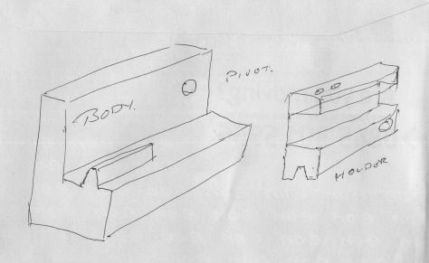

Just a warning, I have nothing down on paper for this one, as I am designing and making as I go along, so please don't ask for sketches just yet. I will be showing how it progresses gradually from raw materials to hopefully a fully operational bit of tooling, warts and all.
I make no excuses about using the tooling I have, at times like this, I use whatever is available to me. If you ain't got it, you ain't got it, full stop, no arguments.
So belt and braces on, hitch up your pants, away we go.

I have thought ahead a bit on this part, and almost any shape or size of threading tooling can be used with a slight mod. More on that later.
The next bit was a toolholder for me to copy from, and a lump of cast steel that was originally cut up for making the retracting toolpost out of. The square is there just for checking things out with. I have a set of engineers squares specifically for bench only use, and others that are used around the machines, they are so cheap, it pays to do this sort of thing, a 'best' set, and general working ones.
