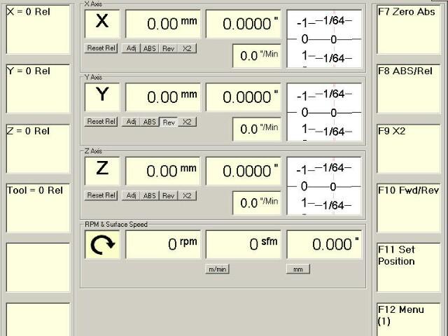

DRO..... PC based
« on: November 23, 2009, 09:57:54 AM »
Is this neat, or junk?
Does anyone understand it?
http://www.msh-tools.com/DRO/overview.html

Hi Darren, Not seen that system before :scratch:. I use the Shumatech Dro on my small mill, It works very well with chinese scales.  http://www.shumatech.com/
Rob :thumbup:

They both look worth looking into! Suppose the only difference is you're getting 1 display which can be put in a convenient place with a bit more functionality through the computer / control box.
Nick

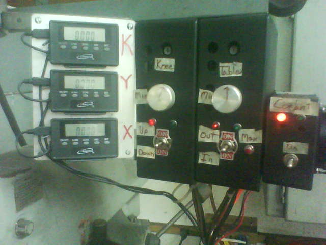

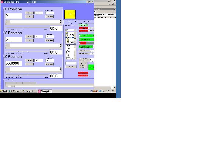

Offline Dawai
  • Posts: 124
Re: DRO..... PC based
« Reply #22 on: December 17, 2013, 09:37:59 PM »
IF you are going to use a old pc?? what do you need all that other stuff for?? this vb6 program I wrote in 2005 can read with a quadrature encoder (glass scales) or a serial digital caliper..
  IF you want to go "blue tooth" and readout on a android bases tablet? I suggest purchasing the $60?? arduino mega 2560 I bought today, has a RN42 bluetooth module socket, and there is communication software on the net, and encoder reading software, and serial software.. and..
At one time, this vb6 software also ran power feed to "point" selected.. no clue which version this is thou. My software is in disarray.. too many pc crashes.
(HOW it works, you can find the communication subroutine with the chinese scales and perhaps adapt it's logic to your arduino) THE forum didn't want me to post the whole program for you.. if you want it, code or compiled and running under windows? lemme know..
Private Sub Read_X_scale()
 Dim a$
 MSComm1.PortOpen = True ' open the port using MSCOMM
   a$ = MSComm1.Input
 If a$ <> "" Then
 X_pos = Val(a$) / 25.4
 'ProgressBar1.Value = Val(a$)
 End If
 MSComm1.PortOpen = False ' close the port using MSCOMM
End Sub

I can write you a "altered" version of my "cheapass DRO" that runs in windows visual basic. INstead of reading the chinese scales through multiple ports, it could read the arduino and let it do the work.
No big deal, ten to fifteen minutes to alter it.. will take me a lot longer to remember what files you need on your machine to run it.. vbrun.exe??? I can't remember.. (hit on the head too many times??)
I had a version that was "power to" a point using a power feed... Not sure where that one went.  Not a true cnc, but a slotter or face off system.. no interpolation between axis (cutting circles or angles)

I got it talking to the Arduino "code unchanged".
I'll make the "power feed" boxes invisible.. and clean some up, then hunt a place to post it to share with anyone that wants it..  Perhaps the Yahoo CheapAssDro forum I started, now can't get back into?? Ha.. getting old sucks.
(got a migraine, off right now to watch some tele and pet the dog)

  This visual basic one is working pretty good, I am using mscomm, so it is simple, Sorting the data, I use the X,Y,Z to identify Beginning, and the ";" to note end of transmission for each axis.  No Chr(13)'s so no end of line (constant stream), I am pulling a byte at a time in the mscomm setup. Of course you know all that thou.
The Chinese scales used a transmission setup of 48 input length. I'd pull words direct from the port then convert binary to decimal.  About ten minutes in change, then I gutted the program removing the motion portion.
  It needs some additional things like a averaging routine to stop jitter. A rpm pickoff added to the arduino, the polar holes program popped into it.  We are having a snow day here today, so I might get to work on it some. I was "hacked" yesterday.. someone trying to get to my surveillance system or this  old junky computer I code on.  Normally when that happens, I pull the hose.
  YURI, Hang in there, your software is helping others. When I get this vb version cobbled together you are welcome to, and asked to post it for others.. (under free share, no warranty, no customer service)
 NOTE, if you "stream" from the arduino in the same format, X##.#;Y#.##;Z###;  you can read quadrature encoders, ten turn pots, Sonar (sf04) or any other instrument you wanted to display on a tablet.. Yuri's touchdro app software would work with no android programming required.
