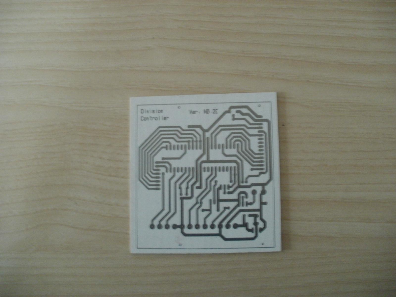

« Reply #57 on: January 15, 2012, 05:04:15 PM »
Hi Chuck, Sorry for the late reply!!!
Yes, Lucas:
http://www.cnczone.com/forums/893705-post346.html
It is much easier to etch and much more forgiving. That being said, I have now improved my method of etching and can do Steve`s original pcb which requires much less time to etch! Here is Lucas pcb being etching:

Re: 4" Vertex Rotary Table CNC conversion
« Reply #58 on: January 15, 2012, 10:53:22 PM »
Looks like you're getting the hang of that etching, Chris!

« Reply #59 on: January 16, 2012, 01:19:02 PM »
Cheers Sparky, yes I`m getting there for sure! I just wanted to show people the other pcb as much as my etching skills lol, or lack of them!!

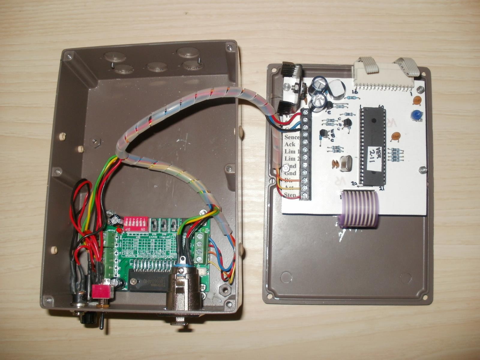

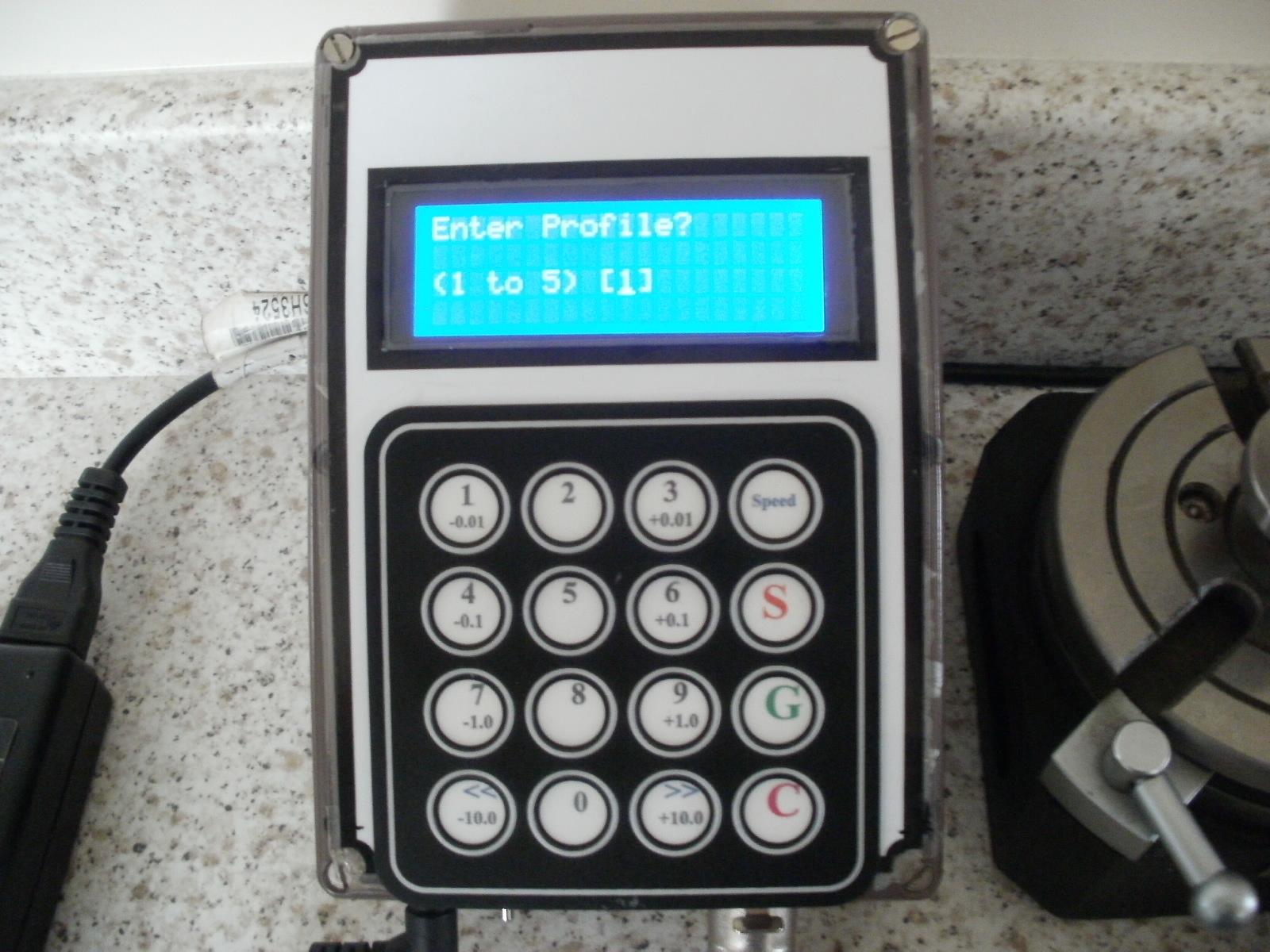

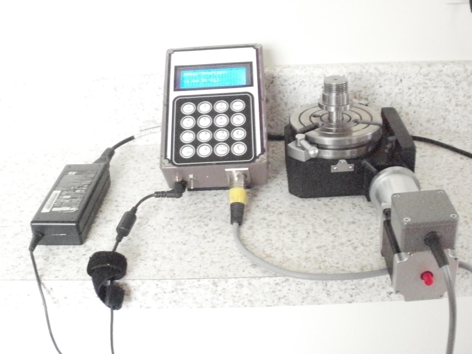

I've been following Kwackers  build on CNCzone from the beginning with great interest, and after seeing Craynerd's build on here I took the plunge to build one.I've never etched a PCB before but using the OHP film method I produced a very good board at the first attempt ( just lucky?? I etched a second PCB  to just see, & this one was as good) The rotary table had allready been fitted with a stepper motor for use with MACH 3 on my CNC emco mill. But this controller is so use full as a stand alone divider.
 Thanks to Steve & Chris for sharing this great device.
note: keypad is not fixed down yet

« Reply #63 on: February 18, 2012, 06:30:38 AM »
John, Which driver board is that please ?

« Reply #64 on: February 18, 2012, 07:12:09 AM »
John s.
It was  off ebay from Hong Kong (no surprise there !!)
http://cgi.ebay.co.uk/ws/eBayISAPI.dll?ViewItem&item=250990148810

Thanks, next question where is the case from please ?

« Reply #66 on: February 18, 2012, 09:16:11 AM »
John s.
The one I used was from out of my loft !!
Its from RS  external Dims are 170mm x 118mm x 55mm, diecast aluminuim with lid.
Every thing just fits in. I cut an aperture in the back for the stepper driver to be fitted from the rear with the heat sink outside the box. When the keypad is fixed in its correct position the bottom edge is approx 6mm from the edge of the box.
How do you find that driver?
Looks ideal for this sort of use.

Offline kwackers
  • Posts: 356
« Reply #71 on: February 18, 2012, 04:42:20 PM »
Kwackers.
I only completed the controller on Thursday so have not really used it. But the driver appears to rotate the table with no loss of steps & high torque. As I think you said early on speed is not really important for this application. I'm not sure if it would lock/hold the table whilst milling. Did I read some where that shorting the two limit lines locks the table?
PS How do I insert a quote in the reply?
you can insert quotes automatically by clicking on "quote" on the top right (in my view anyway) of each post. Alternatively there's a quote icon in the editing toolbar (again in my version).
It looks to be rated at 3.5A which will drive most common steppers quite happily. Generally the table will lock by virtue of the worm drive even without the motor powered. The only movement should be in the backlash (which is why you probably want to use a physical lock).
Connecting the two limit switches together and toggling them doesn't lock the table but it does lock the controller to stop inadvertent key presses.

I've ordered one anyway - worth a punt at that price I think...
« Reply #73 on: February 18, 2012, 05:11:03 PM »
If this the same TB6560 that is in the common 3 and 4 axis controllers, despite their rating they are apparently not suitable for even half that, likewise the voltage is rated 35v with 40max, apparently the chips blow easily if taken above 26v!! If you google TB6560 you will find the links to what I`m talking about.
I`ve got one of the TB6560 3 axis drivers in front of me now so I`ve been reading a lot about them over the last few evenings...before I plug this one in and  :zap:   Perhaps these single drivers will behave differently. Apparently, the issue on a high voltage is during power OFF...but of course you only get the "pop" of the blown driver when you just turn it back on.
Let me know how this driver goes, I`m keen to know as I`m making a few of these up and expect people would like them with a driver or at least recommendations for one.

« Reply #74 on: February 18, 2012, 05:34:23 PM »
Chris you are right, i would not recommend them above 24v (typical supply voltage). Above that is asking for trouble, had first hand experience with that.
