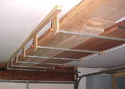

Wesley, my workshop is an absolute disgrace but I have had a few good ideas over the years!
I found the surplus office furniture warehouses are a good place to look.  Old map cabinets, the kind with big shallow drawers, are ideal for storing small tools and instruments. Filing cabinets are cheap because there is little use for them but all they need is a plywood box made to fit inside and they are ideal for storing power tools etc.  Banks used to have shallow drawer cabinets in which they stored checque books etc, steel and highest quality construction and if you can find one ideal to have under the bench where I use one for spanners, screwdrivers, hammers, hacksaws etc.
I think the secret for workshop drawers and bins is that they must be shallow so that whatever is in there is all on show when you pull the drawer out.
My best purchase ever was a 120 drawer card index cabinet (the library used to have dozens of these and I managed to get one).  They are ideal for nails, nuts and bolts, and all manner of useful bits.
bogstandard

If you want to use the walls you can triple, or more, the area by making things like 'doors' on hinges set out from the wall a couple of inches.  Then you can hang tools on the wall plus both sides of the 'door' contraption.

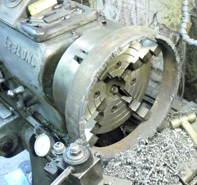

I've been out in the shop. I managed to get a couple tool holder racks made. Those pins seemed to take forever. I rounded one end and champhered the other end and emeried the rust off of them. The wood is recycled flooring. I haven't decided if I'm going to paint them or not? If I do, I'll wait till they are all done.
I bought one of those throatless shears from HF a year or two ago. I've used it a bit, but not much. The main reason is There's no where to mount it in my shop. When I was building the steady rest for my metal spinning adventures, I thought it would be handy to mount it the same way. The lathe is nice and heavy. It makes a good base for the shear. Now I can cut out circles for my metal spinning\o/

Is that a magnet levitating the dti ?
Nice going there, tough looking lathe too .... and almost enough swarf to start weighing it in .....  :lol:
Re: "Sorry about the explosion"
« Reply #18 on: November 28, 2009, 03:47:06 PM »
Mmmmmmm, just wondering what kind of stress that will put on the ways of the lathe. Will it twist the bed ways out or not? Just wondering out loud.
« Reply #19 on: November 28, 2009, 04:06:30 PM »
Interesting use of a lathe... not a bad idea either. Bernd's post made me think "hmm"; I'd add a leg underneath the shear, so when you pull down on the handle all of the forces are transmitted through the leg to the floor, the lathe is only there as a steady then.

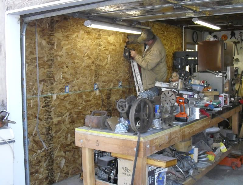

Every night last week I put in 2 or three hours into my shop cleaning. What a mess!!! I managed to get a lot put away. One problem when you clean is all the stuff in the area you were cleaning needs to go somewhere. It's still pretty messy.  I have mainly been focusing on my work bench. I have some things planned that will save a lot of space.
This summer I bought a old "post drill" and a bench grinder. Both are set up to be run with leather belts. So, I needed to finish up a couple things before I could install them. The wall behind my bench wasn't finished. It had insulation, but no boards on it. Today I got up and moved my bench away from the wall. I went and got the stuff I needed and a buddy came over and helped put OSB on that wall\0/ It took most of the day. Tomorrow morning, I'm going to paint it white. Then I'll be able to slide the bench back against the wall.
My wife helped me a bunch today. She cut out all the pieces for some fancy storage bins I've been wanting to build. I had a bunch of reclaimed wood that we used. They will roll under my bench and hold all my scrap and some other stuff. I'll get some pictures when we get everything into place. They might be handy for others here to use.

I got the bench back up against the wall today after the paint dried. I then finished my storage bins. There are 5 of them to hold my scrap metal. They have big wood rollers so they roll pretty good.
Nice and neat and out of the way.
