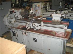

Hey what do u know.  Found a foto of a unit that is fairly close to what I was looking at.  A few small differences like theres only one gear shift lever in the foto, verses 2 on the other.
Recon this one is the bigger brother as it has 360mm Swing x 1000mm Between Centres
The foto one has 2 MT... doh forgot to check that bit out
32mm Spindle Bore.  59-1220 RPM.

Looking at the photo you show it looks very like a Chinese copy of a Harrison Lathe possibly the 140 or L5
It might be worth looking at the site to compare
http://www.lathes.co.uk/harrison/page12.html
