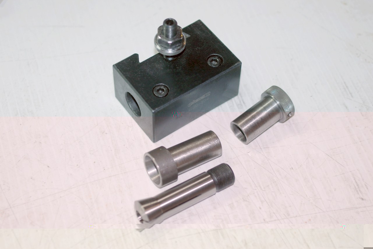

That is a bit of a long introduction to a pleasant afternoon spent in the workshop. One of my interests and what drives me as to what I machine is my interest in small model glow, ignition and diesel engines. A recent project has given me the need to make several duplicate parts with the requisite desire to make them all the same size. I have a 5C collet chuck for my lathe and though what better way to start making these parts than to use the 5C chuck but if only I had way of indexing the parts so that I could make them all the same size? A collet stop is the answer of course, a stop for the 3 jaw chuck would work too. So, my pleasant afternoon project was to make a 5C collet stop.
The first picture shows the result, the holder which screws into the back side of the 5c collets and two rods that are used to set stop location. A grand total of about four hours of work - one hour of actual machining and three hours of putzing, fussing over details and setting up. All pieces are made of 12L14 or maybe 1018 steel, all came from the scrap bin. I didn't make any drawings, I just measured as I went and machined off any bits that didn't belong to the finished piece. The dark finish of the holder may be of interest. It was done by nothing more fancy than just heating the piece with a Turbo Torch and quenching in oil - I heat the piece for a couple of minutes, quench, immediately heat for several more minutes, quench, immediately heat until a dull red, then quench and let cool in the oil. I do this to almost any project I make of 12L14 or 1018 and it gives a good serviceable dark blue/black finish. The oil I use is a quart of synthetic 2 cycle (Amsoil something or other) - I don't know if the oil being synthetic is advantageous to the fairly dark colour I get or not but I have been using the same quart for quite some time, the results are repeatable and if ever I feel the need to replace the oil I will replace it with the same thing - no need to fix something that isn't broken)

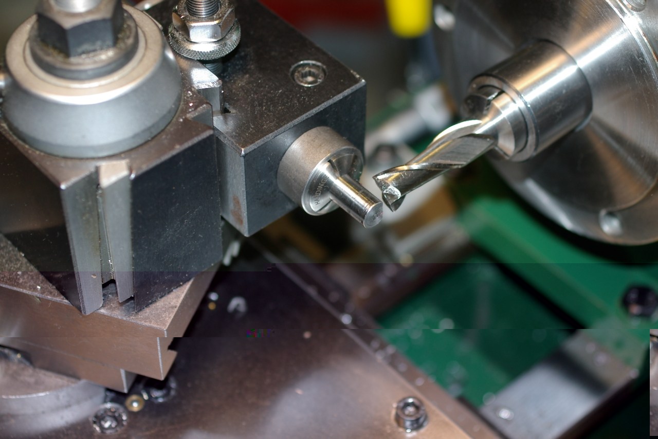

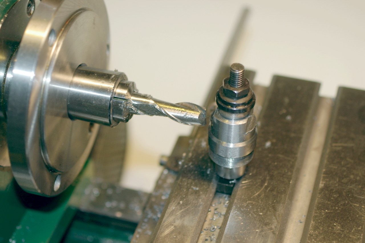

The second picture shows how machine the flat onto the stop bar using a holder in my AXA size QCTP. The rod is held in a 3C collet that is held in the standard AXA size boring bar holder. The photo actually shows the milling of a flat on a much shorter piece of rod. The third picture shows the boring bar holder, a 3C collet and the two pieces needed to hold and tighten the collet. The collet holder pieces are made of 12L14 or 1018, again pieces from the scrape bin. Why I haven't blued/blackened them yet I don't know - maybe one evening this week for something to do.

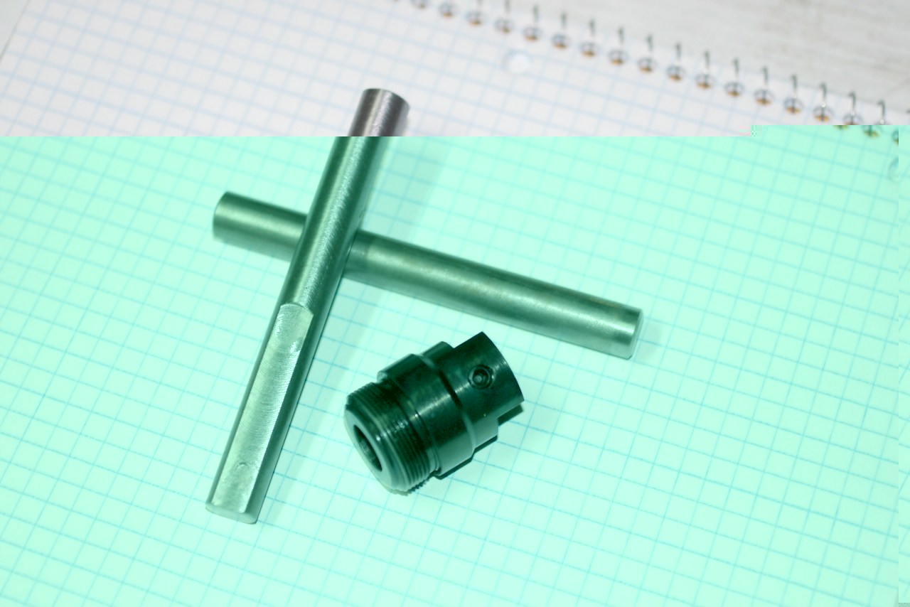

The last picture shows how I machined the flats on the holder to use with a wrench for loosening the holder from a 5C collet.

I would just like to give you a little warning about your collet backstop. Do not rely on it to give accurate repeatability. The way those type work, is dependent on how tight you tighten up your collet, I always use a marker on the chuck so that I turn the handle on the chuck key to the same mark.
The only way to get true repeatability is to use a spindle mounted backstop. Very easy to make, and while you are in the making mood ............
