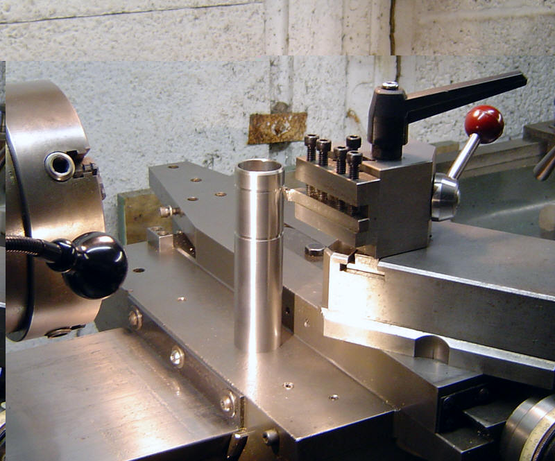

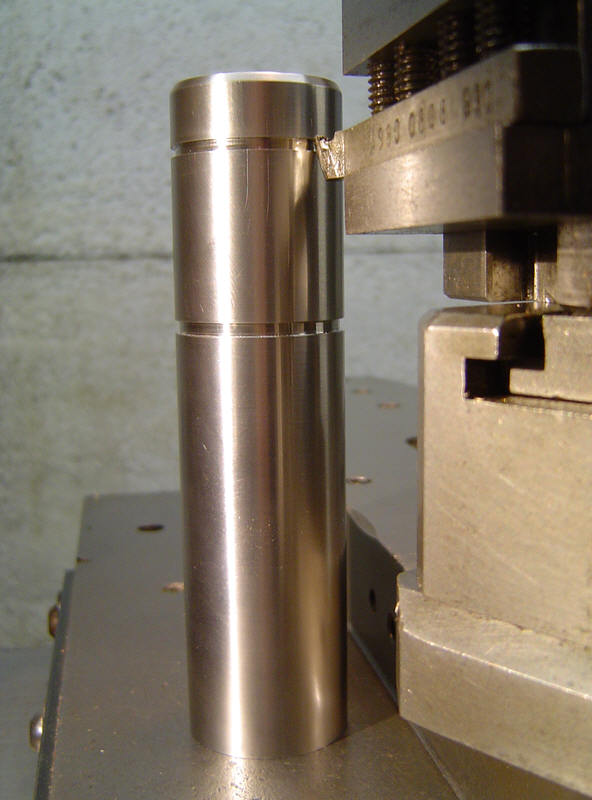

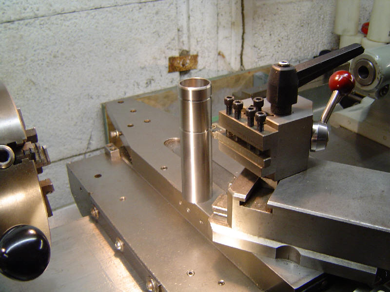

Grab youself a bit of old steel tube.
Mount it up in the lathe and clean up the outside for whatever length you want, I made mine about 3" long.
Very gently, lock up your saddle, and carefully face the end.
Deburr the inside and very gently remove the outer sharp edge with a bit of emery cloth or W&D.
Part off the bit.
Turn the new part around and lightly grip it in your chuck, gently face the end and give it a good clean up. I put a large outside chamfer on it, to save this end being confused with the other, which is the working end.
You have just made yourself a perfect tube square that can be used almost anywhere a normal cheapo Chinese square can be used. They are very good for setting things upright in your vice jaws because they can be wider than a normal engineers square, and don't want to fall down into the gap.
Make up various lengths and diameters, you will find a use for them all, eventually.
Bogs

Taking the idea of the cylindrical square one step further scribe a line on the cylinder at lathe centre height to form a handy tool cutter guide. Two tools for the price of none.
John-Som
Brilliant Idea John-Som   :D :mmr:
I've cut a couple of grooves in mine one for height above the apron the other for height above the cross-slide.
