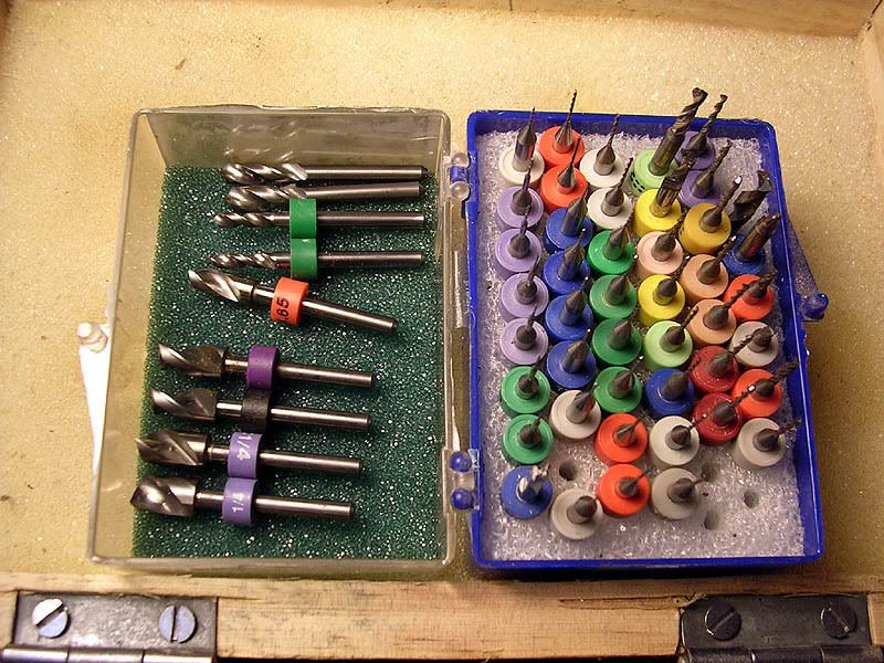

There's been quite a few similar mods posted here & there so yesterday I jumped on the bandwagon and converted my tailstock to digital depth display.
I picked up a 4" Chinese caliper on sale at HF and proceeded to hack it to bits with a dremel cutoff  wheel and drilled some mount holes.  I dreaded the drilling because of the hard stainless steel but carbide circuit board drills whizzed through it like butter!
My tailstock quill rotates a bit so I made the slide to quill connection with a shortened pair of r/c helicopter ball links screwed together with a bit of 2-56 threaded rod.  It's a slack-free connection and assures no-bind operation.  It works so well I wish I'd done it much sooner!

The metal of the Caliper is a bitch to drill (opps, language!).
how was is done here?
Johannes

I used a couple of drills from this set I bought a long time ago.  I think they're surplus carbide (overstock) GF circuit board drills.  They were unbelievably cheep.
I cranked up the mill to its highest speed, (2000 rpm) put a drop of cutting oil on and peck-drilled straight through, easy-peasy.
