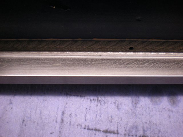

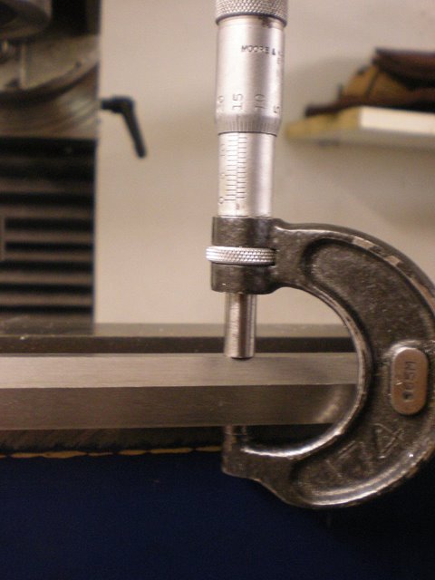

The story so far, after reading Bogs' superb thread about fixing Darren’s lathe I decided to have a go at doing the same to my trusty 7x12, I'm coming to realise that perhaps I have been a little too ambitious so this could all end in tears.
My lathe had a taper of .24mm end to end when measured between the top and bottom of the ways (where the Gib strips run) but having spent a fretful afternoon skimming them  down to .07mm taper over  the length of the bed. Actually not the full length as I didn't skim the area below the head stock.
I didn’t take any pics of the set up but here is something that shows how small my mill is compared to the casting.
These 2 pics are taken about 10" apart
Not too bad?
This is the machined area after a little dressing with some 800 wet+dry paper soaked in oil wrapped around a piece of square bar (thanks for the tip John), The small machining marks are hardly visible to the naked eye but the camera seems to exaggerate them.
I hope to get a bit more done tonight, perhaps squaring up some stock to make the new carriers or maybe I’ll just take a deep breath and relax for the evening and make sure I know what I am doing next.

Thats a great bit of work David I think you,v made a good lathe even better.

Nice to have you around mate and nice work, that's a pretty tight tolerance, well done  :thumbup:

If you wanted to get the lathe bed any better I would suggest lapping it in, by running the carriage up and down the bed mainly concentrating on the high part with some lapping past between the gib and the bed. Most blokes that have the older IH mills do it to clean up the ways and to bed them in.
Davo
Davo
Thanks Davo, will give that a try  :clap:
