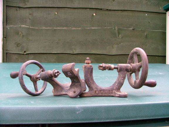

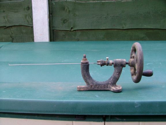

Re: Thread rolling device
« Reply #3 on: October 20, 2009, 04:30:40 AM »
I have no idea how a thread is rolled, but imagine a very big machine is used
Not really true Darren.
I bought some old castings off a car boot for a squid.
They turned out to be thread rollers for putting the thread on the end of bicycle spokes.
I tried offering them FOC to a museum, but they refuse to take them because they said they had enough examples, so one day they will be turned into something else.

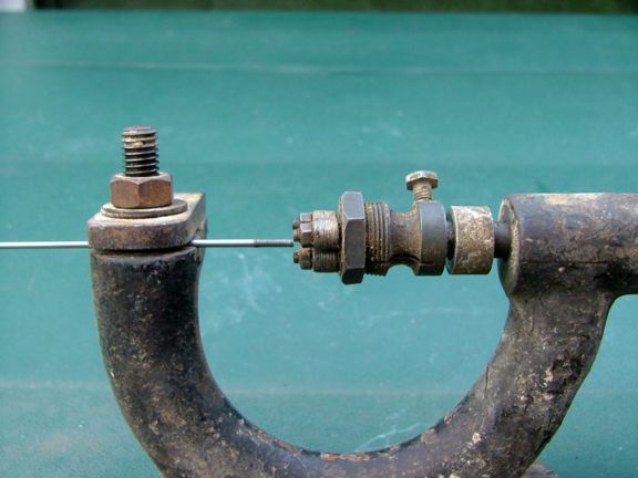

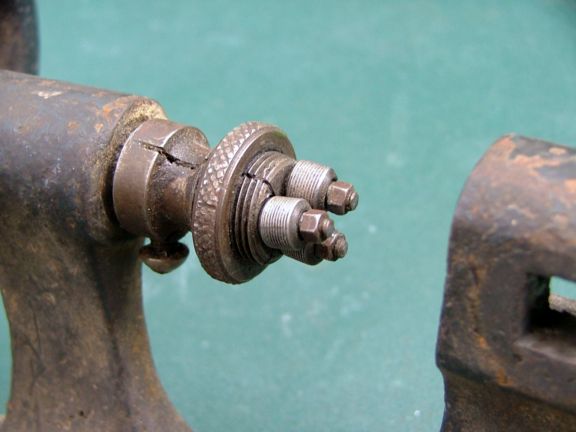

bogstandard
« Reply #6 on: October 20, 2009, 06:12:54 AM »
Ksor,
You have to remember that the ones I have shown most probably came from the early part of the 20th century and made down to a price.
When you have finished rolling, you wind it back off again.
But as you can see from the pics, it does have a crude tightening device that works by a tapered thread having a threaded hand feed nut on it, so I suppose it could cater for varying sizes of spokes and also put pressure on over several runs to form the thread, the same sort of thing you do with a die.
I don't know whether it is intentional, but the rollers are loose on their angled spindles, in all directions, but the spindles don't look to be worn. Maybe it is to allow the rollers to settle into their own rolling pattern.
I would have tried them out, but I don't have any soft iron spokes, only the modern day stainless ones, which I think would be too hard a material to try to roll threads onto. Threads on modern day spokes are cut I think, not rolled.
You can gain a lot of information by just looking at pictures such as these. With a little speculation you can imagine what was going through the designers mind when he was faced with the problem in the first place.
It is your turn now.
Bogs
