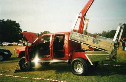

I see the video above the wheel is going too slow 600rpm and he's loading it up with too much compound. Here is a good site for newcomers to polishing.
http://www.caswellplating.com/buffs/buffman.htm
I don't mind small thing but the truck gets monotonous.
