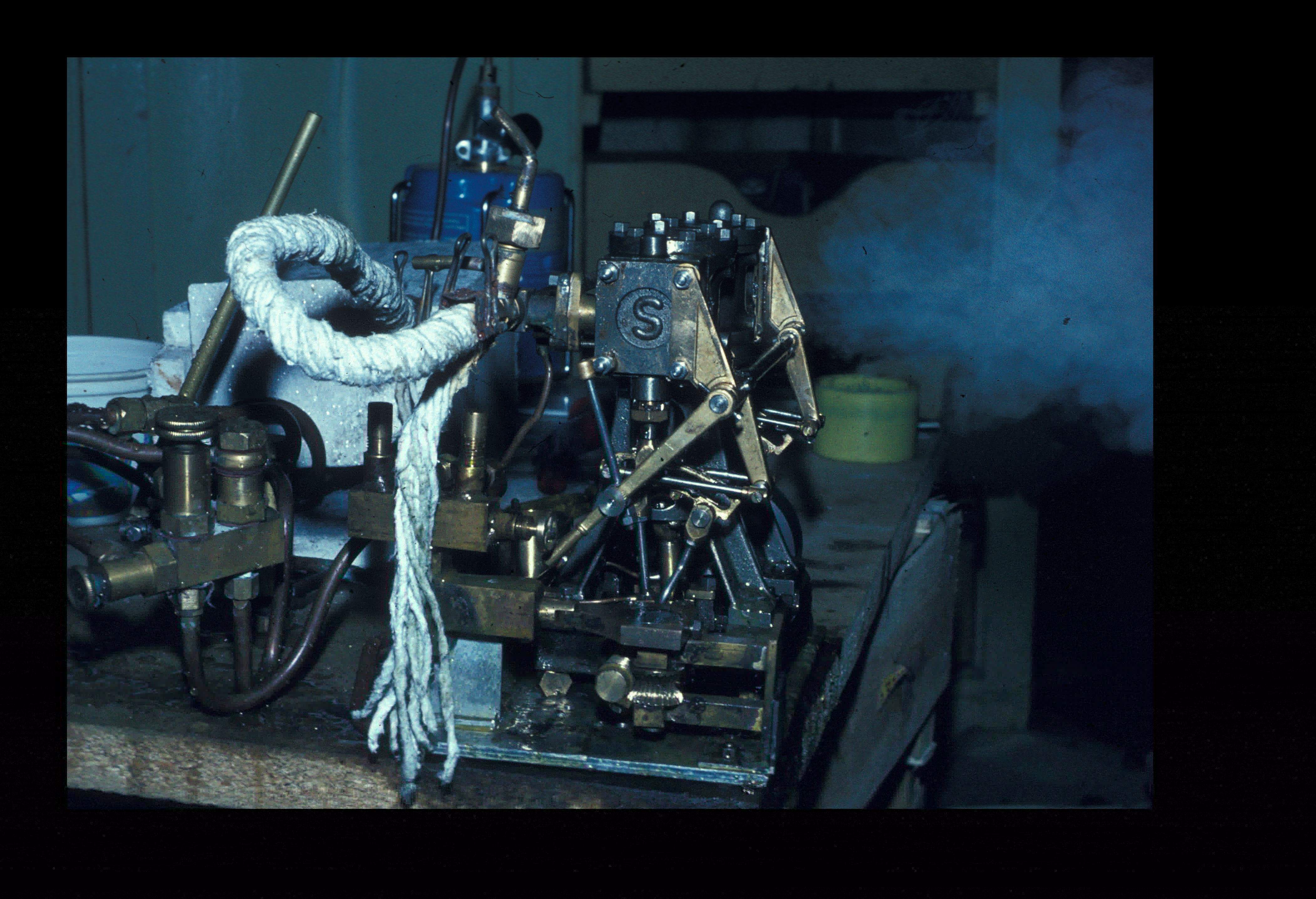

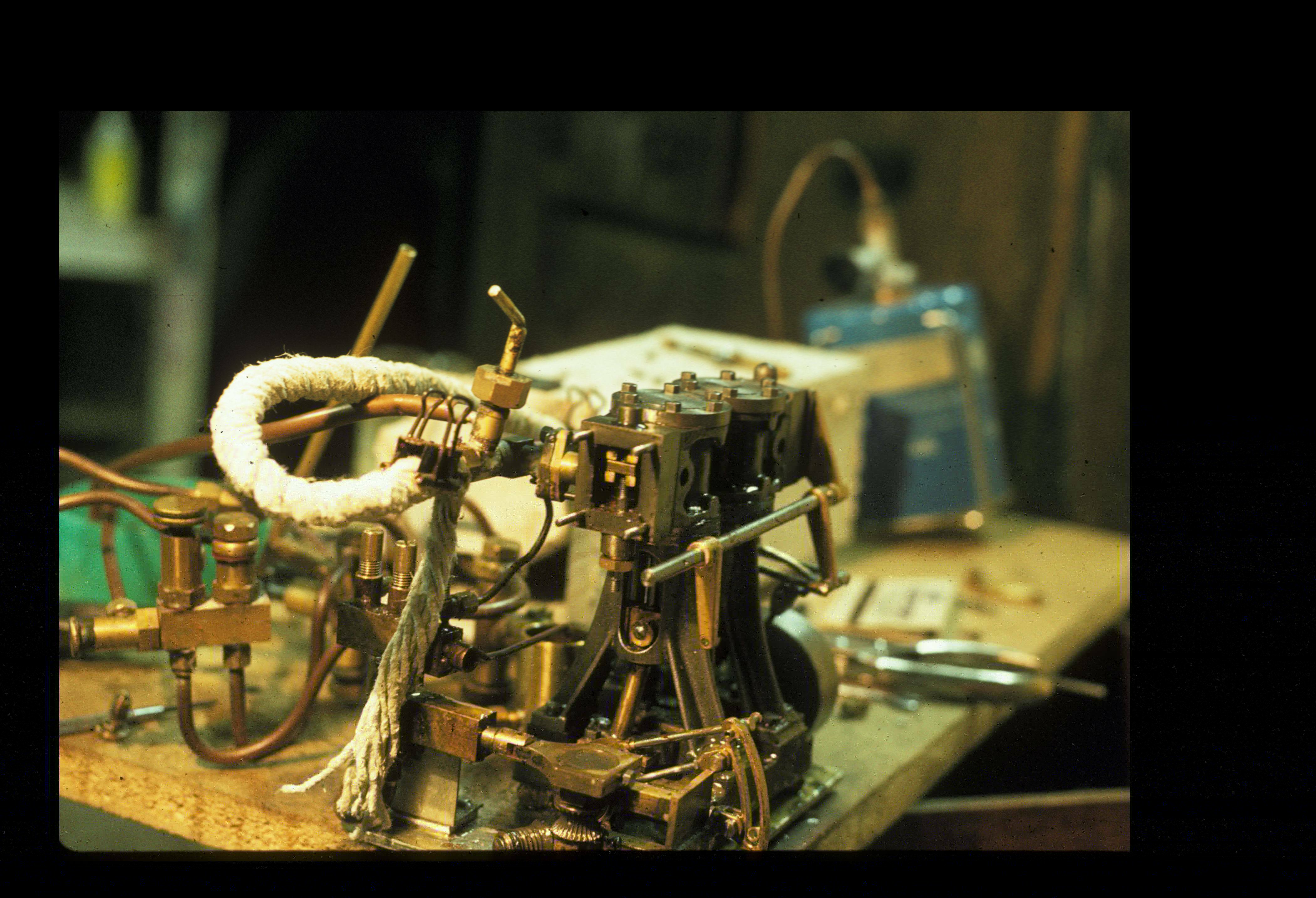

Last May my experimental model boat "Vital Byte" had its maiden voyage after two and a half years of flash steam boiler development. I started off, like yourself,  with only the knowledge that flash steam boilers existed.
I was aiming to develop an alternative to the conventional boiler to power an ordinary model boat and not the straight runners or the ultra high speed tethered variety.
The project has been very successful with the boat steaming in excess of forty minutes with the extremely rare capability for a flash steam vessel of variable speed and forward/reverse motion.
I have gradually increased the length of the copper pipe from 5 metres of 1/4inch to 15 metres of 3/8inch with corresponding increase in performance. The boiler supplies steam to a very hungry Stuart D10 engine.
The only downside, for the purists amoungst us, is the use of electric feed water pumps and a computer control system!
I'm using gas firing with a consumption of 4grams/minute.
Like in your diagram, I have used a preheater (economiser) in the boiler outlet, which preheats the water to around 70degC.
If I can be of any help let me know

No, I've not tried stainless. I've been hand winding soft coiled copper tube onto various sizes of plastic pipe formers from 33mm diameter upwards, which for the 15 metre coil, took under two hours to wind including a silver soldered joint and end fittings. How tough would the stainless be to bend and is it cheaper than copper?
The pressures and temperatures that the boiler is running at are those of a conventional model boiler, i.e. 60psi (normally 30psi) and 150degC (including superheat). I have heard of those engines that run at an unbelievable 1500degC!
You can appreciate the advantages of a flash boiler construction wise - low skill, very fast construction, low cost of materials. I can get the engine running within a couple of minutes of fuel ignition, unlike some silmilar sized conventional plant which require a cylinder of gas just to get up to pressure and takes 30minutes.
At other model clubs, I do sometimes have a few minutes discussion convincing them that I have no need for insurance or test certificates and, to that end always carry a copy of the MPBA steam rules which always helps.
I've got to the point now where I consider my boiler is normal and the conventional boilers - well, boring.
I forgot to say that the boat has a displacement of 72lbs, has a 5inch prop and the hull dynamics of a brick!
Ian.

I am pleased to see that someone else is getting into flash steam - when I built my Stuart D10, the intention was to put it into a model boat (a steam Gunboat of the Grey Goose class) and power it all by flash steam. I took all of my lessons from Benson's Experimental Flash Steam whichj has recently been reprinted I think, along with KN Harris' model boilers and boilermaking.
The intention (~25 years ago) was to do what FlashTwo has done - computer controlled using a gas powered burner. The reality was that I managed to get to an initial stage where the engine could be run using ~25 feet of 3/16 copper tube and a modified Camping Gaz blowlamp and supplied by an engine driven feedpump.
Anyway, I built the entire system up on a piece of chipboard where it still resides...It ran, mostly in fits and starts primarily because I never managed to regulate the engine driven feedpump. I would start the burner and get everything nice and hot and pump the hand pump a few times at which point the engine would gush a bit of water and then take off at mach2 (well, probably around 1000rpm or so) followed by the feedpump supplying too much water which stopped the flash part which stopped the engine, which then waited until the water in the tube heated back up to wet steam followed by......
For input to others, my feedpumps (engine driven and hand for starting the system) were both simply piston types using PB balls for valves. My guess is that they won't exceed 100psi and they certainly managed to operate under all of the conditions for pumping.
The burner came from a simple blowlamp that I converted by adding an extension to allow it to be used at floor level where it is directed into the double coiul of tubing.
The engine feedpump was driven by a worm and wheel cut using a tap as the hob - this then drove an ecentric that drove the pump. All a little Heath-Robinson but I was really trying out techniques at the time and it really fitted with the Unimat3 that I was using.
The Stuart D10 had no changes on the steam side - although since I had 3 months at a tech college when I was building it, the cast iron bits were all finished on a surface grinder!
The crankshaft bent swiftly after I started to machine it so that was replaced by a fabricated and silver soldered one. The main bearings have a pressure oil feed using 1/16thOD tube feed and a pump driven from the engine with a bypass needle valve - 'probably' overkill...
I have to say that I loved the use of flash steam, no hassle building boilers, just fun making pumps and valves and trying to make it all function together.
If there is any positive feedback, I will find some of my photos.
Regards,
Simon
Everything else was taken from the 2 books mentioned, adjusted to suit the situation.

OK Guys, here are some shots. Taken a long time ago and then scanned from the original slides so the quality is less than perfect.
About to head off on vacation so I will try and do something else when I return.
Regards,
Simon

« Reply #25 on: June 12, 2010, 07:20:39 AM »
Hmmm....photo upload problems. Two more posts with a photo each!
Simon
