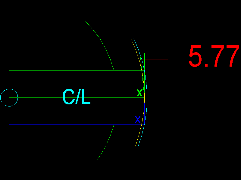

Re: Dovetail Cutter...Failed...
« Reply #15 on: September 27, 2009, 06:53:09 AM »
Below is a drawing of an insert laid out in two positions.
The green insert has its leading edge [ green X ] on the centre line, it trailing edge can be seen to be greater that the swept yellow circle of the leading edge.
now if the insert is placed so it's seating is on the centre line as in the blue insert the trailing edge with always have clearance over the leading edge [ blue X ]
John S.

Thank you for taking the time to show that John. So my biggest mistake (apart from the insert being too large in the first place) was positioning relative to the centre line then.
« Reply #17 on: September 27, 2009, 07:08:02 AM »
No problem darren, it's a common mistake and the drawing has been on the computer for a while, it's alos been posted on a few forums, as i say it's a common mistake.
