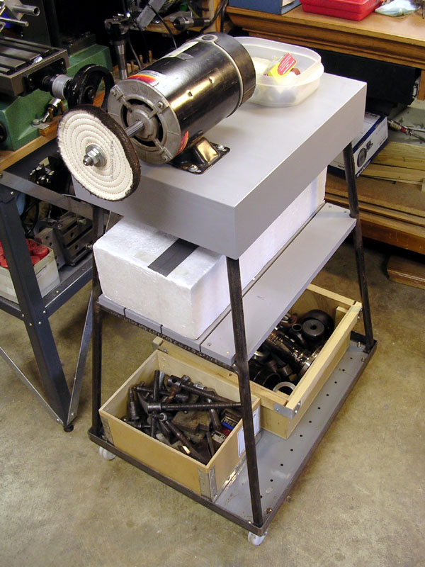

Plan B: I had recently repaired a 1 hp. 3450 rpm pool pump motor given to me by a workmate and grafted on a shaft extension to mount buffing wheels.  I fabbed the cart pictured below which holds the rock and also made a wooden "cap" to mount the buffer.  The cap was made so that it sits down on the angle iron frame and doesn't fret the top of the rock when the buffer's running.

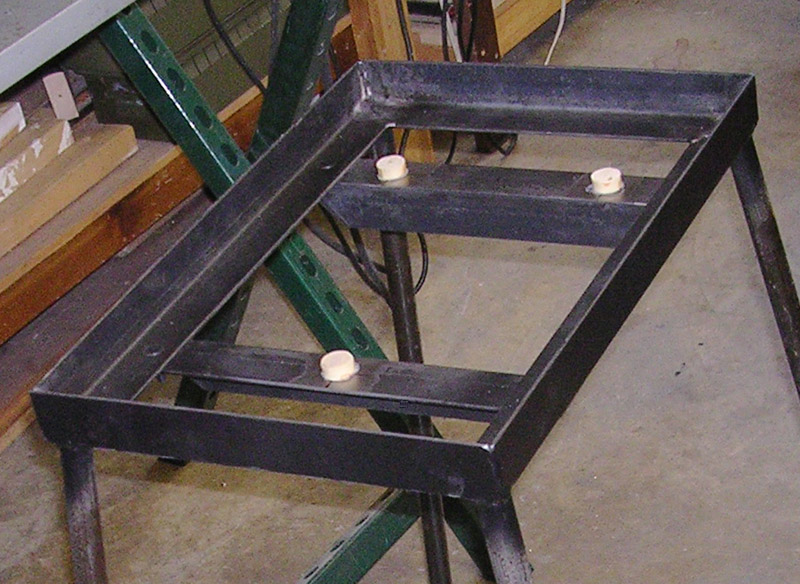

The 1st pic shows the mounting system for the rock.  Amazing what you learn on the net.  I had previously never heard of the term "airy points" but research showed this is the proper way to mount a precision measuring surface.  It's a simple bit of math: 3 mounting points with the spacing at 5/9 of the width & length.  The mounting points were made from 3 slices off a Yellowtail Merlot synthetic cork.  It took quite a bit of, ahem, "research" to free up a cork for its noble mission.  Super glue bonds to the stuff tenaciously!  I can see it being a great material to make cheap lord-style mounts for little engines.

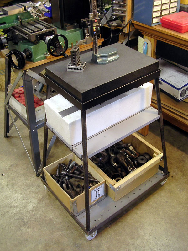

2nd pic show the results of the other thing I learned on the net during this project: the "chopsaw method" of tube joining.  I was able to fit the upper shelf braces amazingly well using it.  The cart frame is constructed from arc-welded 1/2" schedule 40 plumbing pipe (it's what I had in the scrap pile) and followed the angles set forth by the angles listed for 1" pipe.  1/2" S40 is actually .85" OD, close enough.  A 90 deg joint calls for a 20 deg cut but the legs are "splayed" out 7 deg so 20-7 = 13, 20 + 7 + 27 deg.  I made the cuts on the bandsaw (don't have a chopsaw) and the resulting joint is closer than anything I could have done freehand!  The fit allowed welded up the joint easily.
I found a couple of little wooden crates at work to store part of my scrap pile on the bottom shelf and the surface gage package fits nicely on the 2nd shelf.  I'm going to add a shield on the buffer end of the cart to keep the buffer debris out of the crates and will probably add a piece of pegboard on the other end for more widgit storage.  The only things I had to purchase for the cart were the casters I got for cheap at Harbor Freight.  Man I love cheap projects!
It rolls into an out of the way corner for storage and rolls out for use easily even though it weighs a ton.  Well close to 200 lbs. anyway.
