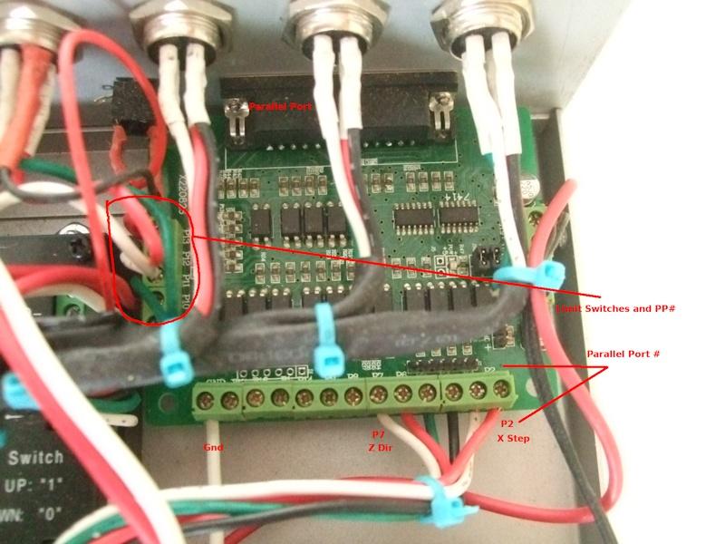

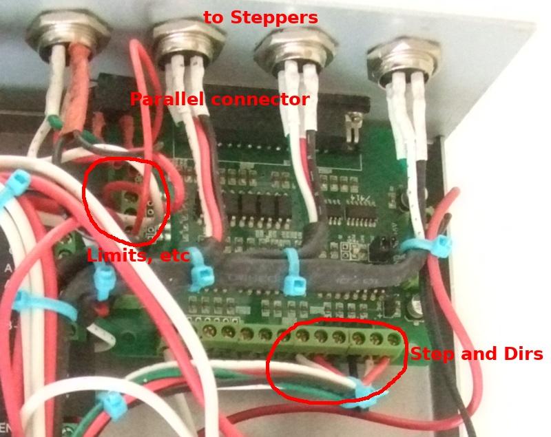

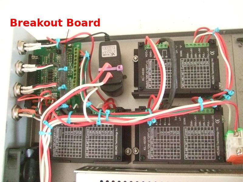

Well pictures are worth a thousand words they say, so here are a couple of the whole works, and the breakout board/parallel port:

 Are the arduios 3v  or 5v ?  Are the optoisolators compatible with the  Arduino I/O?
  • Posts: 6935
Hi Bill, the Arduino is a bog standard Arduino UNO, which as far as I know runs on any power supply between 7 and 12V, and can supply 5V as a source.
In GRBL setup mode, as far as I know, it can be direct connected to stepper drivers like the 3 boxes in my control unit without any opto isolators.
I've just taken a flashlight and a magnifying glass to the parallel port breakout circuit board and all the opto-isolators are a type 817S.

Well I'm going to rush in and tread where.... um I'm impatient....  :zap:
Okay so the first question is, are the opto-isolators going to be overdriven by the Arduino's outputs?
Let's say the Arduino is putting out 5V -- the 817 optoisolator can handle anywhere from about 5ma to 50 ma.
So I could hook up a variable power supply to one of the step or direction pins and slowly crank up the voltage from zero and see what the current draw is as I go, not to exceed 50ma. If I reach 5v, then I should be good to go on the step and direction pins. those are inputs
The switch pins are outputs and those are TTL level. I'll have to figure that out later. Right now I just want to get the steppers moving.

OK according to wiki Arduino UNOs are 5v so that's good .
Looking at the break-out board there appear to be resisters inline with the opto-isolators so , again , good.
The opto outputs (back to the arduino will probably need some pull-up current which should be supplied by the pin or a resister on the BO board.

The max input voltage for the 817 opto isolators is 1.4v (with 1.2v typical)... however, an inline (series) resistor of ~370ohm will drop 5v to around that level. If you've got the eyesight & the dexterity - if you can get a multimeter onto one of the series resistors, you should be able to determine whether it wants 3.3v, 5v - with 5v the most likely.
The issue with the opto isolators only tolerating such a low voltage is you'll burn them out long before the Arduino lets out the magic smoke: But... given a standard parallel port can be expected to be 5v, I think you'll be safe enough.

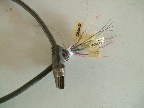

Thanks Ade! :beer: I didn't have the magnifying glass this afternoon, but spent a lot of time with a multimeter probing the parallel cable I have. It originally had a Centronics 36 pin connector at one end, and a DB25 at the other.
I chopped off the 36 pin end and will use the DB25 end. It was a really well made cable BTW. Heavy woven shield, then foil, then multicolored twisted pairs - 18 of pairs and a bare ground wire.
The pin assignments and colors worked out to:

phew!  :coffee:
  • Posts: 2488
white blk   25
grey wht          25
purple blk  25
Seems odd? Although I guess if it's got Centronics on the other end, that does make some sene, IIRC the Centronics connector was a 36 pin...
  • Posts: 6935
I agree, Ade. There are also duplicates for 21, 23, etc. plus the two N/C wires. Well, 36 wires into a 25 pin connector are gonna yield 11 extras. I think there's multiple grounds on a DB25 parallel setup, too.
Anyway, we're just going to use 12 of them. I tagged the necessary wires this morning with their functions, and trimmed the others back.

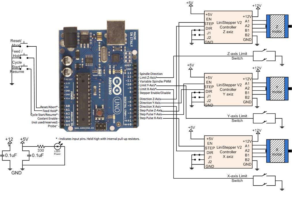

Well this was the temporary setup today, taped to the top of the CNC controller box and plugged into the parallel port.
I'd like to say it worked but, nope. Not a stepper motor peep out of it when everything was powered up, and I sent a jog command. None of the axes responded. No smoke either.
I suppose it could be that the limit switches aren't set right. I did check the Emergency Stop button. There is no wired "Enable" line on this CNC controller. Guess it was not considered necessary.
No detectable magic smoke was released during the test. Nothing happened at all.
Back to the drawing board. :(
  • Posts: 6935
Double checked wiring and it followed this pinout diagram, except no Enable/Disable, no spindle speed, and the Emergency Stop was connected to Reset/Abort pin -- the rest of those switches on the left side were omitted:

When you say there is no wired enable line on the controller, what do you mean?  If the stepper drivers have an enable pin as in the diagram you posted does that need to be pulled up?
If I were doing it I think the next step would be to check the outputs to your parallel port are doing what I would expect.

The stepper drivers are Keling k-4030 (no longer made) and as wired in the big controller box, there is no connection to any of them on the ENA+ and ENA- inputs. In other words, no wires to those terminals.
I boght this whole unit new many years ago. This CNC mill/router worked for me in the past, so I figure, the enable signals must not be needed.
Yesterday I got impatient and removed the parallel cable from the arduino, and removed the parallel breakout board from the controller. I soldered pins to all of the disconnected lines and plugged them into the arduino directly. I tried 3 kinds of software GRBL interfaces to try to get the mill going. The only one that worked was Universal Gcode Sender (UGS). Candle and GRB Panel, also tried, did not  . Unfortunately only the X axis was operational.
I did try changing the stepper lines to the controller box and established that the stepper motors for all 3 axes worked properly when connected to the X axis driver.
So troubleshooting is now focused on wiring the two Keling k4030 drivers alternately to the X axis output of the arduino -- if both then work I'll start looking at the arduino itself -- or maybe the power supply for it. I was feeding it 5 volts, but maybe that's not enough to generate a +5V signal on its outputs. Arduinos have a wide operational voltage range, but I think they might drop the signal lower than 5V if powered by 5v. I'll try a 9V power supply.
We'll get to the bottom of this. I bet when I do, it will turn out that the parallel cable would have worked, and it was other problems that prevented it.   :bang:

I added a 9 V power supply for the arduino. Upshot of testing this afternoon: motors and gantry all work, but two of the stepper drivers are bad.  :doh:
Time to order new ones. Presently the system has a 24V power supply w/ 8.3 amp output. The drivers are set at 2.7 amps each, 8 microsteps on 200 steps/rev nominal. So I have to find drivers that fit those specs.

Well, ironic possible end to this story (maybe not): NO the motor drivers were not bad.
The impetus for this GRBL project was the loss of the old Thinkpad600e laptop I used to run the CNC mill.
Since I last wrote here, I was able to get the software off of the old Thinkpad's hard drive, and image that onto the hard drive of a Thinkpad T43 laptop. And then to get that laptop's latency down via a kernel patch, to be able to run the old LinuxCNC version I had always run with this CNC mill. The T43 has a parallel port.
I therefore removed the GRBL Arduino, replaced the old parallel port breakout board that I had removed, connected up the Thinkpad, and......surprise, surprise, everything just worked! No problem with two of the drivers -- they all worked. And happily cut aluminum as commanded.
Soooooo.....something was obviously wrong with the whole GRBL scheme. I don't know why it was so flakey, and worked with only one axis. I'm wondering if it was a timing thing? Step and direction pulse width? I know you could adjust those in at least one of the CNC programs I tried. Maybe it was set too short? I don't know. I've never successfully been able to get an arduino w/GRBL going consistently.
By comparison, the LinuxCNC seems completely stable and usable.
I don't have a pressing need for the GRBL conversion now, but I get curious about this kind of stuff. I still wonder if the adapted cable would have worked, if indeed the only problem was a pulse width setting, and not the conversion itself?
