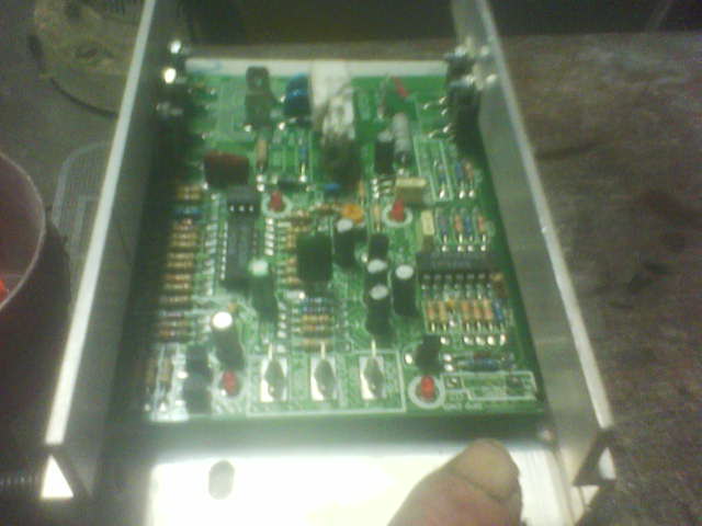

Offline unc1esteve
  • Posts: 126
Re: MC-60 Motor Control
« Reply #9 on: January 16, 2014, 02:02:03 PM »
I found this site but did not want to join.
Attached is a picture of my board.  The dirty finger
is pointing to the position of r-42.  It is the first resistor
on the bottom right corner.  The mosfits are at the opposite end.
Next to the r-42 position it says spd cntl.  Under the r-42 it says rps1.
This resistor is missing on my board.  I found the suggestions mentioned,
including yours, Chuck,
and tried several replacement resistors but they do not seem to be
the correct value including 5.4k.
The board will function without this resistor however it lacks what I call
torque.  The motor under load will start very slowly, run for a few minutes
and then stop with the motor trying to continue to run.
Replacing the missing resistor, the motor starts very nicely but again will
stop after a few minutes still trying to continue to run.
I have adjusted the speed control.  I found one resistor, r38, had a severed
lead wire.  I only found this out after touching each component with an insulated
screwdriver.
With this repaired the control is almost completely operational.  It just lacks the
correct starting torque and the running torque as it slows down under a load.
I found the treadmill in the rubbish dump.  I stripped it down to use as power
for a small green sand mixer.  I used the incline motor to position the mixer
to raise and lower for emptying.
I am now adding a mechanical speed reduction to slow down the speed and
add more torque.
Since the control will work without r-42 I thought that the value of r-42
would be very high?  All I need is to find the correct value to keep the mixer running.
I will again try 5.4k when I complete the reduction.
Thank you.
Offline Chuck in E. TN
  • Posts: 572
  • USAF Retired
« Reply #10 on: January 16, 2014, 03:57:23 PM »
unc1esteve,
I will go see if I can resd the color code on those resistors.
BTW, one of my MC-60's is running my greensand muller also. My muller is a Vontorne derivative, made from a BBQ propane bottle.
Chuck
Chuck in E. TN
  • Posts: 572
  • USAF Retired
« Reply #12 on: January 17, 2014, 03:35:44 PM »
I finally got out to the shop to take a closer look at my
MC-60's. The resistor in question is a different value on both controllers. One board is marked Rev J, one is marked Rev E. Funny thing, R42 is clipped on one end on both boards, and the resistor is bent up vertical to the board.! It's not used! Both boards are in service, and both function flawlessly. The Rev J board has R42 in the same position as yours, Rev E board, R42 is near center of the board, on the right side of the big power resistor. Both resistors ar 1/4 watt. Both boards have the label RPS1 next to R42.
I found somewhere on the web, a description of how to defeat the soft start on these controllers. I tried the mod as described, but it didn't work. It involved removing a transistor, if I recall correctly. I reinstalled the transistor. I wanted to be able to set a speed on the mill, and be able to shut it of and restart at the same speed again. Now, I just live with the soft start. It requires turning the speed pot to zero and back up untill the motor starts, and then setting speed. Works the same way as my 7x lathe controller, so I guess it's a good thing, plus I'm used to doing it that way.
I disconnected the muller controller and brought it in side to look at under my magnifier. It's (Rev E) R42 is banded brown, red, black, green, green.
Guess I'm not much help, eh?
Chuck

Offline mackn918
  • Posts: 2
« Reply #19 on: August 31, 2024, 04:15:47 PM »
 :update:  R42 Resister value For the MC-60 controller is..  *54.9K Ohm. the band colors are [Green-Yellow-White-Red-Brown]
If your motor does not start until the potentiometor is turned about half way replace or resolder r42 for fine motor control over full range.
