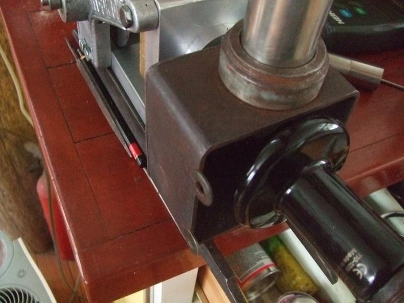

As I test ideas out on my hot air engine, No 83, I'd like a consistent heat source so I can actually compare output of changes made. So far I've used a can of Sterno, but it isn't very consistent. Less heat as the can burns down, etc.
What needs to be heated is the end of the stainless steel displacer tube -- heated area = approximately 1" long by 1" diameter (25mm x 25mm).
Temp of the cylinder wall should be some number in the region of say 250F - 450F (120C - 230C) -- not a critical number as long as it stays consistent. An electric heat source would be ideal for consistent heating.
I need something I can make myself from readily available materials or buy at low cost.

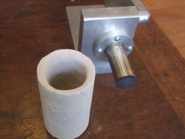

Hey, look what I just found!
It's a liner for a pouring cup for metal casting that I once made out of fireclay and sand. I packed it into a section of steel tubing, but since it sat for a couple years it shrank and released from it.
I was just hunting through scrap for something else I needed, and spied it sitting there loose in its tube.  :med:

« Reply #4 on: March 08, 2025, 07:08:34 PM »

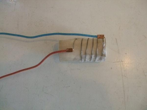

So just as a ballpark test to discover what I could, I created coils of the stainless steel fishing leader samples I have, using about 30" (76 cm) of wire in each and fitted them into the fireclay tube. I chose that length to give roughly 8 turns inside the tube. Then I hooked up to a variable DC power supply, and a kill-a-watt meter, and checked the internal temperatures with a non-contact thermometer.
Making the coils was very difficult because the stainless leader material is extremely resistant to bending. It's basically a spring version of stainless steel. I couldn't get it to form a coil around a mandrel larger than 1/2" (12mm) diameter. So I resorted to just bending it by hand roughly to fit into the tube. A series of many small kinks to yield the ID. The springiness held it against the inside of the tube..
If I substitute nichrome wire, presumably it will be more bendable on a mandrel close to the ID of the tube (about 1.3", 33mm) --- I hope!
It looks from these experiments like I need about 150 watts  to get the temperature in the range I wanted in that tube.
The heaviest leader material I have is .021" dia (.53 mm) -- and that was the best performer, and it starts to glow at about 5.5 amps.
That's all the info I have today.
Ideas and suggestions welcome.

Dave, I didn't realize there were low voltage versions of those. Thanks! I had one of the wall plug versions of those in college. If I remember correctly they warned that they would burn out if not immersed. Nice form for the purpose, though. A coil of about the right size.
I will also need to insulate around the heater, so kind of the opposite of the need for cooling on those immersion heaters. Thanks, though, I appreciate all suggestions!  :beer:

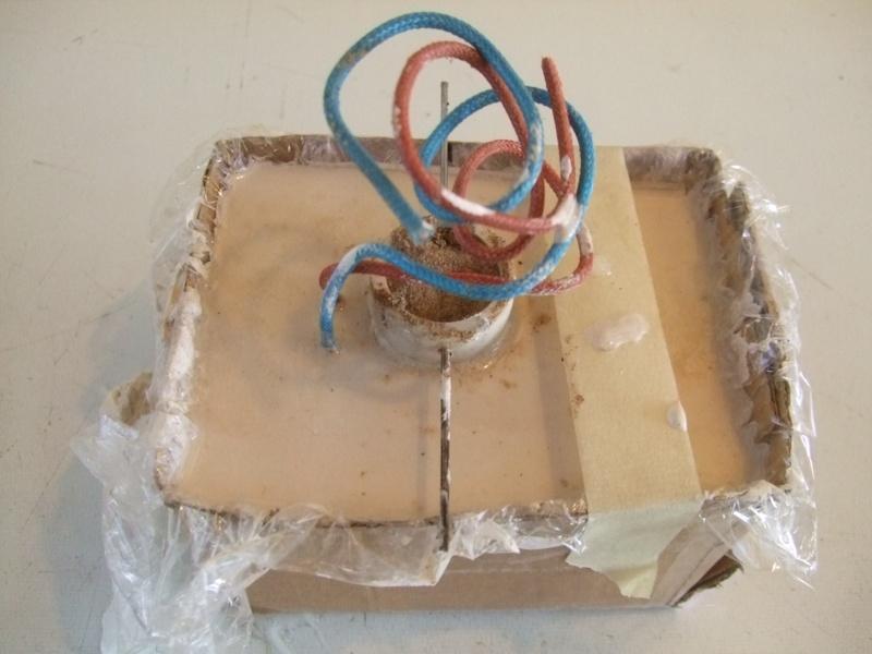

Well, off on an experiment using the previously tested stainless steel aircraft safety wire, and a plaster of Paris housing.
To begin with, I found a piece of 1" PVC water pipe which had an OD of close to 1-1/2" (38mm) and cut off about a 3 inch (76 mm) length. I wrapped it with the safety wire and taped the coils in place. Then I crimped a couple wires onto the ends using some copper tubing and a wire crimper. The wires were high temp type salvaged from a dead oil filled electric radiator.
  • Posts: 6829
Re: Electric heater for hot air engine?

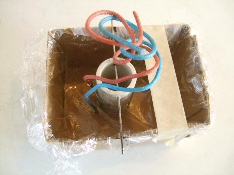

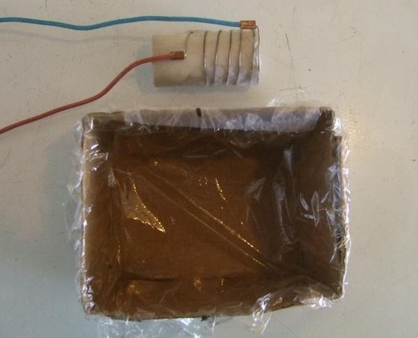

« Reply #21 on: March 18, 2025, 05:17:53 PM »
Then I cut a small cardboard box down to the rough dimensions I wanted, taped it back together and lined it with kitchen plastic wrap as a mold for the plaster.
I painted  Vaseline on the coil form as a release agent.
  • Posts: 6829
« Reply #22 on: March 18, 2025, 05:25:03 PM »
I poked a hole through the top of the water pipe with a hot length of piano wire, heated over the kitchen stove. I used that to suspend the heating coil over the mold. I had to coil the wires up to one side to get the coil to stand vertically. The through wire was located from one end of the mold, at the center height of No. 83's displacer cylinder.
Oh, forgot to mention earlier, the bottom of the water pipe was covered with tape, so the plaster couldn't rise up inside.
A piece of masking tape was used to tie the sides of the mold box together to prevent bulging at the top.
  • Posts: 6829
« Reply #23 on: March 18, 2025, 05:33:57 PM »
Plaster of Paris was combined with water, the lumps squeezed out by hand, and then I added about one third by volume of fine sand. this was mixed again, and I poured the mold.
I found that even with the weight of the heater and wires, it still wanted to float up sideways, pivoting on the wire. So I spooned sand into the pipe, which provided enough weight to keep it vertical.
Now to wait......

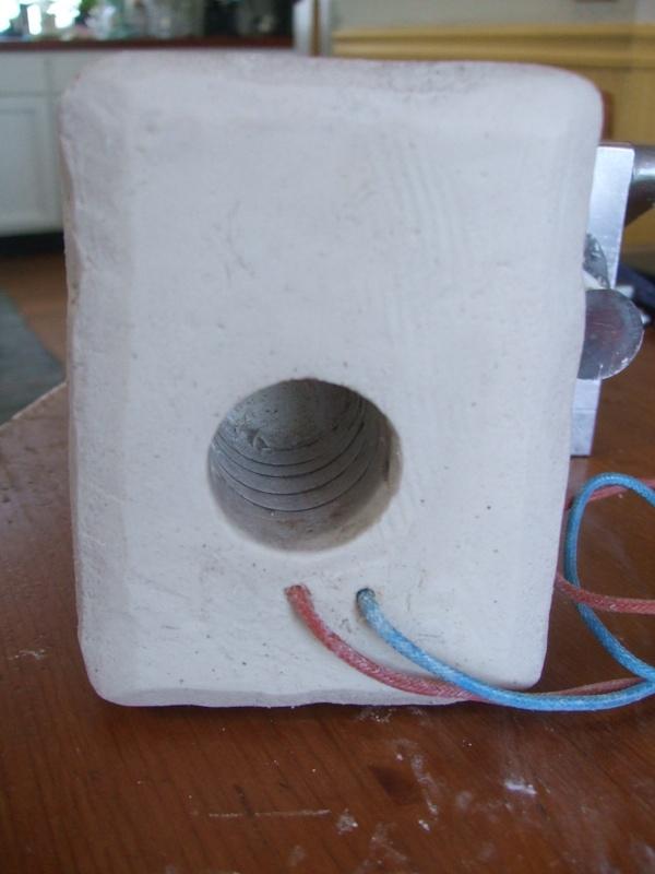

I let the plaster cure overnight before unmolding it.
I figured that removing the core pipe might give me some problems because of the tape and I had thought of several clever ways to get it out of there. But giving it a simple twist with pliers back and forth a tiny amount, and pulling slowly freed it quite easily.
The coil of wire stayed in place. All in all a satisfying little job. Will it work to run the engine? No idea!
