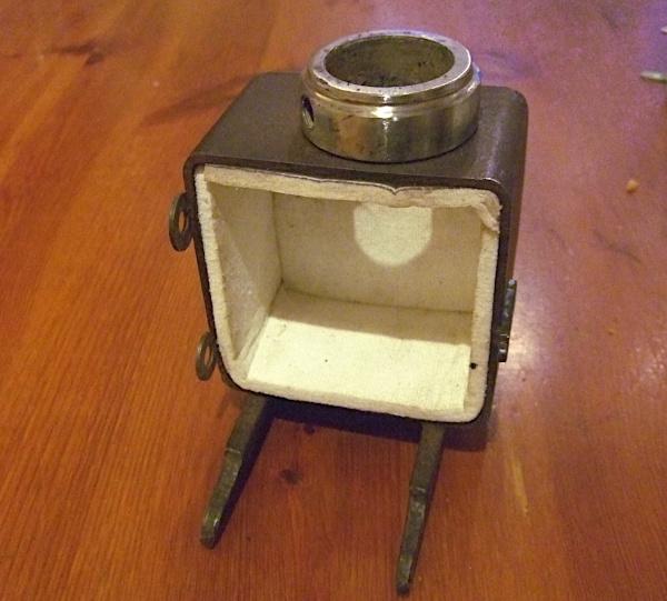

I think I mentioned that the original intention was to run this little engine on wood. I wish I'd had the time when I first built it to make that possible.
Today I started making a little latch for the fire door on the firebox. I also began insulating the firebox. It will be insulated just like my melting furnace, but on a tiny model scale.
Here I've fitted a layer of fiber insulation to start with:
