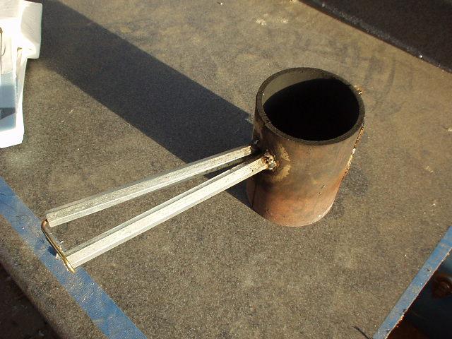

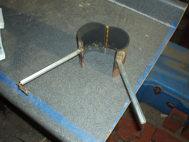

Well John a couple of (possibly worthless) suggestions, not having tried them on plastic.
1. Split the tube mold and braze on a cabinet hinge so it can be opened and closed to release the part. Tack on some rod handles so it is easier to open and close. Use a clip over the handles to hold them closed. The rods will apply spring tension.
2.Try soot on the inside of the tube mold as a release agent. (I use a candle held close to the surface for this as a release for casting aluminum over a releasable steel mandrel.)
3.Heat the tube itself to melt the plastic
There still might be bubbles that don't make it to the top in time to open them up with picks, it depends on how deep your mold is and how long you give it. Air is the main cause of scorching (besides heat and time). If you can exclude it somewhat you can heat for longer. I guess a deep mold should scorch only at the top. Maybe add a piece of wood to float on top?
Vibrator to help move the bubbles?
BTW what are the dimensions of the finished ingot?

The opening mould would be good but it might cause problems as I have to compress the mass as it cools and it likes to squirt out the most tiny gaps.
Yea, heating the plastic while in the mould (which is a length of water pipe) is something I have tried and is not a really bad idea but for a 2.5" pipe it takes more than an hour to heat through and I cannot really get the air out that gets trapped as I add more pieces.  Vibration does not work, something about Newtownian fluids or so I have been told.
I will definitely keep your piece of wood floating on top in mind.  I have a few pieces that have been in the mould but did not properly bond probably due to the surface chilling between wrestling off the oven tray and rolling to go in the mold so your piece of wood is timely as I have found trying to reheat chunks in the mould it does get charred after an hour in the oven.
