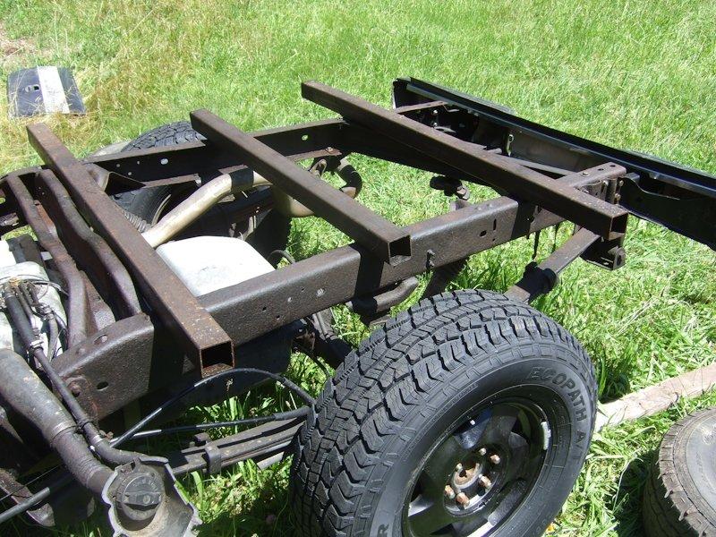

Thanks kindly, Charlie! :beer: What I like about the old truck is that it is very easy to work on, and parts are super available. You could practically build a new '96 Silverado from available parts.

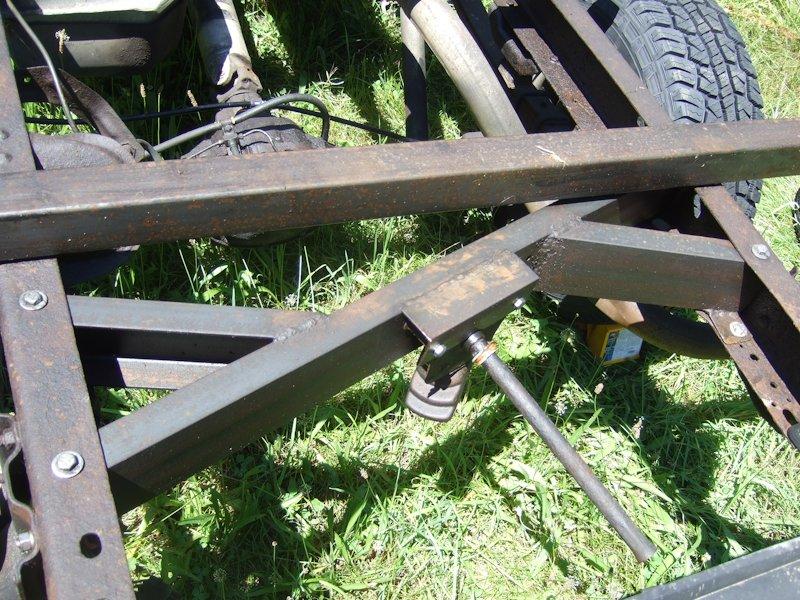

I do like the fact that it is heavily built, though that tends to mitigate against fuel economy. But it does mean that the frame has lasted in the Northeastern winters where salt on roads is heavy. Most vehicles here die, not from mechanical issues but rust. This truck was somehow preserved when I bought it years ago, and after the repairs I now undercoat it with a commercial oil compound each fall to keep it that way. I've also reduced driving it in winter.
The cross frames under the bed were rusted away at the ends, since they were thin hat-shaped sections spot welded to the bed floor -- almost designed to rust. Last summer I pulled the bed off, ground them off, and replaced with much heavier steel square tube. The bed itself was fine, since it had a bed liner and someone had smeared grease under it before installing.
Square tube for frames:
A fabricated X main frame cross member and spare tire winch from channel iron:

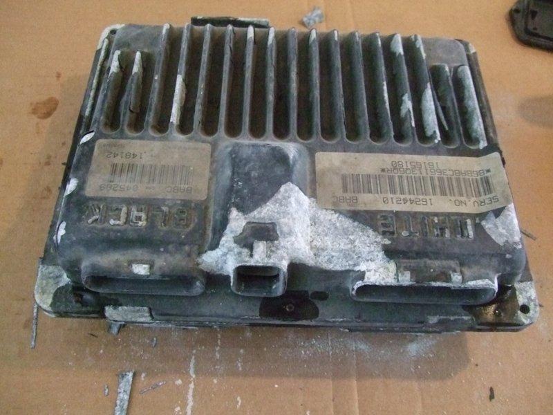

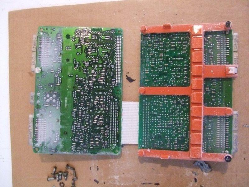

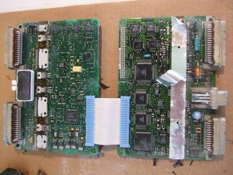

I'm pretty comfortable with the PCM in my truck -- heh, '96 is the computer era, when you think about it, earlier even than Windows 98. it's DOS era. It's really interesting how sophisticated nevertheless these control computers were for their time.
Here's the kind in my truck, called a "BlackBox" PCM by Chevy enthusiasts. This one is a junkyard donor box, which I am robbing for the connectors:
  • Posts: 6823
Re: Reducing Fuel Consumption of an 30 Year Old 8 Cylinder Pickup Truck
« Reply #5 on: January 22, 2025, 06:29:26 PM »

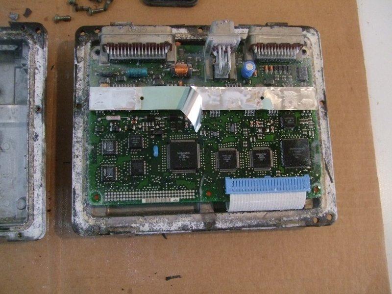

Opening it up:
It contains two PC boards which are piggybacked to each other:
There is an interesting system of aluminum tape and cement to transfer heat to the outer case heat sinks.

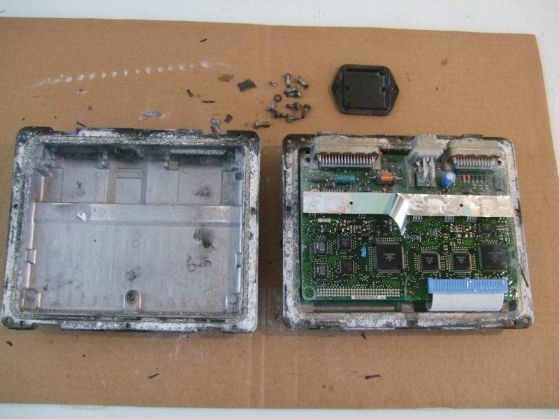

Here are the boards apart. There's a cemented rubber shock absorber framework between the boards:
And here's the outer side of the boards:

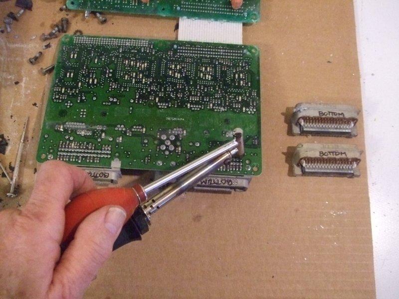

Here I am removing the soldered connectors, which I will use in the adapter cable. It's an old Radio Shack (who?) solder sucker -- maybe the same era as the PCM!

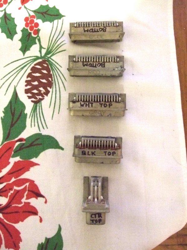

Here are the connectors I got out of the box. There are 5 of them. Three are 32 pint, one is 24 pin, and then there's an odd center connector, that actually just has a pair of pins shorted by the harness. The multipin connectors are color coded Red, Blue, Black, and White (or gray), and I've marked tops and bottoms as well as the color.

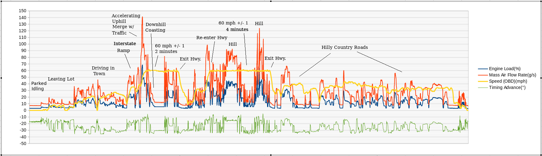

I should add a few things about this project, since the PCM swap is actually just a part of what I have planned. I'm also hoping to address the Silverado's wind resistance, to try to improve fuel economy. To relate to you, my cousins across the pond, let's just say it presently has the aerodynamics of Winchester cathedral.
I've come to realize just how this affects the truck at various speeds by installing an inexpensive bluetooth monitor dongle in my truck's OBDII port, and using a program on my cell phone to record several parameters while driving. Very interesting stuff. My truck gets better gas mileage, for instance, at 35-45 mph, than it does at 50-55 mph. Obviously, wind resistance is a big factor here.
BTW in case anyone is interested, the dongle I use is a Vgate iCar Pro Bluetooth, which cost me about $30.
I run the Torque Pro App on my phone and tablet (about $5). This is an amazing, to me, combination. I can configure any on-screen gauges to monitor a selection of maybe a hundred different engine and vehicle parameters, in real time, and even create logs.
Here's a graphed example of a log I created for some specific engine parameters I wanted to record for a test drive which included idling, in town driving, highway driving, and country road (curvy, hilly, low traffic, few stops) driving. I'm attaching a screenshot example (sorry, too wide for forum inline placement).

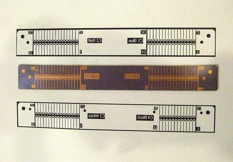

And this is a PC board I've been working on to mount the connectors. I managed to get a mask onto it after many trials and much tribulation using printer transfer methods.
I haven't etched it yet. I finally hit on a transfer method that works for me. That took a week of experimenting. Some here may recall a similar problem I had back when I wanted to make an etched brass plaque for my electronic leadscrew project. I never did get a good enough mask then. I might revisit that now that I have a system that works.
re. pc boards for this cable....I would have liked to have just spliced wires between the old PCM to the new PCM connectors point to point, in order to make up a conversion cable. Unfortunately, the salvaged PCM connectors are right angle PC mount, and that would not work for a cable. So I drew up two short narrow PC boards that bring out the pins. I can then solder wires in the proper direction as a cable. These narrow boards mimic the orientation and spacing of the two back-to-back PC boards that I removed the connectors from. This orientation and spacing will help mate the connectors easily to the vehicle's bundled and wrapped connector harness. That's the hope, anyway.
