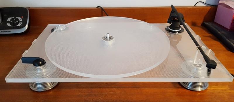

Made from parts of a few old harddrives and broken monitors.
The deck is the poly carbonate light-pipe from a 19inch monitor turning on the motor (used only as a bearing) of an HDD  .
The drive motor is another hdd motor driven by a ebay 3ph driver board. it turns the deck using a monofilament fishing line , knotted into a belt.
The arm is 3d printed in resin with a carbon fibre tube and uses more hdd bearings.
The 10mm poly carbonate body is from another 21inch monitor.
The "soundstage enhancing constrained-layer anti-resonance clarity hooves"  (copyright nephew George) are surplus poly V pulleys.

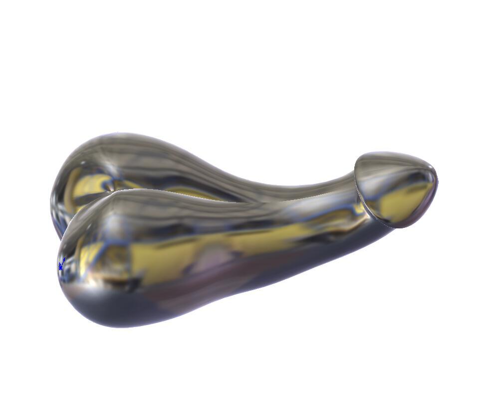

  • Posts: 1203
Re: Retro turntable from old computer bits
« Reply #8 on: November 23, 2024, 06:01:37 AM »
Don't forget the photos! :thumbup:
This was a bloody tricky thing to model in a cad program !
