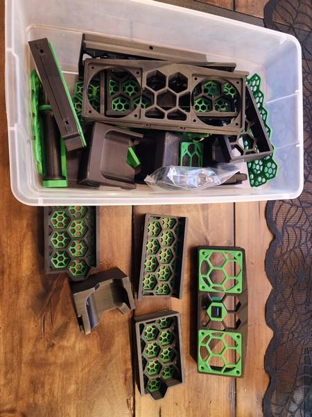

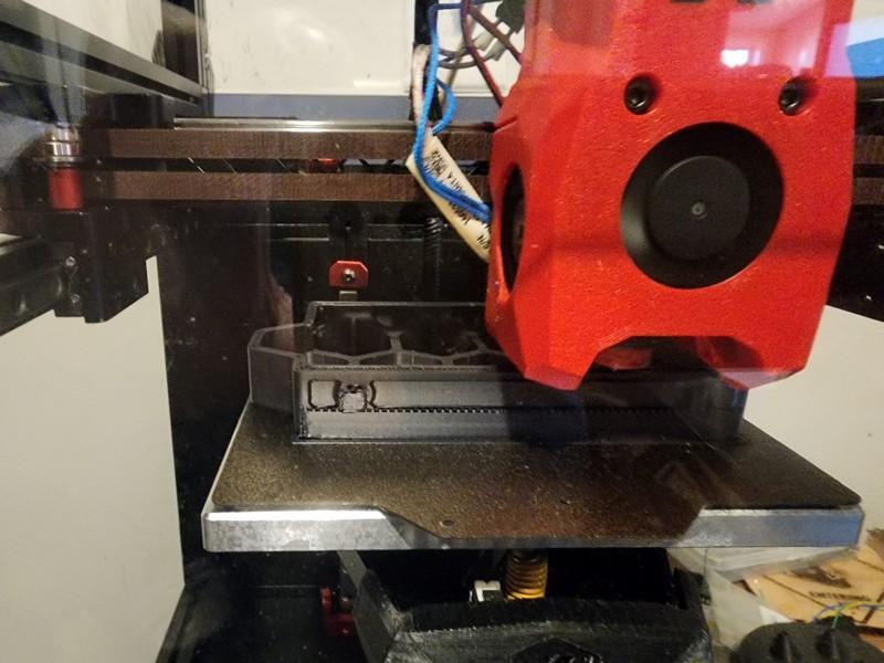

I have started printing the required parts.
Most of the parts I have been printing on my tiny Voron 0.2. It is a fantastic little printer. Sits by my desk and prints almost non stop.
Going to start cutting the frame in the next day or two.

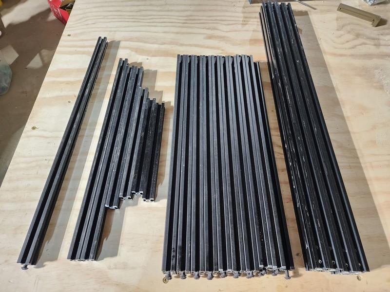

Re: 3D Printer Build - BLV to Voron Trident conversion
« Reply #14 on: October 31, 2024, 10:18:27 AM »

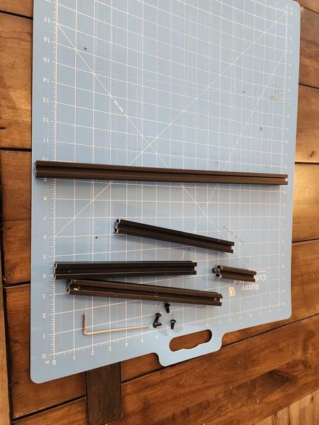

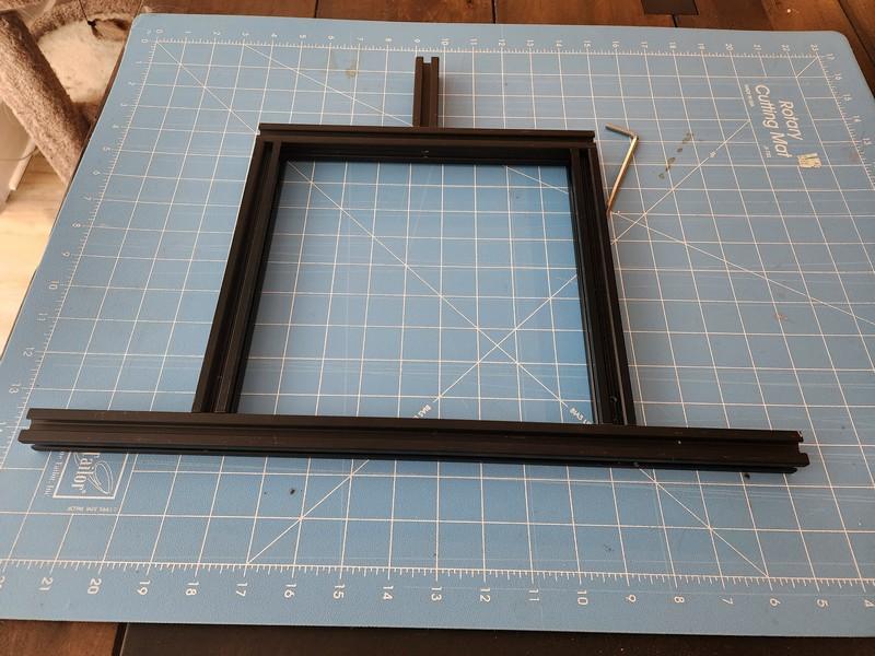

Spent some time last night disassembling the BLV frame and then cutting, drilling and tapping.
The end result is this pile of extrusions. Ignore the mess and dirt. The frame has been sitting in my shop as I have been building the shop out. So it was/is coated in dust... now swarf too!

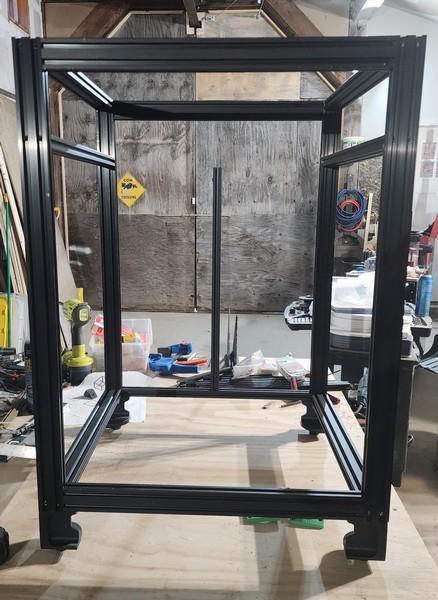

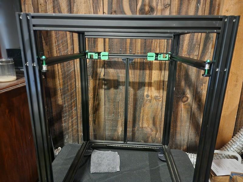

Got the main part of the frame assembled and on it's printed corners (for the electronics skirt).
It stands about 31" (about 79 cm) tall and is about 22" (about 56 cm) deep and wide. The actual build plate will be 355mm x 355mm.

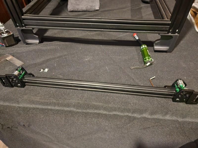

Got a bit more work done on it while I await parts.
Started getting the gantry together. Also printing parts for the boxturtle AMS.
Going to try to get the linear rails for the gantry cut today or tomorrow.

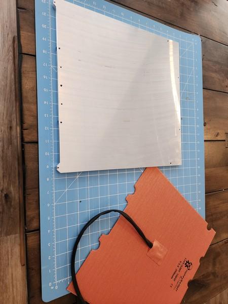

Once again, as I go to work on this build, I figure out that I have either a. ordered the wrong thing or b. didn't order at all. Hence, me building this thing slowly.
I started to build the build table portion because I SHOULD have all the parts...
...I didn't have all the parts so only got half built :doh: :doh:.

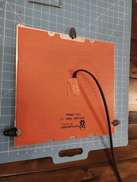

I got the bed heater mounted up and the carrier frame built. Ordered the correct bearings for the bed mount. Hope to have them in by the end of the week.

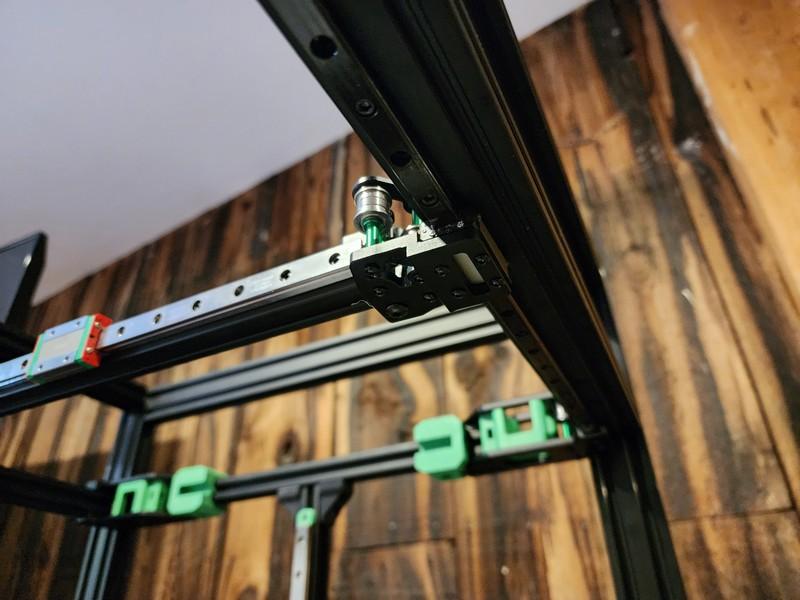

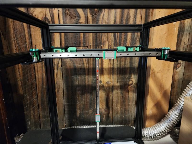

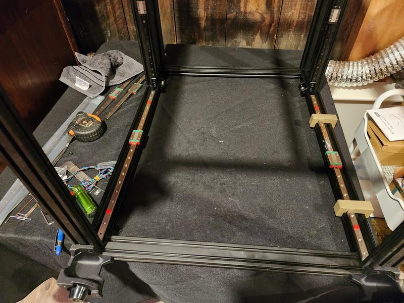

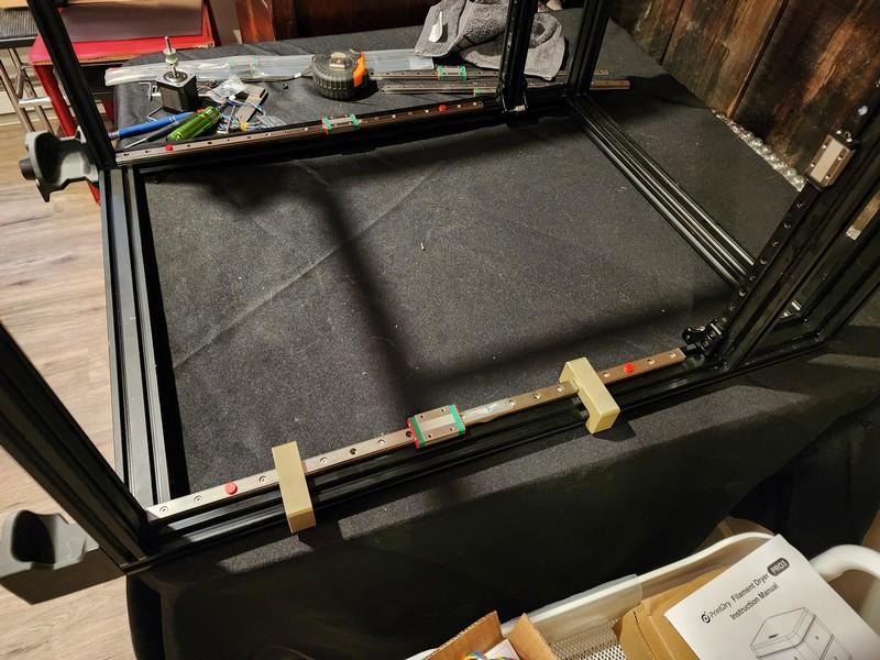

I also got all the linear rails mounted for the gantry. Originally had MGN12's for the Y axis. Would have been fine had I stuck to the Vanilla plan. But NOOOO I had to go and get the metal/9mm belt mod for the Trident. Which meant I needed mgn9 rails for the Y Axis. Of course I didn't have any, so, had to order a set and wait...
Finally arrived and I was able to get the rest of the gantry mounted up. I still need to mount the A/B motors and string the belts. I ordered a cnc'd metal stealthburner mount. As soon as that arrives I can do the belts.
« Reply #21 on: December 16, 2024, 12:22:17 PM »
I also cleaned and greased the 3 linear rails for the Z axis. I then add the motor mounts. For giggles I popped the bottom plate in to see how it fits...

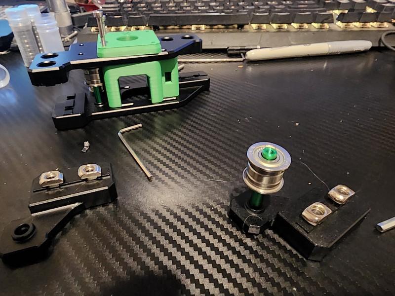

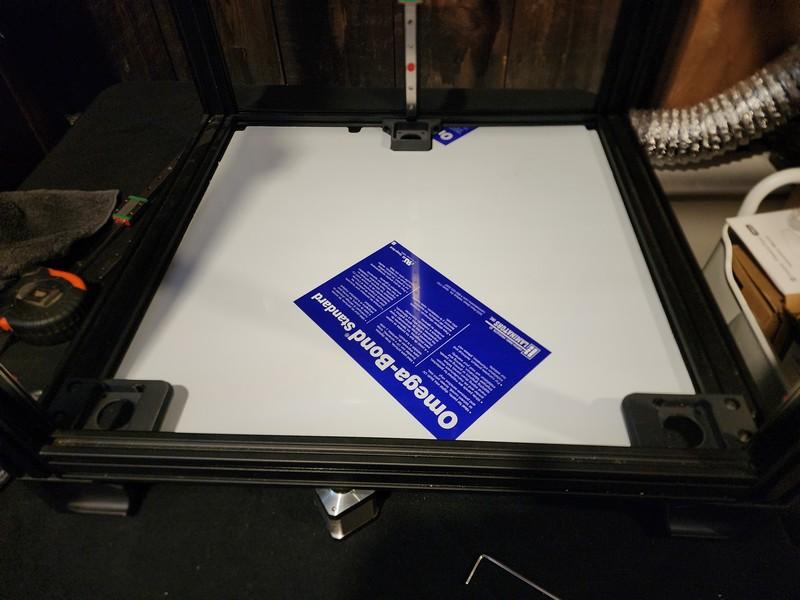

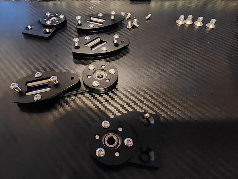

Ok. The bearings came in today. So, I started to assemble the Kinematic bed mount for the printer and have encountered another issue. IF I wanted to build it based solely on the B2V conversion based above I would be OK. However, I want to use the Kinematic bed mounts and WobbleX for the Z screws. Since the BLV MGN calls for MGN12 rails on all axes, the B2V conversion is designed for MGN12s. I have since discovered that the stock Voron Trident uses MGN9s on the Y and Z axes. I found this out when I went to mount the 9mm belt (instead of the 6mm belt) for the gantry. The aluminum parts are designed to use the MGN9. SOOO I ordered 2 MGN9s for the Y axis.
Fast forward to setting up the bed and Z axis. Again, stock Voron Trident uses MGN9s while the conversion uses MGN12s. I have mods that require the MGN9s. Now I have to order 3 more 500mm MGN9 rails. They wont be here until after Christmas  :zap:
FYI, this is the WobbleX mod:
It is designed to help reduce "Z Banding" which is a strange artifact from using Acme screws on the Z axis. Printers that use belts for the Z, usually dont see it as bad.

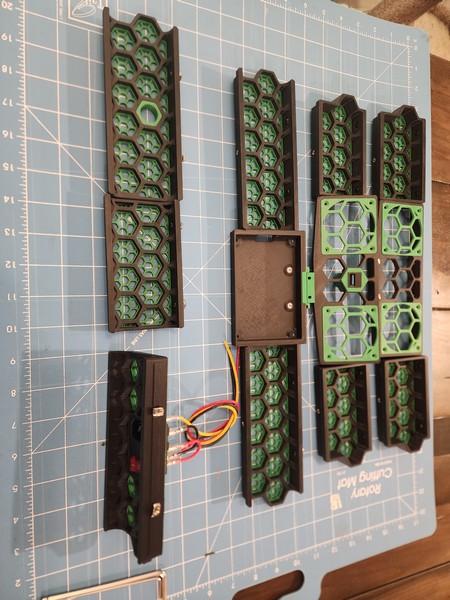

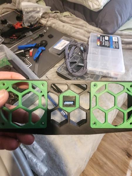

I got some other things done. I finished up the skirt; glued, added heat screw inserts and generally got them ready. I also got the bed frame done and the rest of the parts mounted to the bed. Which, I am going to take apart and rebuild anyway!  :doh: :doh:
On to more waiting...
