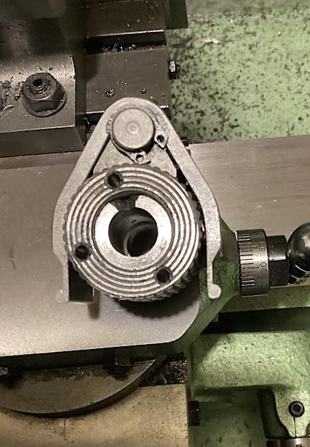

A bit of advice please, I have made a new post for the Multifix size Aa on my Myford and as I didn’t use the steady pin initially I thought I would do it as I have it apart, underneath are three equally spaced holes although I only need one but am not sure how to get one in the correct place in the compound if it’s slightly out the holder won’t be square to the headstock , I know the Multifix will tour but it could be possible to get the hole half a hole out so if anyone has a suggestion or has already done it would be much appreciated , hope that makes sense.

Perhaps post a photo. I'm guessing the holes are blind.
I have the Dickson type toolpost on my lathe and it doesn't have a location dowel (nor does it need one). Because it's basically square I can easily set it with a square.

Here is a picture of the underside of the Multifix I only need to use one hole and the holes are blind.

I'm guessing that the three holes would locate the body in different positions so e.g ideally you'd get one to position the tool to be square to the topslide and the others would give you a few degrees variation. I haven't been able to find a drawing with the hole positions online.

No I couldn’t find a drawing either , I only need to fix it square to the compound because it’s adjustable in 40 other positions without undoing the centre locknut.

I have 3 of the larger AA size toolholders and they all have 2 holes at 180 degrees

I've done a bit more Googling and have found sections through the toolpost and even a photo of a spare body. All show through holes! Have you taken the top cover off to have a look?
I know this is a bigger Multifix but clearly shows the holes at the top.

Yes I have taken the top off and they are definitely blind holes , it seems the larger Multifix has through holes but not small ones.
I ended up turning a pointed stud inserting it in hole squaring holder and tapping with a soft hammer and it marked it just enough for me to centre punch and drill , all back together now.
