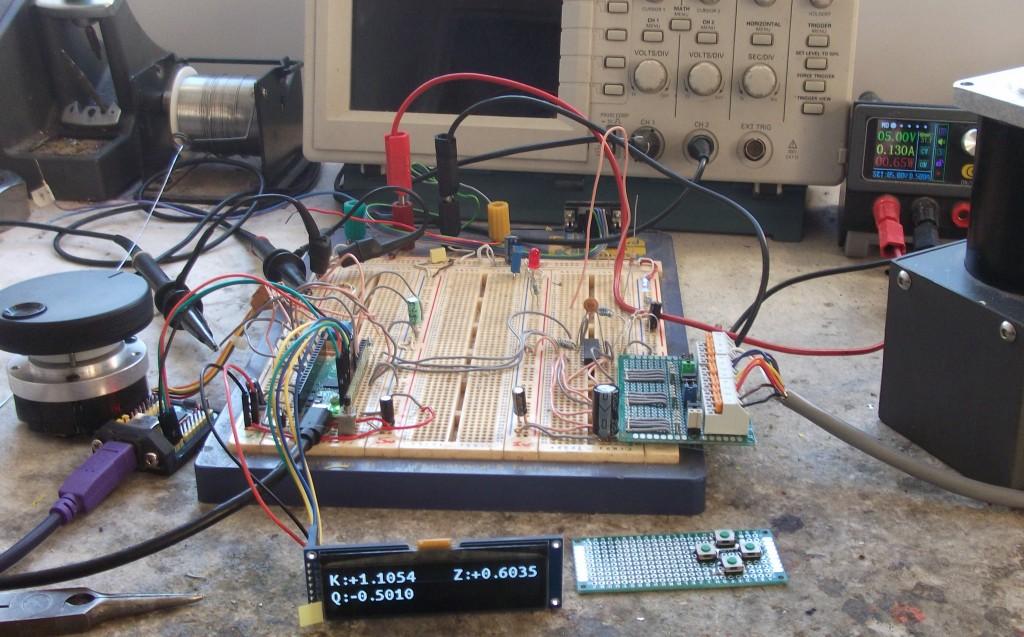

This doesn't look much ATM  but this is the heart of the DRO :
On the extreme left is a hand-wheel encoder and right , a servo motor they are  standing in for a glass scales giving a 2000 and 5000 pulse per rev quadrature output . Each feeds a PICO PIO programmed as a quadrature counter and displayed as K: ans Q: .
A third PIO input , Z: , is fed from the quadrature output pins @ 2000pulse per unit  which is currently squirting out the sum of K and Q (the slight error in the counts is due to the difference in resolutions (my mill would not see those last two digits)

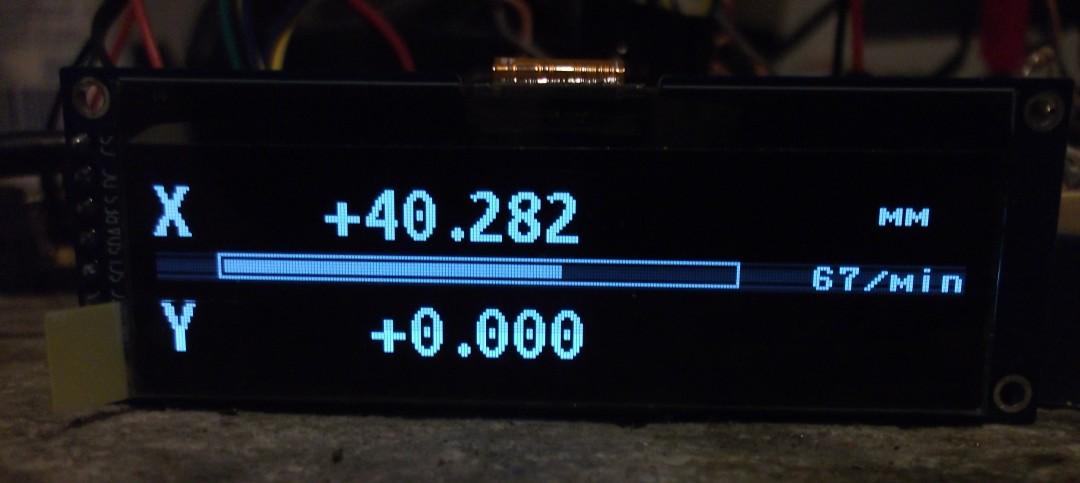

I've just uploaded a short video of the menu
I'd like to find a true monospace font that has consistent width , this one jumps about too much for my liking
  • Posts: 1179
Re: Pi PICO DRO/Quill-Knee combiner
« Reply #20 on: January 30, 2024, 02:19:47 PM »
Aha!
 fixed the font error by editing the font file . No more bouncing numbers .

Update:
I've added a surface speed bargraph to the two axis display .ATM it assumes the axes are perpendicular but any angle could be programmed.
