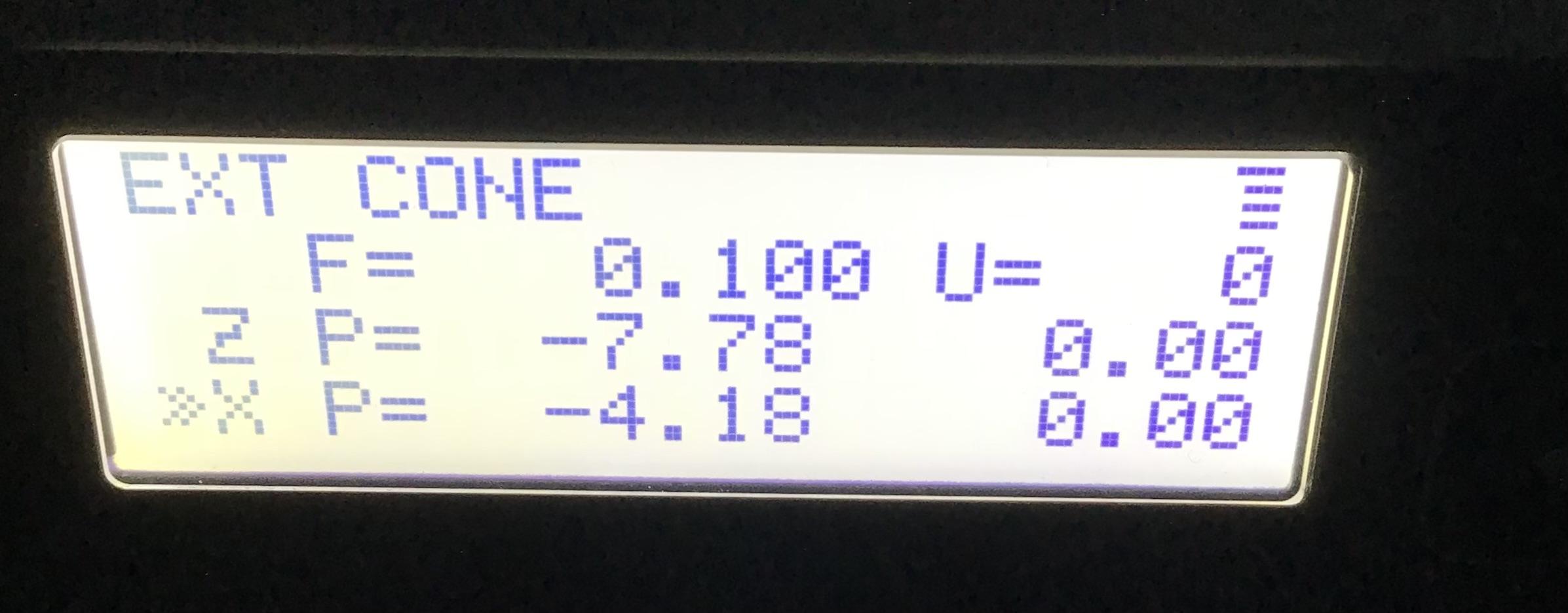

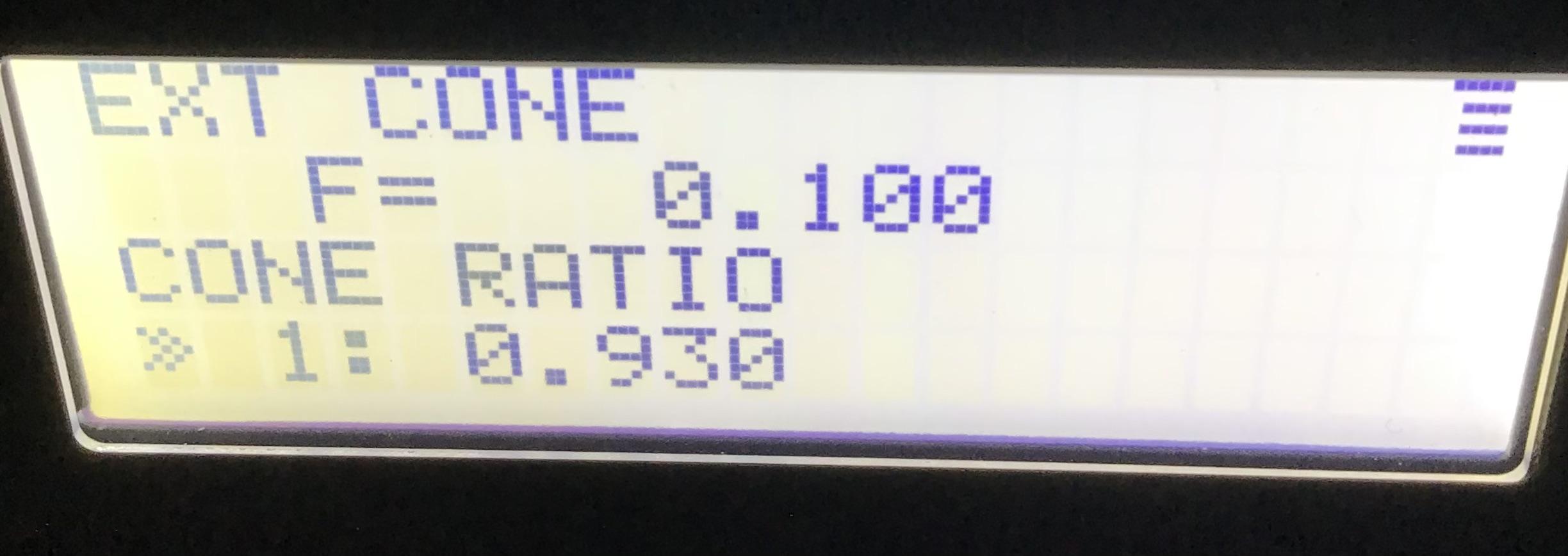

« Reply #5 on: November 06, 2023, 04:28:46 AM »
I can add the parameters in one of too ways either -Z & -X or as a cone ratio.   [ You are not allowed to view attachments ]     [ You are not allowed to view attachments ]

Re: Cutting a taper
« Reply #7 on: November 06, 2023, 10:06:55 AM »
Dell,
I may have made a mistake in my previous figures as I drew it out in Autocad at 2:1 and probably forgot to divide measurements by 2.
I believe that, according to the manual, these are the correct numbers:
Entering ZP (length of taper) & XP ((D-d)/2) you should have ZP = 7.800 and XP = 2.090
Entering Cone Ratio (L/(D-d)) L=7.8, D-d = 4.18 therefore Cone Ratio = 1.866
Good luck!

« Reply #8 on: November 06, 2023, 02:17:33 PM »
Thanks phil
That was a mistake on my part I quickly input the figures to take the picture, the overall length is 7.8 mm.

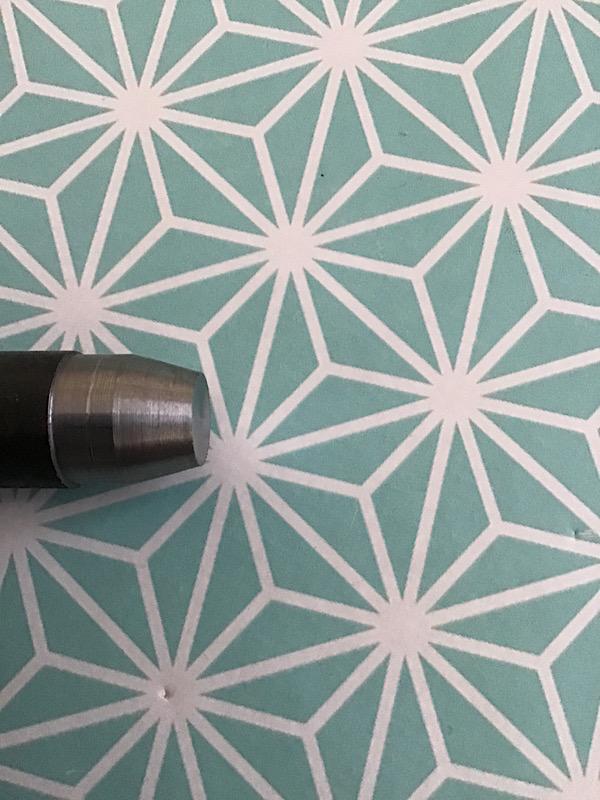

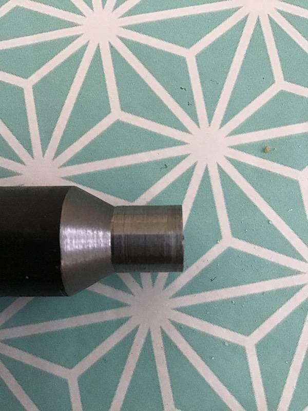

« Reply #9 on: November 07, 2023, 05:30:28 AM »
Okay now I have a perfect taper so I thought I would cut another piece including a bit of shaft ( second picture) but as can be seen before the taper is finished it starts cutting into the shaft , what I did was turn a short 10mm down to simulate the main shank to 9.7mm then proceeded to cut the taper but stopped with 3 cuts left there should be a slight step between shaft and start of taper.

« Reply #10 on: November 09, 2023, 06:50:53 AM »
Finally figured it out instead of setting both axis to zero I set X axis to .25mm above zero then zero X axis cut taper and it leaves .5mm step.

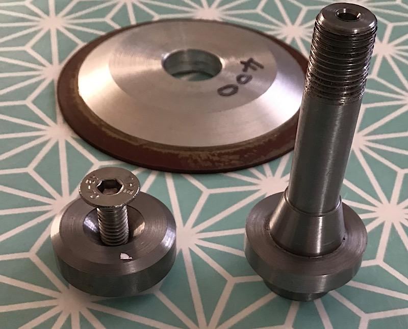

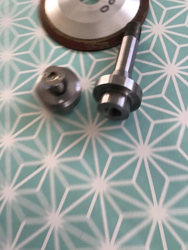

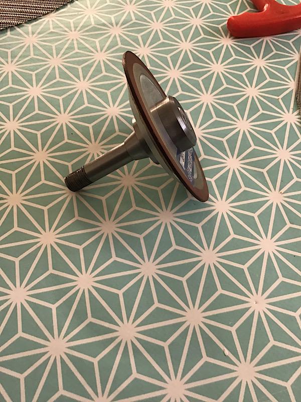

« Reply #12 on: November 25, 2023, 08:16:59 AM »
Finally got around to finishing the arbor for mounting diamond discs to the Pultra.
