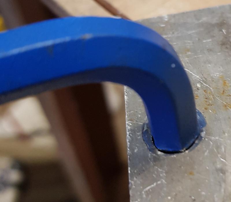

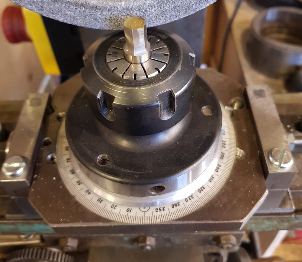

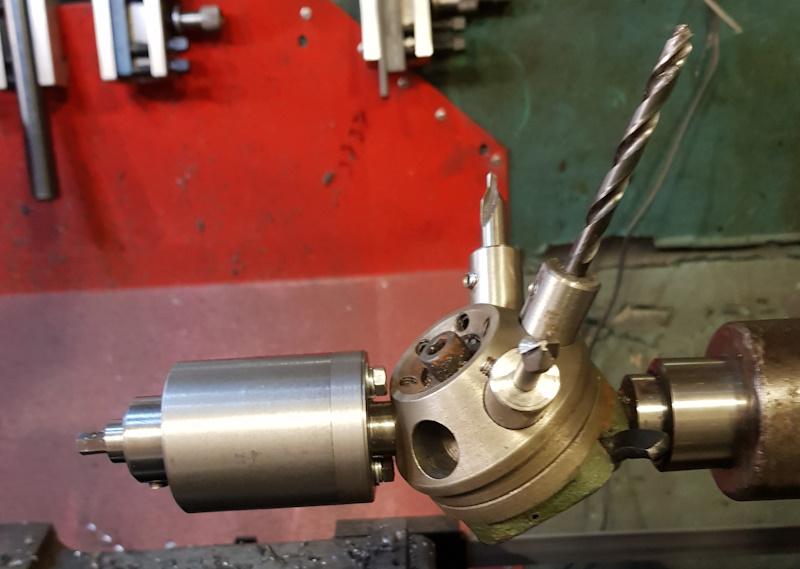

...to grind broaching bits on my surface grinder. Pic 1 is the jig in place on the grinder, I can set the angle needed and lock it in place then use the protractor to set the facet to be cut. It is locked in position by way of a bar going under the collet with a dimple and ball bearing to wedge it solid.

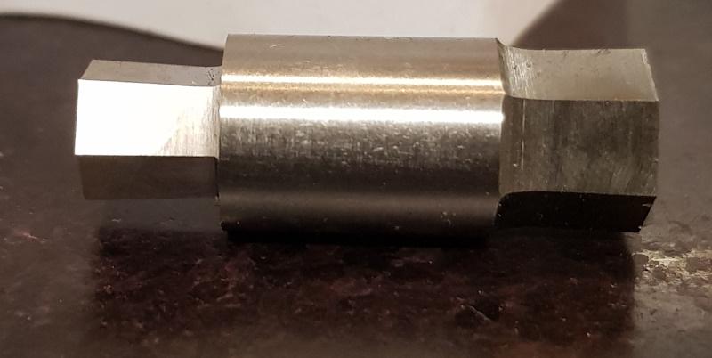

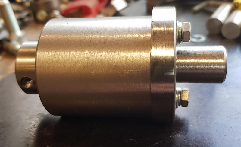

Pic2 is the result of my test to make a 8mm hex broach out of a M14 tap shaft.

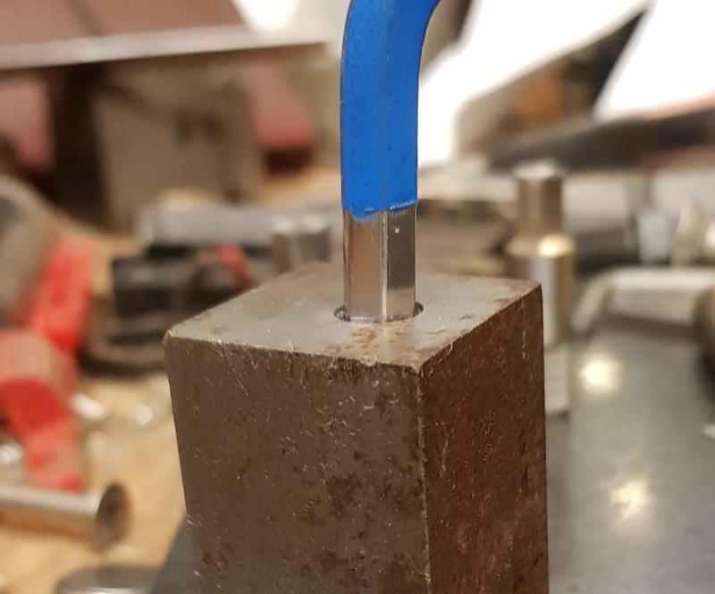

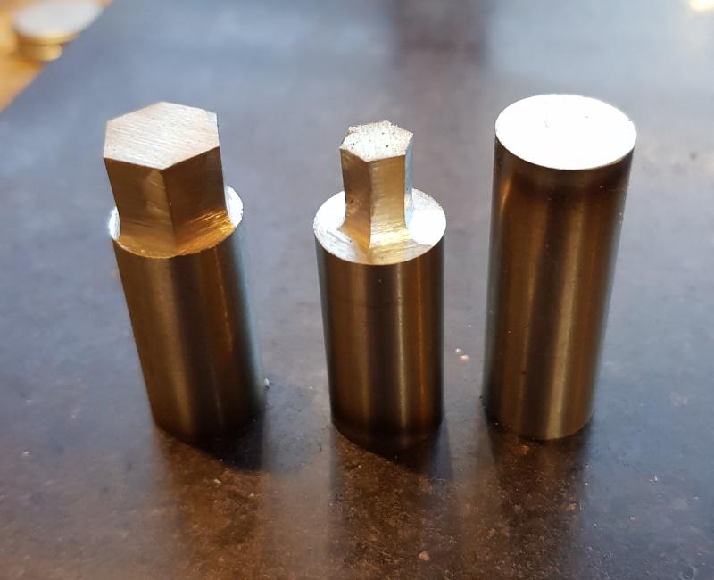

Pic3 I pushed the broach through a scrap bit of aluminium and the allen key fits perfectly.

Oh, that is NICE!
I cheat when making hex holes - I use a EDM machine :D Although that only works if the thing I'm "drilling" is quite small, otherwise it won't fit in the tank  :Doh:

I looked into cheap and cheerful EDM when I first looked at doing this but decided that for the quantity I hope to be needing it would take too long. Having said that I would really like to play about with EDM but must not get distracted.  :wack:

just completed the 8mm broach and I am really pleased with how my little grinder is performing, its really good when I dress the wheel before starting and I have included pics of that and the start of the tool inself.

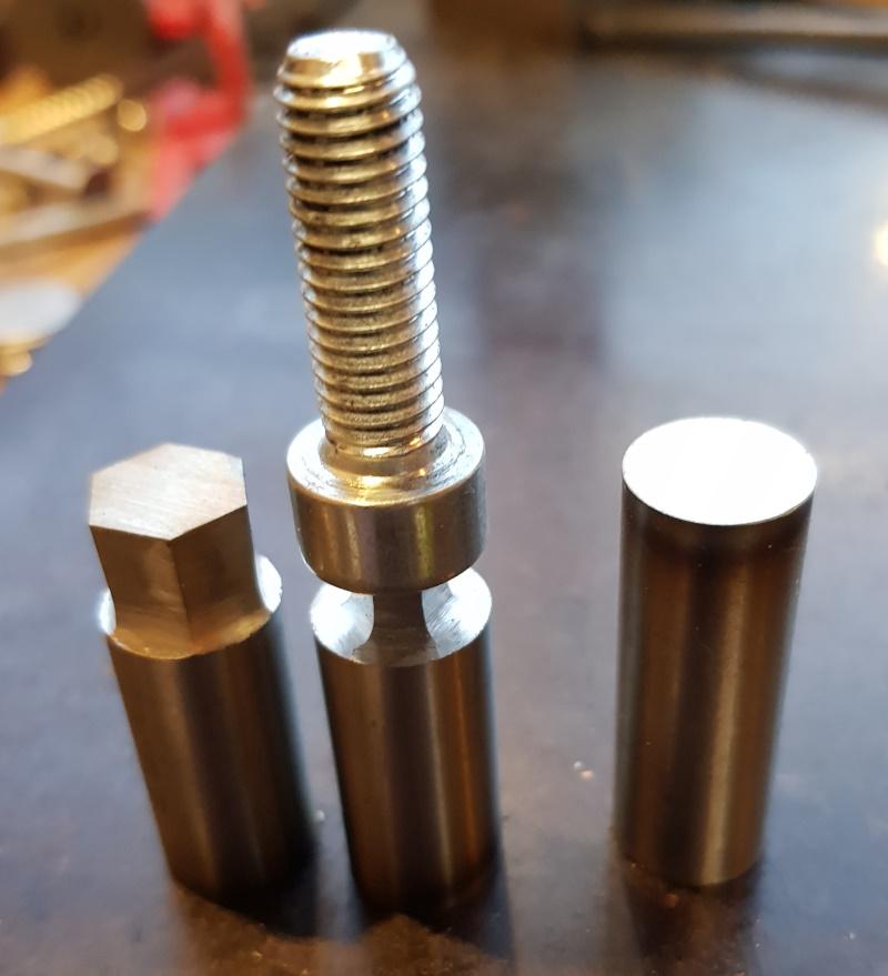

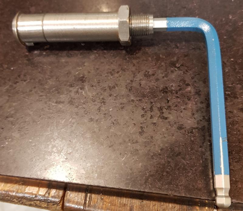

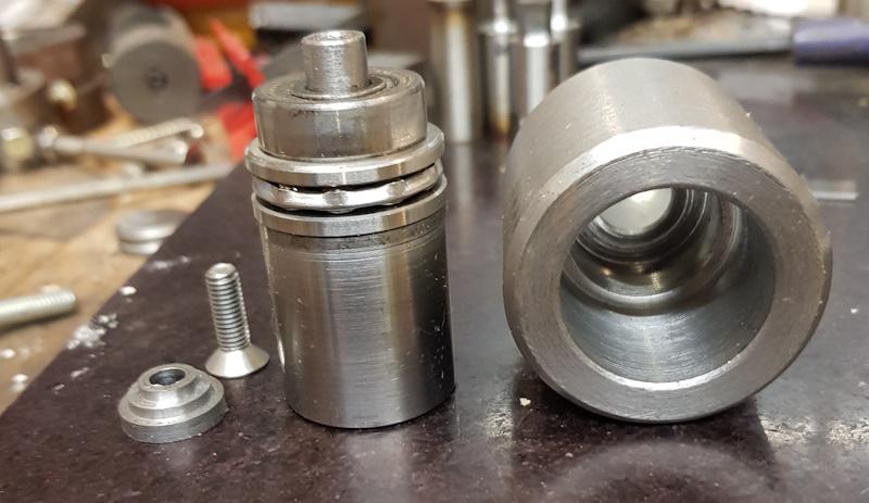

First attempt at a holder did not work well, it was fine pushing it into the part allbeit a little more effort than I had expected which could have been because it wasn't quite centred properly. however when trying to withdraw the broach the whole thing came apart.
So I altered the design a little to ensure that it is running on a trapped bearing while it is being withdrawn. If it works ok this time I wil post a drawing.

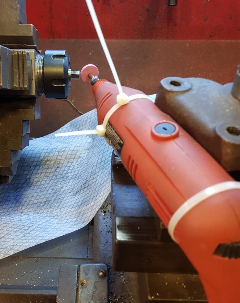

And worked out a professional tool to sharpen tips. :lol:

The pressure needed at the beginning is very good but adds up as it cuts but I think if I remove that with the drill then take another bite I can get the hex a bit deeper. I will try that tomorrow.

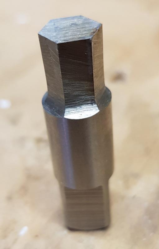

I set it all up and I am quite pleased with the results. however I discovered that the selection of 6mm allen keys I have vary from 5.97mm (the one I measured to get the size of the broach) to 6.05mm which will fit but gets a bit stuck as I made the broach 6.05mm so I might need to make another nearer to 6.1mm.
I have included pics of the setup and end result but my phone is struggling to get a decent close up of the hex itself.
One thing to note is to do with setting the tool, I found it much easier to set when I drilled a slightly oversize hole (6.5mm) in a plate and put it in the mill then turned it by hand and set it until the plate did not move when turning the broach tool rather than trying to clock it up on the lathe.

I found the system extremely sensitive to clearance diameter. Learned the hard way with too small holes :)
