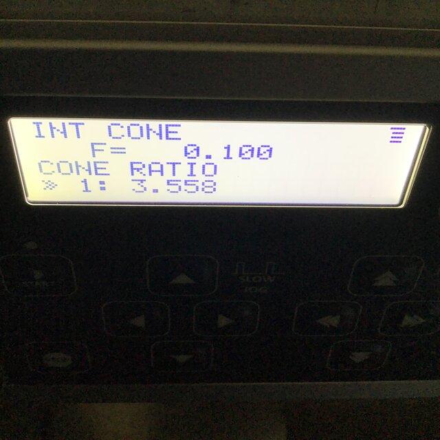

I need to make a ER11 collet chuck for my Pultra using my Myford equipped with Rocketronics I decided to make it out of aluminium first so I don’t mess up the arbor but I am a bit stuck , the taper angle is 8 degrees and I need to put 12.452mm in -Z but there not enough digits so I can only input 12.4 or 12.5 but there is an option to input cone ratio but even after a google search I am none the wiser as to how to convert to cone ratio not even sure if it will help the parameters are large end 11mm small end 7.5mm with an overall length of 12.452mm giving 8degrees 16degree included  angle so if anyone on here knows how to convert to cone ratio it would be much appreciated.

You just need to convert the dimensions you have to whole numbers in Z or X
Slope is (11.0 - 7.5)/2  =1.75  in 12.452 or 1 in 12.452/1.75= 1in 7.11542857143
Edit (major brain fart later) unless it requires the inverse (taper): offset distance per unit length
1,75 /12.452 = 0.14053967234 in 1
  • Posts: 1179
Re: Making a ER11 chuck
« Reply #3 on: October 05, 2023, 02:02:23 PM »
 :headbang:Reading the manual it is as clear as mud.
However it is clear they require the included angle so 1.75 x 2
12.452/3.5 = 3.55771428571
So cone ratio is smaller compared to their examples.

The cone ratio for your ELS is defined as V=L/(D-d) or, in your case V= 12.452/(11-7.5) Which equates to 3.557714.
If you can input to 3 decimal points put in 3.558
Hope this helps.

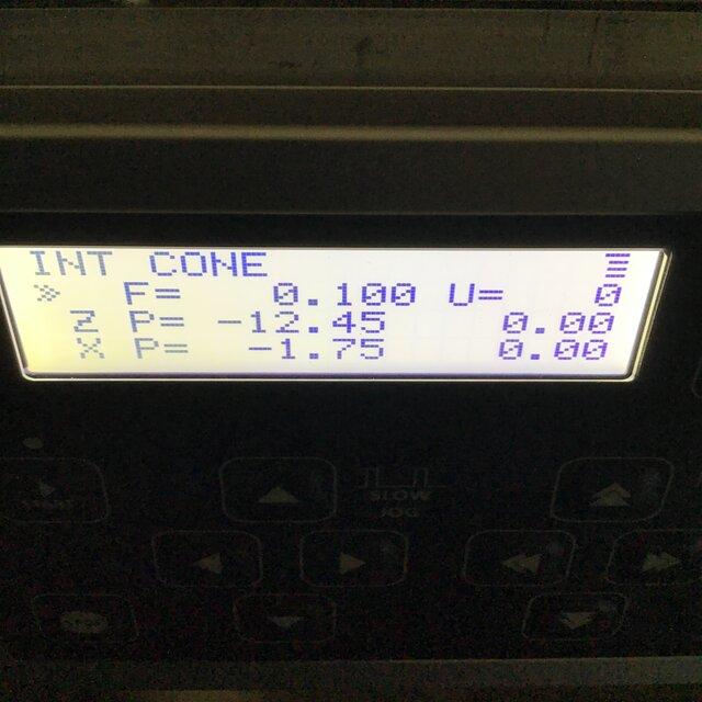

Z shouldn't be that important as long as the cone ratio can be set accurately. If you bore the arbor slightly bigger than 7.5mm and/or set Z a little longer it will just cut fresh air at the end of the cut.

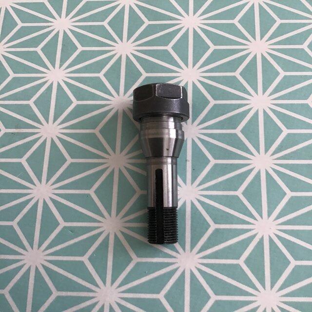

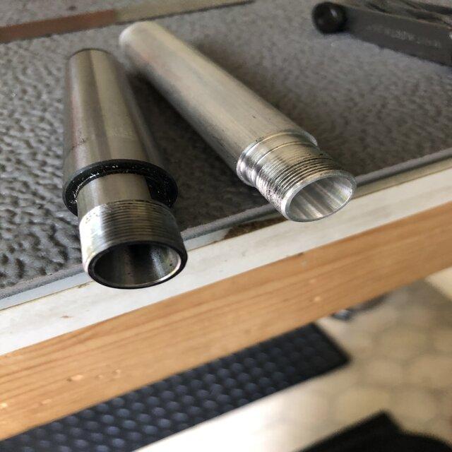

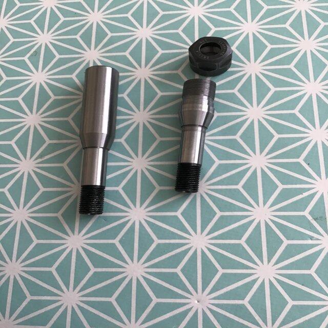

Thanks for all the replies and suggestions after making another one out of aluminium I decided to bite the bullet and make the proper one and I must say I am chuffed to bits with the outcome .
djc the math you posted went way over the top of my head.
as can be seen from pictures of the control I input 12.45 in -Z and 1.75 in -X but then I input 3.558 into cone ratio and it didn’t change the other settings so they must have been correct , for the thread M14 X .75 I turned down to 13.98mm and over 10 cuts I input .46 and after the 10 runs I just run the thread at same depth unto nothing was being removed and the nut is a very nice fit , upon checking runout I get  0.003mm so I am happy .

Dell,
An excellent result.
I do think though that the ZP and XP numbers could have been anything (within reason) and wouldn't affect the cone ratio which is what sets the 8 (or 16 degree inclusive) angle. The XP number will just give the large diameter and the ZP how much in Z it will cut the taper.
