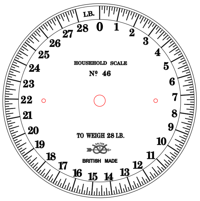

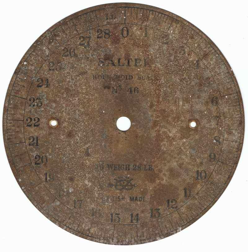

I've been restoring some old scales that came from my mother-in-laws shed. They were rather rusty so they've been dismantled, de-rusted, re-assembled, and painted in close to original colours.
All I have to do now is make a legible dial, which the original isn't.
I have redrawn the dial using a scan of the original to trace over.
 My original idea was to get someone to cut this out in vinyl for me and then use that to etch a brass dial.  However, after having redrawn the dial I think some of the detail is too fine for a vinyl cutter so I am wondering what to do.
I've thought of a number of options:
Print it on paper and cut an acrylic face to go over it.
Get it printed on sticky vinyl and stick it to the old face.
Get it laser engraved on brass deep enough to add paint and then clean up the brass leaving the markings visible.
I have no experience with laser engraving or cutting so I've no idea if the last option is even feasible, where to go or how much it would cost.
Does anyone have any other ideas, or advice on any of these?

« Reply #1 on: March 23, 2023, 02:11:00 PM »
Think of it as a printed circuit board. Photo print it onto transparent sheet, apply photo-resist to a nice clean brass disk and expose it through the transparency.
Then etch the brass disc - you may want to make a negative version of your artwork.

what is the original?

« Reply #5 on: March 24, 2023, 06:54:47 AM »
Phil, John - SALTER got left behind while I was moving it all to the middle of the page - thanks for pointing it out - I'd have been annoyed if I hadn't noticed it before I'd finished.
Phil, I could do something like yours - but I'm trying to make it fancy.  I have thought about doing a metric dial on the back of the imperial one.  Interestingly I found a picture of an original metric scale which was calibrated to 15 kilos (about 33 pounds) - I think they would just have adjusted the bar that goes through the spring to make the spring shorter.
Russ, the original was white paint on tin plate, with the design printed or stencilled on.
Andrew, that is a very good idea.  I had actually thought of that but dismissed it because I thought it would be difficult to get a printout without pinholes in the large white areas, but you prompted me to look again, and I discovered negative photoresist.  I've never done circuit boards like that - I generally use press'n'peel.  I will investigate further.

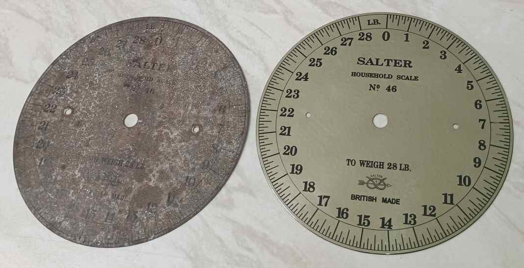

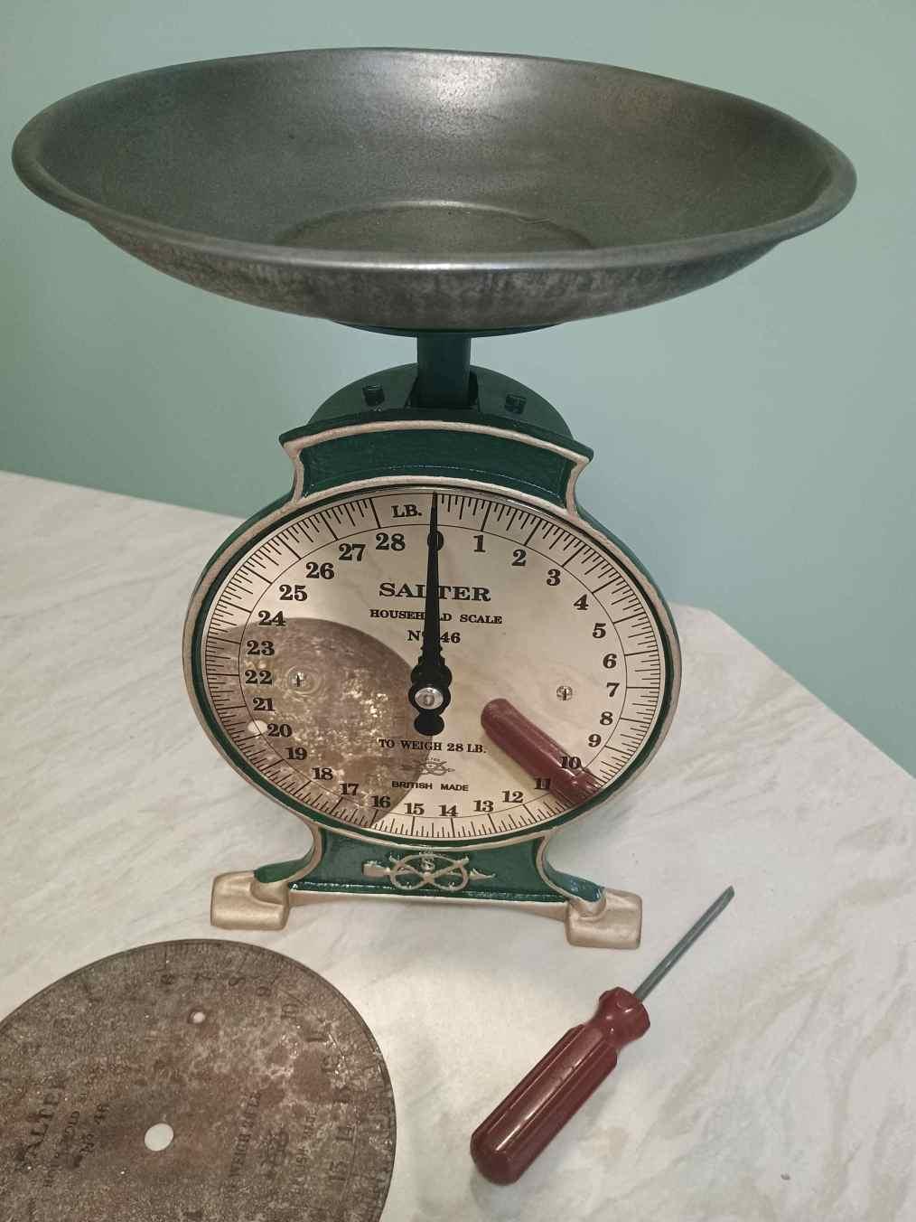

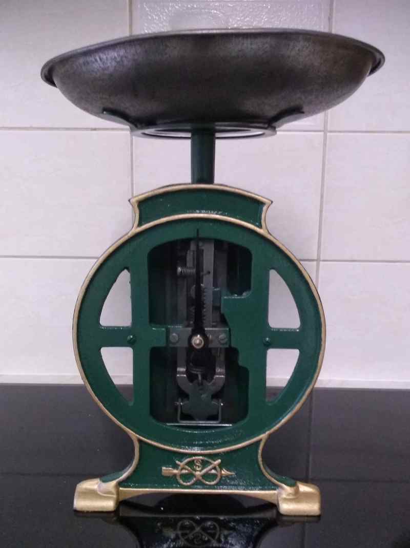

Hi All
Happy New Year!
It's amazing how projects can drag on isn't it. :med: :coffee:
Sometimes there are legitimate reasons, like waiting for materials, practicing a new technique, cleaning up previous attempts to try again, watching YouTube videos to learn the technique, avoiding exposing photosensitive stuff to brilliant sunshine, attempts to refine the UV exposure time, building a UV exposure platform, watching the YouTube videos again as you've forgotten what they said or it didn't work like they said :bang:.
Then there are the other reasons too, like having more important things to do, getting distracted by watching irrelevant YouTube videos, holidays, decorating, grass cutting and other family stuff.
However, I have at last finished this project.  I used dry photosensitive film intended for making circuit boards as Andrew suggested and I'm very pleased with the way it turned out.
Thanks again to Andrew for the suggestion.
Here are some pictures.

Beautiful job  :clap:
Re: Dial for old scales
« Reply #8 on: January 03, 2025, 01:30:23 PM »
Excellent result
