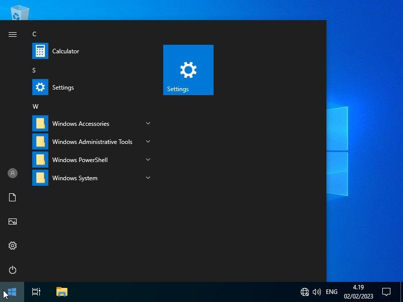

So far, as a result, start menu (although I don't like it much) is a lot cleaner, right after finishing the installing:

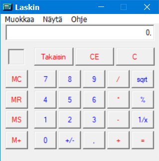

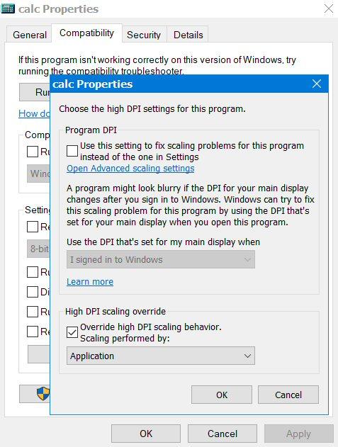

There's odd thing, that I noticed after installing W10 to my pc, after several hours of  fiddling with settings, my eyes began to feel like they were bleeding.
I have a monitor with max resolution 2560x1440. With W7, I've used 125% scaling, so text and other stuff are easier to see, and it has worked very well and display is 'crisp'.
But with W10, when using same resolution, same 125% scaling, there is certain 'blurriness' in some programs. And I'm not the only one, who has noted that. There are plenty of pages on the net, of how to "fix" that.
However, there is a simple a solution:
https://support.microsoft.com/en-us/windows/make-older-apps-or-programs-compatible-with-windows-783d6dd7-b439-bdb0-0490-54eea0f45938
There it says:
 Change the application's high-DPI scaling mode
In the High DPI scaling override area, select Override high DPI scaling behavior, and then try one of the following options:
    Application – Disable all Windows scaling settings and only use the app developer's setting. This option was called Disable display scaling on high DPI settings in previous versions of Windows.
    System – Overrides the program’s DPI settings and makes it run like it would on a low-DPI display. On a high-DPI display, this will make the program appear blurry.
    System (Enhanced) – Windows will try to use enhanced DPI scaling for this program. As a result, some programs will display with crisp text on high-DPI displays. This won't work for all programs.
So, by going to programs compatibility settings --> Change high DPI settings, and selecting  'Override high DPI scaling behavior' with 'Application' option seems to do the trick.
Comparison:
 [ You are not allowed to view this attachment ]    [ You are not allowed to view this attachment ]
I guess this has to be done separately to each program that has this issue.

Closer - but not quite there yet. There is something called Aero Lite, that's apparently "hidden" in Win10. It can be enabled though, but its default colors aren't that good(like too dark taskbar with black text).
Aerolite.theme -file doesn't seem to be included in W10, so I had to download it from the net.
Well it's always risky to do that, but it's just a text file, and I opened it in notepad in VM to see what's in there.
As I earlier wrote, I tested W10's high contrast themes to edit colors, but what might look ok in desktop, actually messes program's colors also(like Firefox), so I think I'll skip it altogether.
To me, Aero Lite looks better, and has borders on the windows. Modifying at least some of accent colors can be done with AccentPalette.
The end result maybe depends also on default windows- and default app mode(light or dark), havent tested it yet.
As can be seen in the pic, buttons in windows titles doesn't show at all, except on active window, and even then only the 'X' one.

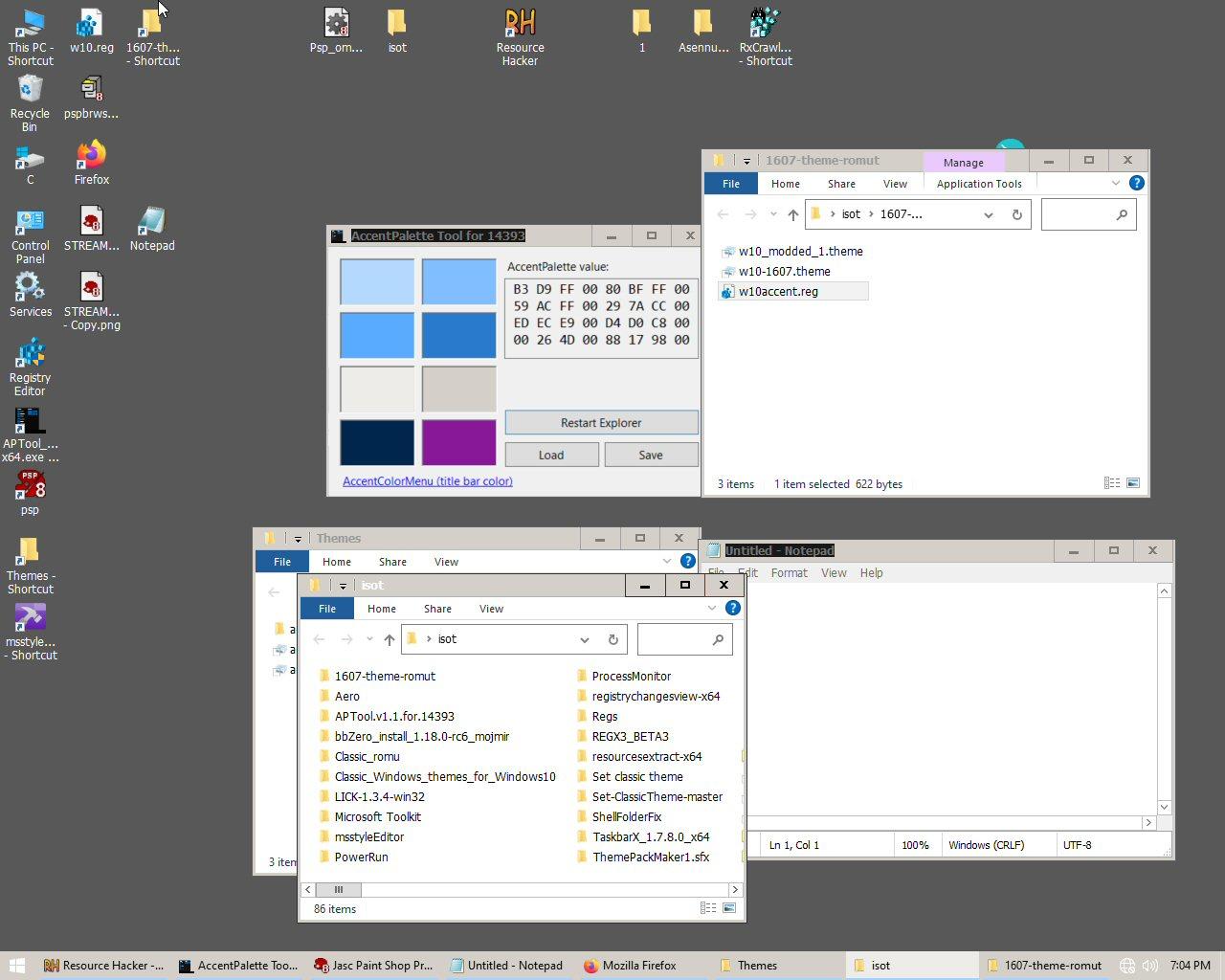

Just today, while looking possible locations in W10's registry for the colors, I noticed that windows' own registry editor's search doesn't show all the results(if any).
For example, I know that there is a certain value FF994D00 in following keys, when navigating in reg editor, which "are not found":
HKEY_LOCAL_MACHINE\SOFTWARE\Microsoft\Windows\CurrentVersion\SystemProtectedUserData\S-1-5-21-576976833-1637798910-2310749630-1001\AnyoneRead\Colors
HKEY_USERS\S-1-5-21-576976833-1637798910-2310749630-1001\SOFTWARE\Microsoft\Windows\CurrentVersion\Explorer\Accent
When exporting whole registry, and opened in notepad or whatever, those keys with that data can be found...
One free registry editor, that I'm testing, is 'ooregeditor', and it seems to be able to find 'hidden' keys: https://www.oo-software.com/en/ooregeditor
In some registry keys one has to add/take permission to edit; otherwise it's denied. It's just few steps, and easier than I thought.
While fiddling with different colors and settings, I managed to make W10's inactive title bars red(as it's easier to indicate if something has changed), no matter what theme I used, so I guess I managed to do something that was permanent - what it is, one can only guess, since I used msstyle editor and some other simple tools. I've been trying to reproduce it, but so far nothing.
Last but not least - about color formats used in registry: RGB, ARGB, BGR. And some are in hex form like one mentioned above.

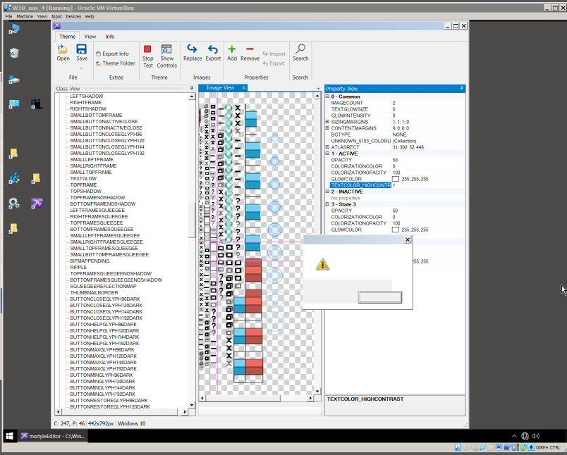

I've been looking for ways to locate the bitmaps used for window buttons(minimize, maximize and close), and it seems they are located in one bitmap in msstyles file.
By using Resource Hacker, one can see, extract and replace the bitmap(s): https://www.angusj.com/resourcehacker/
Yeah, there's a bit of a compromise - one have to use SecureUxTheme to enable third party(or just edited ones) themes: https://github.com/namazso/SecureUxTheme
It is said to be safer to use, as it doesn't modify system files.
Another one, that I haven't used, is UXTheme Patcher: https://uxthemepatcher.com/
Also, if one wants to experiment with windows' aero.msstyles or aerolite.msstyles files, as it's a system file, permission needs to be added to current user. That way the msstyles file can be moved to desktop or other temporary place for editing, because it can't be edited and saved in its original folder. It seems the msstyles file can be edited in its original folder; but only if the edited theme isn't in use.
Apparently there is not much info on the net, of how to interpret msstyles files. It's almost like an occult science, but still there seems to be plenty of people making fancy themes and skins, which they sell. Wonder where they have learned about such things. One place is DeviantArt, but even when registering there, the forum is rather restricted(I guess for new users): https://www.deviantart.com/
I'm not looking for something radical; just to change certain colors, or edit certain bitmaps to achieve that to make W10's gui more usable for old farts like me.
Little bit of testing - just by editing one msstyles' bitmap, it's possible to make the window buttons to have certain background color, that doesn't change much whether the window is active or inactive. It doesn't seem to affect apps like firefox and system setting, though.
Some colors are somewhat off. Might need more testing with other theme-related settings.
Current result with:
- edited msstyle bitmap,
- one key registry entry for taskbar color
- Accentpalette to change the highlighted window in taskbar(not sure what it's called). It seems to change startmenu color also.
« Last Edit: July 29, 2024, 11:43:39 AM by sorveltaja »

I've been playing with msstyles editor, and found something that still seems to be a part of W10. I have no idea what kind of mode it is, as it lasts only few seconds before W10 crashes and becomes totally unusable with black screen. Even rebooting doesn't help.
I was able to reproduce that to take a screen capture of the virtual machine:
It does that when opening aerolite.msstyles file in the editor, and deleting a few property keys, and clicking test button. So that's just the theme I'm looking for(and with extra feature, gradient window title bar!).
That's again one of those things, of which I have found practically nothing on the net. Or perhaps I haven't used right terms to look for it. 'Fallback' is a word I've used to search.
PS. I noticed after posting, that the image seems zoomed in/too large to fit in the page. It's about 1600 x 1200(resolution of the virtual machine plus vm borders). Is there a way to make it show in original size?
PS 2. I resized the image to fit better.

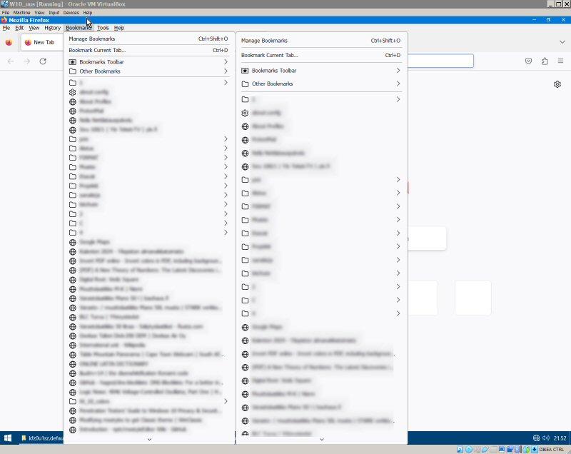

I use mainly firefox for web browsing, and noticed that in W10 it has huge spaces between items in bookmarks menu. I prefer it nice and tight, as it is in W7.
There appears to be no options in firefox's setting to adjust it, but still it seems to be possible. Comparison - on the left is modded and on the right is default menu item spacing:
I've tested this with esr (extended support release) versions of firefox 91.6.0 and 115.13.0.
It has to do with a file called userChrome.css. From what I've read, it can be used to modify many aspects in firefox user interface.
But in this case, someone has wrote a short snippet (which I've edited, as the default menu bar font 13 is way too big for my preference):
Code: [Select]
menupopup > menuitem, menupopup > menu {
padding-block: 0px !important; /*adjust: 0px-4px*/
min-height: 21px !important; /*adjust: 21px-24px or unset*/
*|*:root {--arrowpanel-menuitem-padding: 1px 8px !important;}
* Make all the default font sizes 13 pt:
font-size: 9pt !important
It can be saved as txt file, and then renamed to have .css extension. It has to be in a folder 'chrome', which can be created to desktop or other temporary place.
Then it's copied to C:\Users\<username>\AppData\Roaming\Mozilla\Firefox\Profiles\xxxxxxxx.default (x's are some random numbers and letters)
At this point it does nothing, and firefox has to be made to look for it when it starts.
It's done by writing in firefox's address bar "about:config" (without quotation marks) and then to search bar below:
toolkit.legacyUserProfileCustomizations.stylesheets - and set the value from false to true.
It can be undone, if needed - just delete the copied 'chrome' folder.
Some info about the subject: https://www.tenforums.com/browsers-email/183901-firefox-taming-beast-part-2-a.html

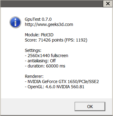

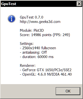

There appears to be a significant difference in OpenGL test results between W7 and W10. If the benchmark at https://www.geeks3d.com/gputest/ is to be trusted, W10 with latest Nvidia driver has a score of almost five times to W7 in one of its tests:
As can be seen, W7 has much older driver, as there aren't new drivers for it (haven't checked, which is the latest version, that would work in W7, though).
