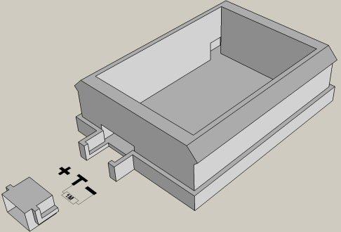

One suggested solution, that I found on the net, is to measure the resistance between fully charged battery's minus and "T"(thermistor perhaps) pads.
That's what I did (before disassembling the battery and making a 'dummy' version of it), and the resistance was about 10k. But in practice, connecting 10k resistor between those pads didn't work(at least in this model), resulting message "replace the battery" on a camera's screen.
It was time to test, what amount of resistance is enough. I used bench power supply with 8.1volts(that's what it says on the bottom of the cam) and several pots to see how the camera reacts to different resistance levels, and found that 1M(or maybe more) is, what seems to do the trick.
With 1M resistor the camera display shows that 'battery' is full.

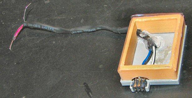

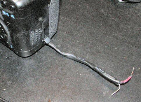

Dummy battery with printed top part. I used superglue with baking soda to make sure that the wires don't move around. The 1M resistor is inside shrink tubing:
So far so good, but I'll have to test some more to see if that solution actually works in the long run, as there may well be more undocumented sensors in these kinds of cameras, what comes to power supply.
