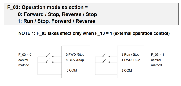

I have been reading through the manual for my inverter and came across a interesting operation mode option see pic, I currently have it wired in the first mode but the second mode will be much more useful, my reasoning being:
The speed control has limited use on the lathe as it has gears so a simple stop/start will do for that while the mill being direct drive needs the speed controller. So I can set up the forward/reverse switch close to the inverter and then put a simple start/stop on the lathe and a start/stop along with the speed control on the mill. This will also allow me to put a emergency stop in line on each machine.

...So I can set up the forward/reverse switch close to the inverter and then put a simple start/stop on the lathe...
That bit does not make sense to me. If you are screwcutting and want to reverse the lathe, you have to walk over to the VFD every time you want to change direction.

« Reply #9 on: July 10, 2022, 12:07:59 PM »
I will be screwcutting left handed threads with a diehead. I can single point (imperial) without changing lathe direction.

Yes it would be useful for that now you mention it but as its now just a simple spst switch it would be no bother to put a second one on the lathe because as Sea.dog says the vfd ramps down the speed before changing directions. I have been thinking only in relation to the problem I have right now (a lathe needing to run in reverse for LH threading with a diehead) and had not considered anything else.

It just happens that my fwd/rev switch has 3 positions and I find it useful if tapping a lot of parts to be able to just use the one switch for fwd/stop/reverse etc. I only have to press the start button once however many parts I'm tapping. Similarly if screwcutting an odd pitch where I can't disengage the half nut I can stop, withdraw the tool, and reverse all using the same switch. (The stop on this switch isn't the same as my my main stop switch - in the centre-off position it just doesn't tell the vfd which direction to run in.)
