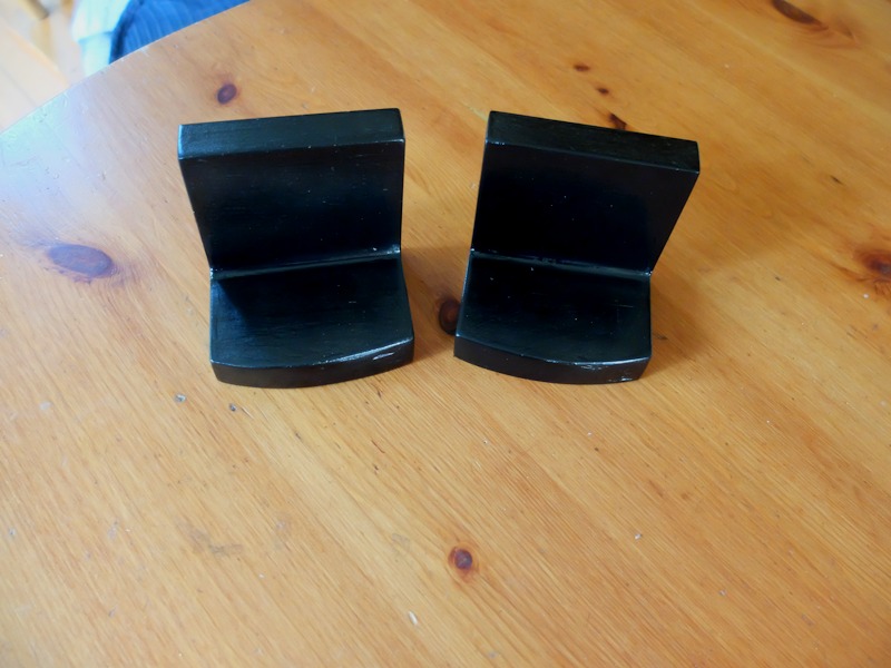

I built some patterns today for some solid cast angle plates for lathe faceplate work. They will be cast in aluminum to reduce weight, but are otherwise very substantial at 3/4" thick. They don't need webs. They do feature one radiused  edge of 4-1/2" to match the 9" swing of my lathe.
The first job of these plates on the lathe, will interestingly enough, be to machine square their own rough castings.

It's been a very long time since I've cast aluminum -- it's been iron, iron, iron this year since relining the oil furnace. It was a great pleasure therefore to do an aluminum pour this evening again. Very relaxing by comparison, and very quick to melt. I didn't have time before supper to cast both angle plates, but here is the first:

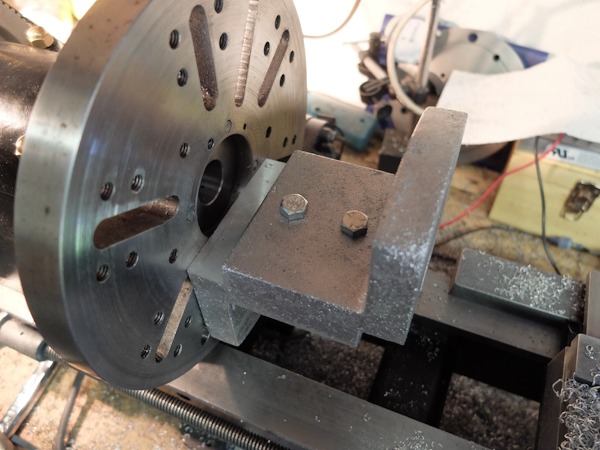

I cast a second plate just like the first. Then the first operation in machining the angle plates was to face off the longer leg of each plate. This was accomplished by using a length of pipe as furniture and bolting through the lathe faceplate.

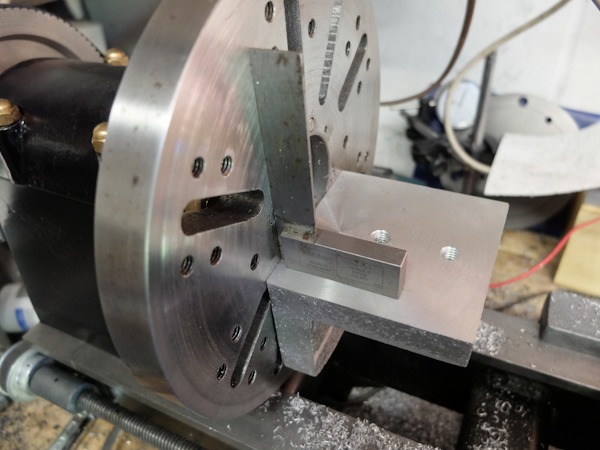

I then bolted the shorter un-machined leg to the faceplate. I added shims and checked with a machinist's square to ensure that it was standing at right angles to the faceplate.

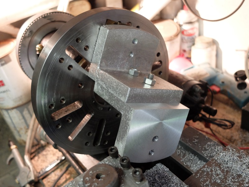

I then bolted the second angle plate to the first. Both machined faces together. This meant that the second angle plate's longer leg was also perpendicular to the faceplate.

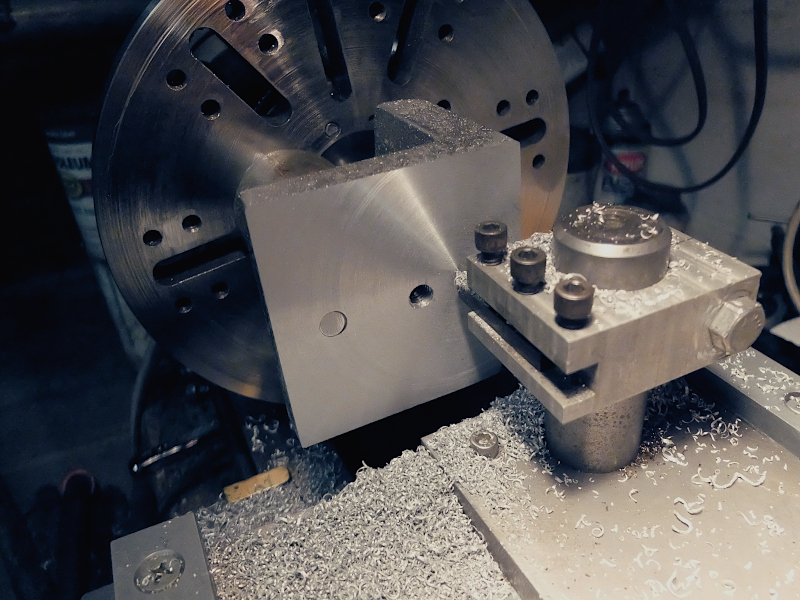

I then faced off the second angle plate's shorter leg. This made it perfectly square to its long leg. It was now a true 90 deg. angle plate.
By unbolting the whole assembly from the face plate and turning it around to re-bolt (without shims this time), the second angle plate could also be trued to 90 degrees.
Here is the first truing operation:

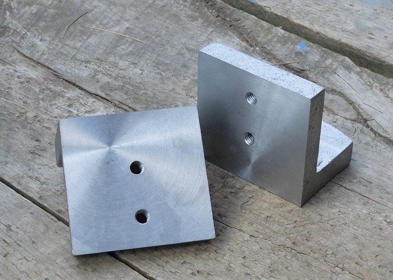

And here are the two finished angle plates, ready for use.  :dremel:
No mill, or mill setups needed. Quick easy and accurate. And yes, Virginia, a lathe can make square objects.
