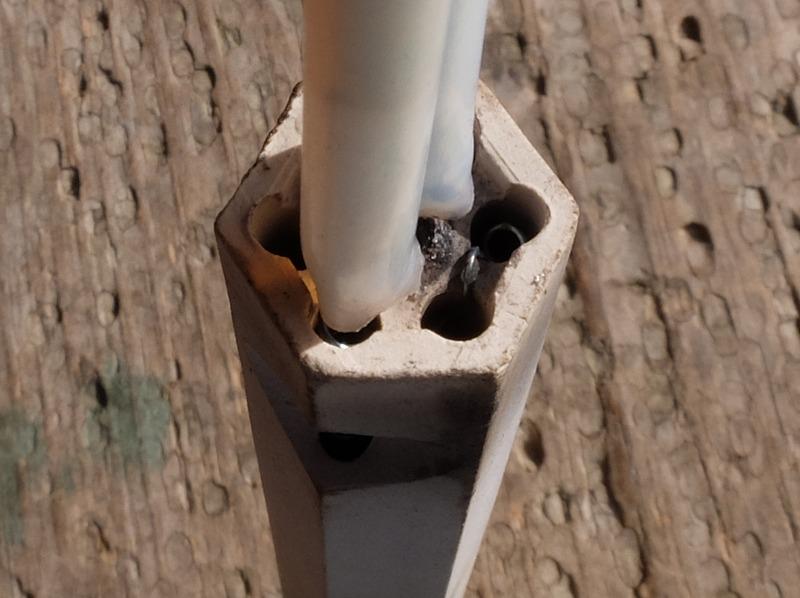

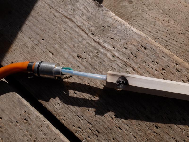

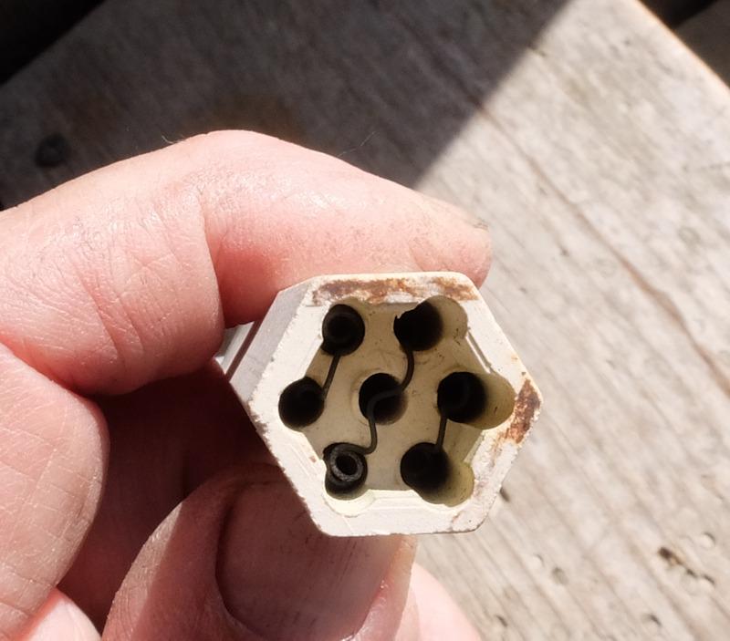

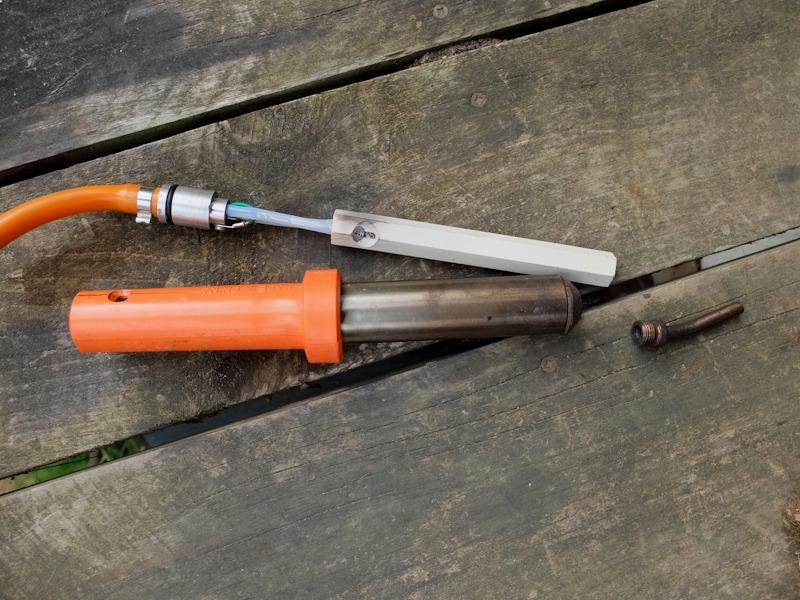

Asking for a little help on this one, an old HF Plastic Welder. It's the early type with just a wand, a hose and a pressure gauge that you are supposed to connect to a compressor, and a electrical cord to the wall. The wand receives both air and current and contains a ceramic element wound with resistance wire.
I've had it for at least ten years and carefully heeded the warnings to always turn on air first before connecting the cord, and always wait ten minutes after unplugging to turn off the air. But last time I used it, the compressor lost power, I didn't notice and the air ran out before I figured out what had happened. The welder stopped working.
I don't think spare parts are available -- the welder (of this type without a fan) hasn't been offered by HF in years. So I'm hoping for a MadModder style fix, if possible. Any help would be appreciated.
Here are some pics. They are respectively, overview, first side near end, second side near end, far end and cord end:

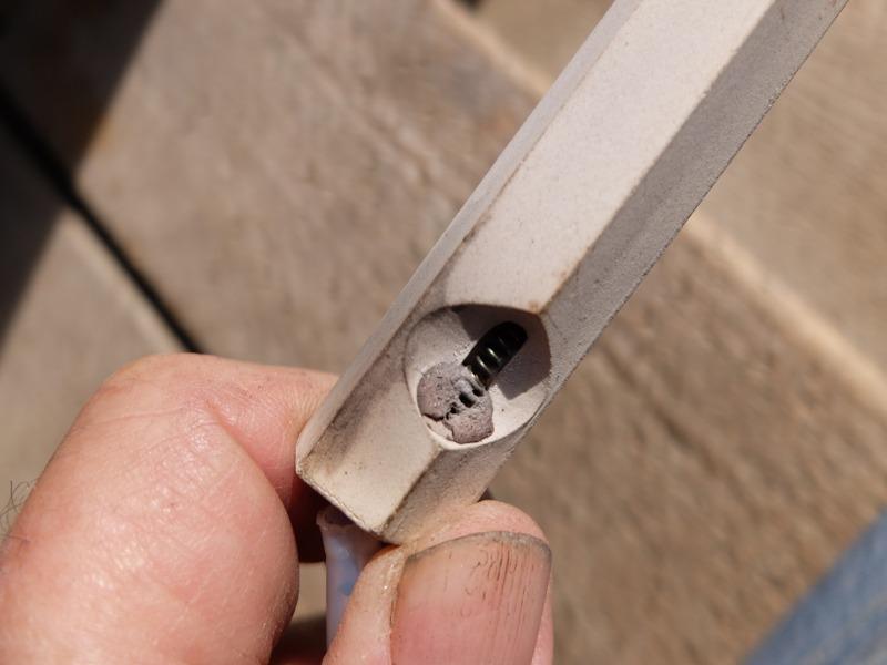

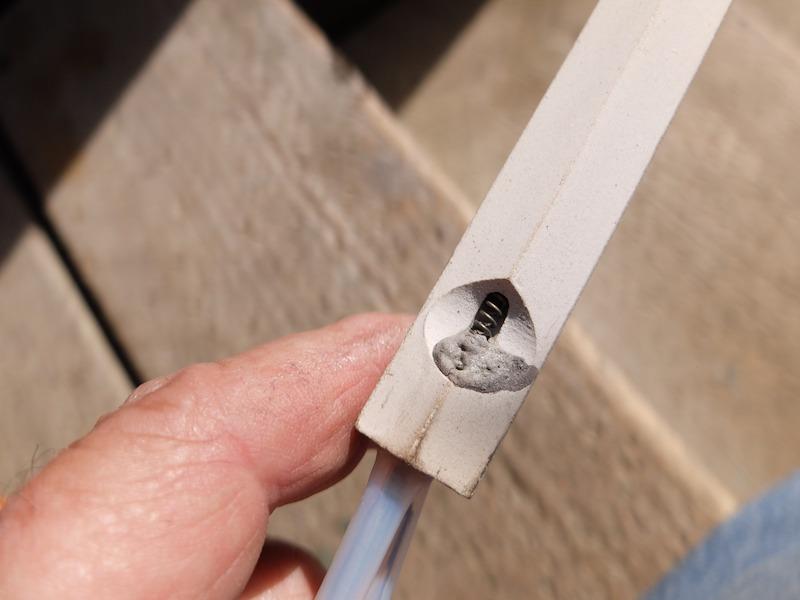

I've checked with an ohmmeter, and narrowed down the location of a break. There are 7 coils of resistance wire in 7 holes in the ceramic shell. They are all connected in series.
One of the incoming line terminals is presently connected to 2 of the coils, and the other is connected to the remaining 5. The break is somewhere in that second coil, and it isn't at either of the ends. So it's somewhere inside the second hole in the ceramic element.
Can that be repaired?

Steve, nichrome wire is available on the reel, The Scientific Wire Company carry it. Before it has been heated it can easily be formed into your coils round a suitable mandrel. Once heated it becomes very brittle so unwinding your coils is likely to end in tears, similarly rescuing wire from other appliances will be hard.
As a kid I made several attempts to scrounge nichrome wire from used 1 kw fire bars and was only successful when I was given a brand new one !
About the only practical way of terminating it is a mechanical joint such as a nut and bolt as the oxide layer prevents brazing. Soldering is obviously no use due to the running temperature. I did once manage to spot weld some to end tags using a lethal capacitor bank.

Here's a pic of all the pieces in the torch. This one is considerably simpler and more compact than more recent offerings in hot air plastic welders. New ones seem to have a built-in fan, Understandable because of the mistake/burn-out problem. But I prefer this simpler and more compact welder.
Its only need is a compressed air source. The actual air requirements are very low, and this unit came with an auxiliary 15 psi regulator (1 bar) for adjustment. If I recall correctly the actual welding pressure was around 2 psi, with the router controller turned down substantially for lower heat. Out of the box it was way too hot for clean welds.

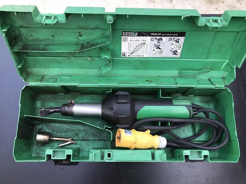

I have a Leister Triac Heat Gun that I bought at a boot fair at least 20 years ago  and it's still working. I first came across them when we had some industrial flooring laid at work and the contractor was welding the vinyl sheets together and it worked superbly.
Just a 'hair drier on steroids' - various diameter nozzles - variable speed air blower - quite controllable. Loads of used ones on ebay at very modest prices so not worth making one and messing with hand held mains devices in my view.
I also have a Chinese 'hot air gun' that is perfectly capable of melting plastics (including itself!) that I use for heat shrink tubing amongst other things.
Mending yours Steve: if you can isolate the broken coil and short it out and feed the rest with 6/7th of it's rated voltage (103 volts in your case) from a transformer you should be good to go.

It might be easier to use 5 out of 7 coils, as that way the connections would be at one end - although running a bare wire down the broken coil would be fine too.
