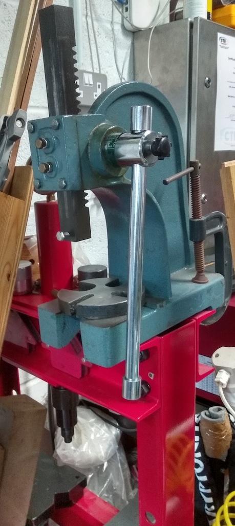

I have a 1 ton arbor press, had difficulty finding a home for it.  Then found the perfect place G clamped to the hydraulic press.  I don't use the big press that often but the arbor press is always used for forming and pressing small components I make here.   Flex not a problem, but shimming the ram and handle makes for a wobble free experience.  You can see beer can round the shaft.  The height is really handy too as it is near eye level, remember safety squints....  I make a large number of custom stainless snap rings.  The forming dies bolt into the ram and sit on the round table.  I have also 3D printed tooling for thin sheet metal forming.   A 1 ton press if you can make space for it, is a very useful bit of kit, more so if you don't need to bend down and use it...
Having it raised means you can also work on long shafts using strips of metal and threaded rod extending below the press.

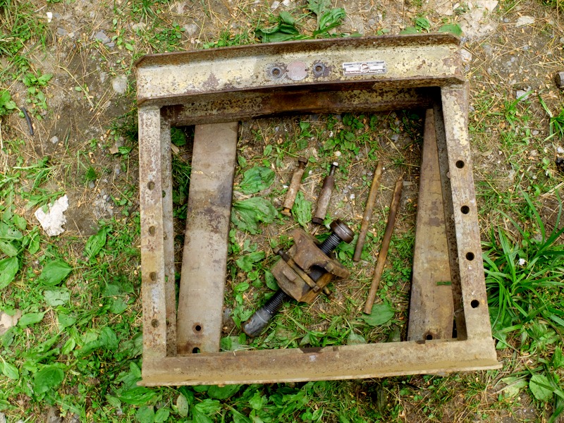

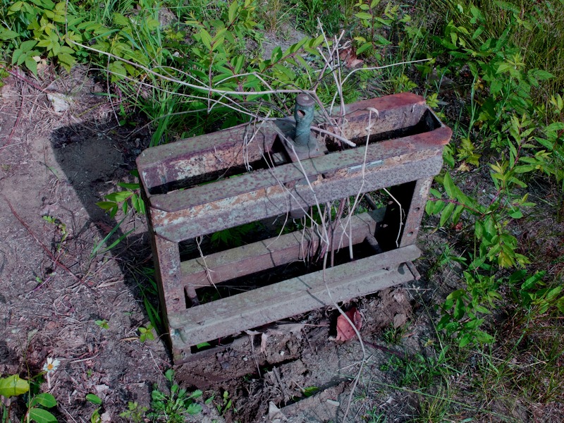

Well in the back of my mind this morning I kinda remembered that I might have had something near the back of the outdoor metal scrap pile........ and unearthed this:
Re: Small Press to fit in a Tiny shop?
« Reply #6 on: June 17, 2022, 09:36:56 AM »
The screw even turns -- there's still grease on the threads!
Drawbacks, though.... It's bigger than I had hoped for, and to turn the screw it would HAVE to be bolted to the bench (I'm lucky to have a free square foot on it for projects).
Maybe add a bottle jack ( I have a bunch of them in various states of usability) and cut it down in size? A hydraulic jack would mean it wouldn't have to be bolted down, therefore stowable.
But seeing as this is probably a fairly rare (now) Atlas emblem intact press, should I?
I should give you the size, since it's probably hard to judge scale -- heading out with tape measure......
Frame is 21" x  21" x 6"     Screw is 1" x 8 TPI

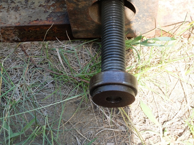

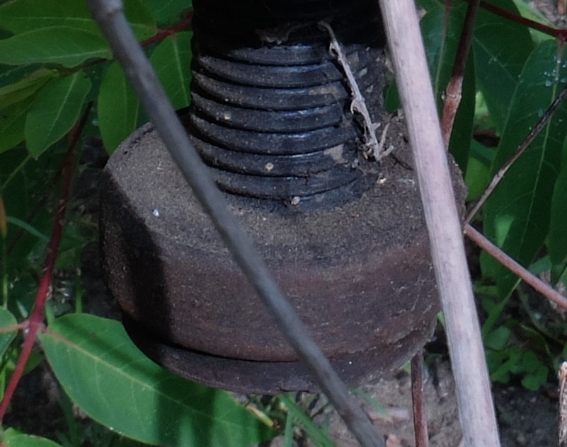

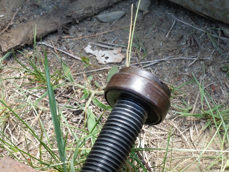

BTW.... does any one know what this is at the bottom of the screw? Looks like a ball bearing race. Doesn't turn however (frozen, or not a bearing?)
At first guess I thought it might some type of swivel foot, like on the screw of a C clamp, so that turning pressure wouldn't be applied to the part being pressed.
But would a ball bearing make sense for that? and how would the shaft work with that? It would seem to need to be a two piece shaft, separated by the bearing. Also could aa ball bearing take the pressure? Doesn't seem to me to make much sense.
Or, is it just a ball bearing that somehow got stuck on the press arbor, and no one ever took it off before getting rid of the press?

I added an adjustable extension to my tiny press to deal with 12" long broaches.  Super happy with the result!!!

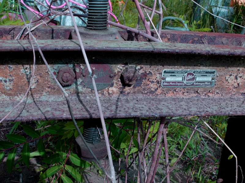

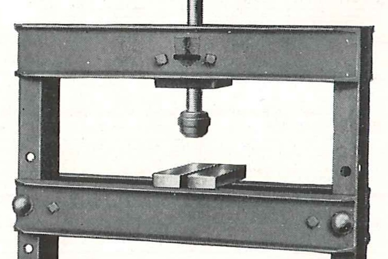

After a whole lot of fruitless searching I finally found a reference to my press, and it's a catalog description and picture! :thumbup:
So that really is a thrust ball bearing on the arbor. Maybe I can free it.

I guess they did Tom, and it only cost $16.50 new! I actually haven't seen it in their general catalog that included the shaper, horizontal mill, lathes etc. No idea when it was made.
I was able to free the thrust bearing quite easily with just a squirt of WD-40 and turning with pliers. Since there's no apparent way of opening it or getting grease in, I decided to just flush it out with spray brake cleaner by filling it, spinning it, and wiping off the dirty fluid. Repeated about a half dozen times. Then I flooded it with motor oil.
It spins easily, though no telling how long it will last in use. Not sure how I could ever replace it. I did find a thrust bearing online that was the same outer diameter (1-57/64")  as the one on the press ( the found bearing is an RBC Nice 608-V) --  but no telling what dimensions the press' screw shaft is turned to inside the bearing, so no idea what the bearing IDs are. And no idea how that bearing is fixed to the arbor either. The arbor seems to flare out wider than the bearing case past the bearing -- I don't know if that is a separate part, or part of a special purpose bearing.
Also the RBC bearing is rated at about 1500 lbs at 10 RPM, while the press is called "a 10 Ton Press".  I'd be frankly surprised if it could hold 10 tons judging by the pins that hold the table part in place -- and the slight upward bend in the top of the frame.

I'm going to just fix up the Atlas press and keep it as-is. We'll make covered space for it, one way or another.
It's missing a handle, and one of those thick bottom support plates. Wish I knew what the original looked like, as long as we're restoring this thing.
I could cast it in iron or maybe weld two steel thicknesses together. Any preferred patterns for these out there, guys? Some have different sized open slots. Pics of your own setup?
I do wonder whether slotted iron is a good idea, I guess if it's thick enough.......

Enlargement of the ad......ad says two 7" x 1-3/4" x 3/4" blocks are supplied......wonder why the blocks appear to be serrated?
Also, the ad shows the end of the bearing with a tapered end. Mine is shorter, no taper. I wonder if someone cut the taper off because they were regularly pressing something wider.:

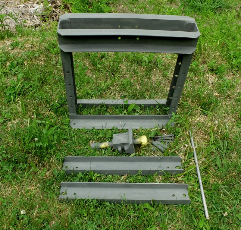

The Atlas P10 press apart:

WeldingRod, that is a nice setup, much better than my angle iron and studding.  I should have a look at what plate I have stashed.

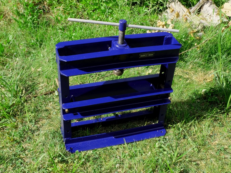

I spent a couple hours today sanding and wire-brushing the Atlas press. I also got a coat of primer on it, but it's starting to look like rain, so cover paint may have to wait.
Oh, I also cut an 18" piece of rod for a handle. I don't have any tool steel that length, so I hope it will be tough enough. If not, I'll replace it down the road.
Camera has created an exaggerated upper bearer bend in the pic below -- it's actually only about 1/16" over 21" and it doesn't bend inboard at all.
I think that is just the picture after looking at the other edges in the pic.

I don't know, Tom. I think I see threads on the screw, and they are even smaller. Not sure.........maybe there's some reason for it.
I was able to paint the press today and now it seems like a real tool!  :dremel:

Is it just the pictures or are the two top channels bent up a little?
« Reply #25 on: June 23, 2022, 06:32:22 PM »
Dwayne, they are bent up slightly, but nothing like the pics, due to wide angle lens..
