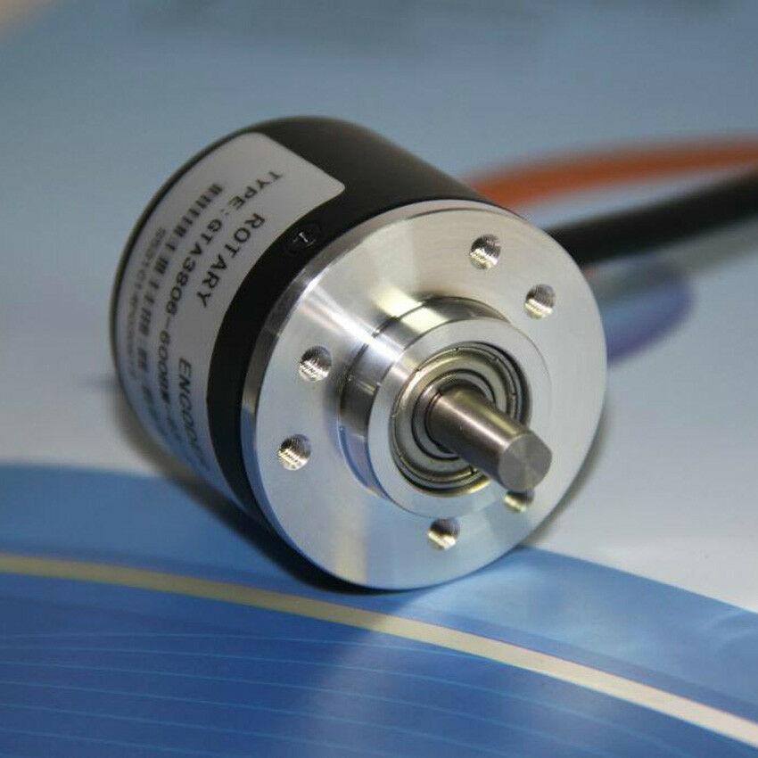

https://www.ebay.com/itm/125254761523?hash=item1d29c3fc33:g:K8YAAOSwZbVcCOel
12 bucks, plus shipping......

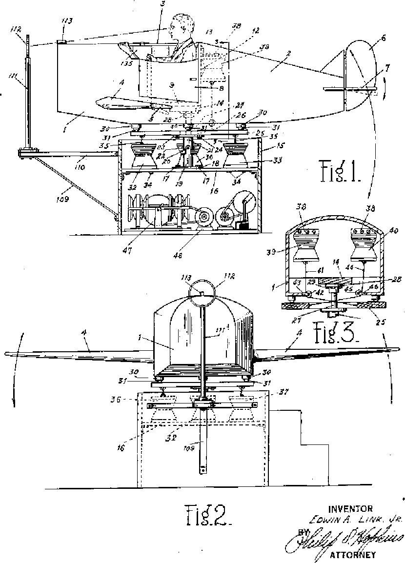

The real thing:

vtsteam, I have spent a few bux on those encoder devices already and they sure make construction of an anemometer a real breez but of course one must use an absolute one for direction and incremental for the speed, or at least that's the way I do it.

I assume that is Mr Link's patent drawing?  What a wonder grew from simple beginnings!

Looking at those pictures I think that appropriate approach for the cockpit attitude measurement depends on mount to a great extent.
If there are orthogonal bearings (axises) simple absolute position rotary encoders (or even with pulse encoders with "neutral" limit switches) look attractive.
If there is a universal joint, resolving three axises and derivating acceleration out of it becomes challenging.
This friend of mine looked up interweb and found new version of the sensor that is a whole lot more easy to calibrate. This video relates to it, I don't know if that software is available or he just cobled up something for fun....anyway nice to see how responsive the signal is.
