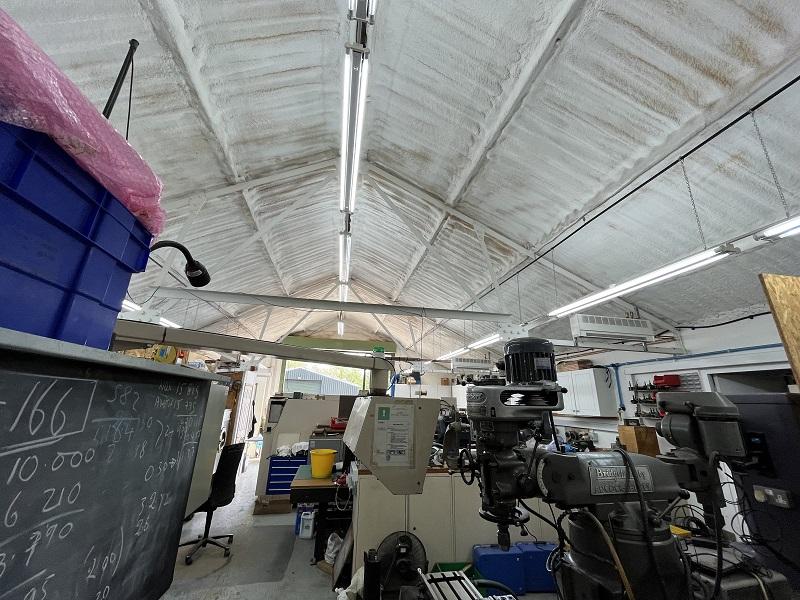

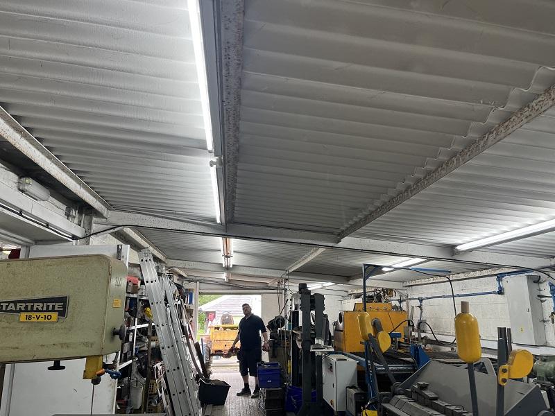

Today I replaced twelve 6 foot T8 70 watt fluorescent tubes with LED replacements. I have a total of 36 of the 6 foot tubes in the main workshop giving 2500 watts so with electricity having gone up to 29.49 p per kwH this was costing 75 pence per hour just to light - never mind actually using any machines ! My electricity for the workshop had been running at £8 per day (inc standing charge) so something HAD to be done.
The twelve that I have changed were a pilot exercise to check light quality etc, not a cheap exercise though at north of £150 for the LED tubes. If I can scrape any spare cash together I'll certainly do the other 24 as they are pretty good, and apart from access issues over machines were very easy to do - just replace the starter with a 'special' which actually is just a short circuit - then put the new tube in.
These ones are 24 watt so a saving of 66%
The welding shop foundry and woodwork shop probably have another at least 36 tubes between them which is why I've been putting it off - darn expensive this saving money lark!

Yes Russell I have it wired in 'three banks' originally to distribute the load across three  6 amp MCBs each with their own three switches giving switching individually per group of four lights. (Big grid switch by the door)
The bank that I've done is the crucial one - it covers sink, loo, my desk, bench, and the CNC milling machine so that bank can remain one while the other three are in gloom !
Amusingly for some time I've had one tube that for the life of me couldn't get to strike up. and I was convinced that the ballast choke must be O/C - today I even dismantled the fitting to measure the choke (which was fine) only to find one pin on the original fluorescent tube  bent over at 90 degrees  :bang:

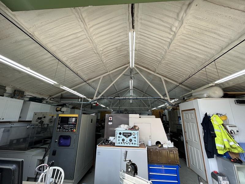

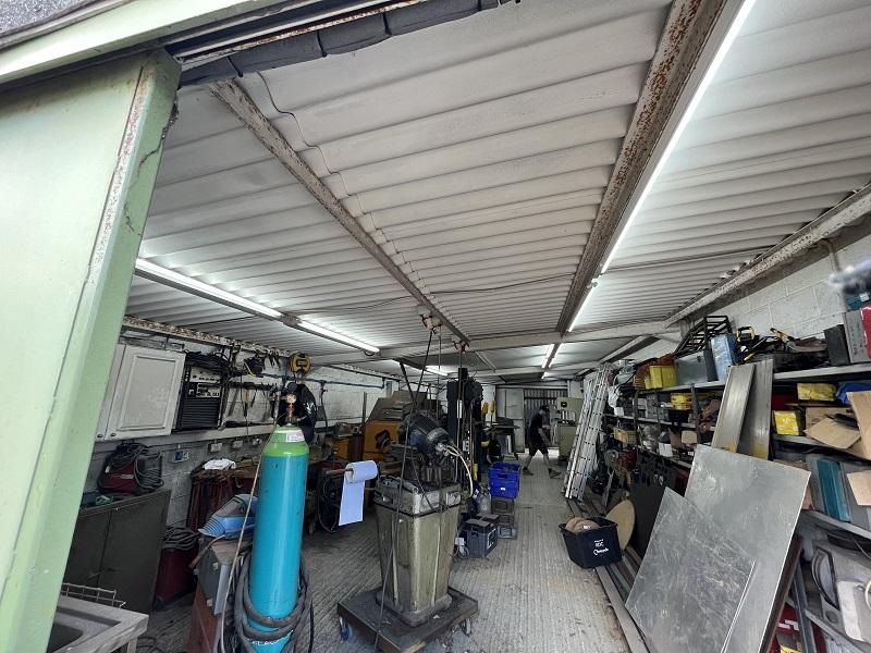

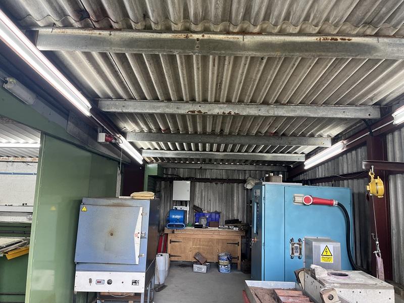

Yesterday I replaced the remaining 24 tubes in the main workshop - some amazingly inaccessible over various machines - in fact the four that span over the Beaver CNC lathe one needed to walk on top of the machine enclosure. To my great surprise the wife volunteered which probably a very good thing as she must weigh about half of what I do !
. . . only another 41 to go in various other outbuildings and workshops but in all likelihood I'll leave them as they are 'occasional use' only.

Andrew how is the light level? Does it feel brighter in there now?
Re: Electricity getting very expensive in the Workshop
« Reply #22 on: May 01, 2022, 12:16:42 PM »
Yes very much so Steve for several reasons I think:
A/ The LEDs are actually brighter
B/ Although most of the fluorescents were less than a couple of years old a significant few weren't
C/ The fluorescent tube were pretty grimy so not allowing all the light out
D/ I was greatly inhibited from turning on lights, putting up with a bit of gloom. But much less so now!

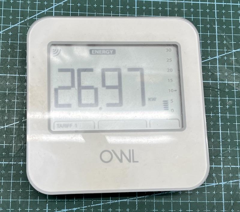

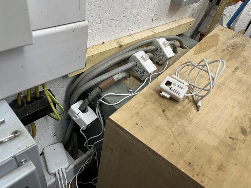

« Reply #25 on: May 12, 2022, 03:14:04 PM »

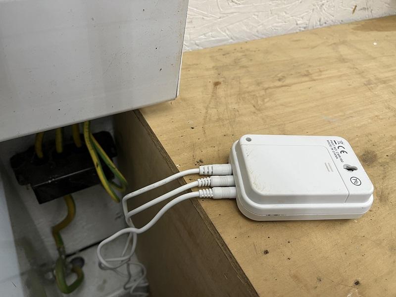

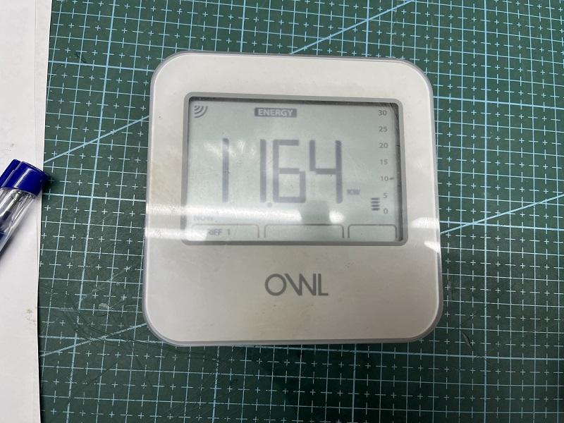

As part of my 'Electricity Reduction Exercise' I wanted to fit an 'Owl' real time monitor to my incoming three phase supply. I'd bought the monitor on eBay some time ago and knew that it worked however it's sensing current transformers that clip round the cable were too small for this massive cable. These are 70 mm csa / 225 amp rated and about 16.5 mm o/d . The sensors that I had would only accept up to 11 mm o/d.
Well it turns out Owl do make a suitable sensor but they are far from common. As luck would have it, trawling eBay produced two used ones and one brand new one that arrived today.
I've fitted them after a bit of a struggle wrangling the cables to get sufficient separation to clip the devices on.
As part of the testing I wanted a decent three phase load, so I thought that I'd run the spindle motor on the Beaver CNC lathe. A nice steady 1000 rpm, no load on it and it was drawing 30 kW  :bugeye: Now the motor is rated at 26.5 kW so the remaining 3.5 kW must be the servo system, hydraulic pump etc.
Now OK it's a big beefy motor but with electricity at the price it now is that's practically £1 an hour just to spin the blooming motor  :bang:
. . . . . not going to be leaving that idling to warm up in the future  !

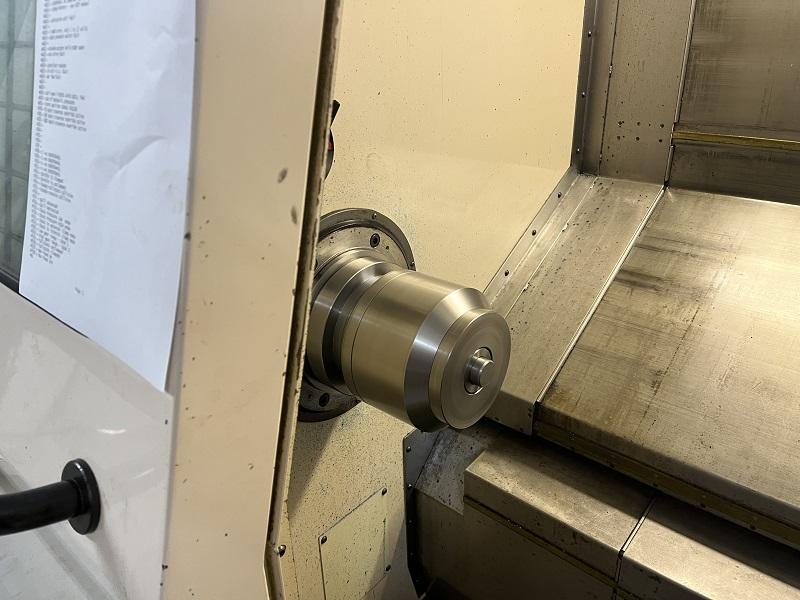

« Reply #28 on: May 13, 2022, 05:19:34 AM »

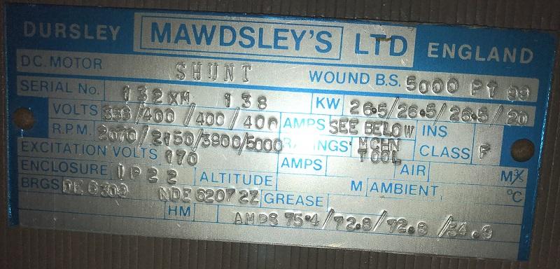

Well you wouldn't think I got the Maths prize at school all those years ago - that lathe motor calculation is out by a factor of ten!
30 kW at 29.48 pence per kwH is 30 x 29.49 / 100 = £8.847 per hour  :bugeye:
Dare I ever turn it on again !
(oddly this morning it's drawing 26.97 kw not 30   :scratch: )
Offline WeldingRod
  • Posts: 401
« Reply #29 on: May 13, 2022, 10:26:01 AM »
That sounds really -wrong-.  A spindle motor drawing full power with no load???  It should be maybe 3kW!  If it is a three phase motor rather than a vfd you might be seeing reactive power rather than real power.  Or your spindle brake is on   A simple rectifier input VFD will have horrid harmonics that will totally flummox cheap power measurement chips...
If you've got an IR gun or camera you might look at the motor or cables.  30 kW going into any of that will make stuff hot PDQ!
Um, now that i think more, I bet your current transformer ratio is off by ten!
Do you have any dumb three phase heaters you could turn on?
« Reply #30 on: May 13, 2022, 11:39:17 AM »
The motor is a DC Mawdsley one . It has a 1.5 HP cooling fan blowing into it all the time.
Current consumption of other devices seems sensible - certainly not out by a factor of ten
« Reply #31 on: May 13, 2022, 11:41:15 AM »
26.97 KW = 36 Hp.  :jaw:
It can't really take that much to spin a ground shaft in precision bearings.
« Reply #32 on: May 13, 2022, 11:44:41 AM »
OK it's spinning the gear train as well but I agree to being surprised.
It's rated at 26.5 HP 400 volts and  34 to 75 amps DC depending on speed with 170 volts on the field coils whose current is separately controlled  - plate below

Andrew are they the appropriate senders for that monitor? Does the monitor have internal settings for different model senders/transducers? Do the two used transducers check out?
I have depth sounders that take same brand transducers. BUT, you have to go into settings to change to the model number transducer. I don't own an OWL, so I have no way of knowing, simply asking questions that occur.
« Reply #37 on: May 13, 2022, 12:21:38 PM »
The transmitter unit takes in the coil connections from the three phases and Owl seem to only sell two varieties, examples of both of which I have. There is no setting up on the transmitter but as I  say the readings seem sensible with other loads.
I'll try it with the Kiln when I go over and feed the pigs in a minute

Well, as was said earlier, all that power is eventually going into heat. You have a 27 killowatt heater running if somehow this power reading isn't wrong. So are you seeing 92,000 BTU/hr in the vicinity?
« Reply #39 on: May 13, 2022, 01:03:31 PM »
Pigs fed and kiln power measured. It's rated or at least plated, at 13.5 kW three phase. From a base load of about 2kW the power used jumped up to 14.4 kW.
So I reckon the Owl monitor, though not calibrated to NPL standards, is giving a pretty fair indication of power used.
Now the machine drives the Mawdsley DC motor using a KDK DC drive with its associated blower cooling. Attached the to KDK drive is a Field Driver that I have actually added a fan to as it's output Thyristor used to run unacceptably hot. The main motor has as I previously mentioned it's own external cooling fan (750 watts NOT 1.5 kW as I had thought).
So energy as heat is being extracted all over the place and yes it does warm the workshop in a nice but expensive way!
I am as puzzled as others regarding the fact that the consumption is so high unloaded - the motor does not over heat by the way.
. . . I think the readings on the Owl monitor are roughly correct
I'll try and get some readings with the Beaver powered up and ready to rock but without the motor spinning - I suspect the various other elements gobble up quite a few electrons.

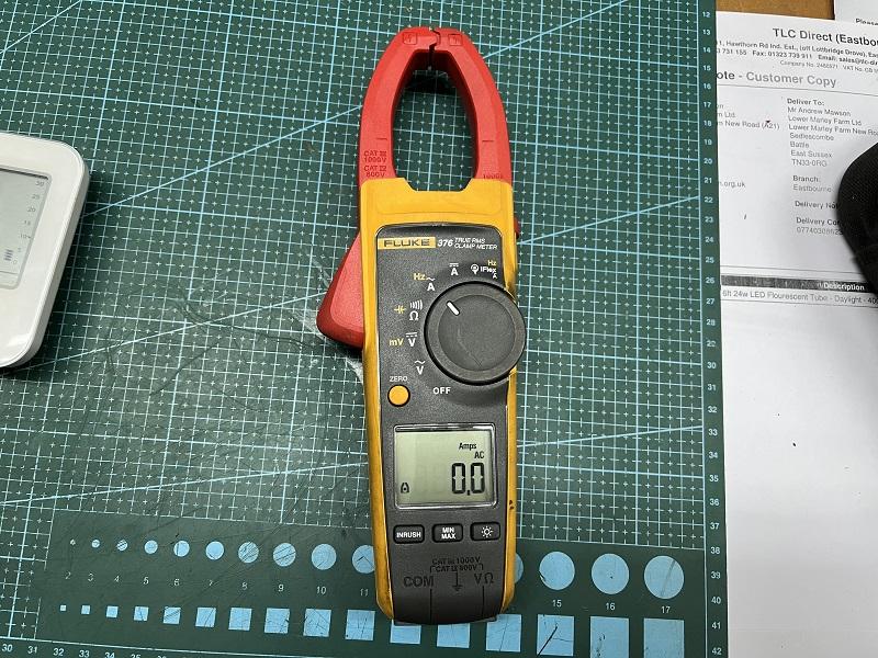

Can you get a tong tester round the input phases and get a current reading for each phase?
« Reply #42 on: May 13, 2022, 05:11:15 PM »
Probably Phil. I certainly used to have at least three Ferranti clamp amp metres - certainly still have one but may have given the others away over the years.

Now this is getting REALLY curious - I don't quite understand what is happening.
Running the machine up to the point that the motor can be started under program control, but NOT running, the OWL is telling me it's drawing about 3kw which is not unexpected.
Starting the motor and running it at a steady 1000 rpm at the spindle (through a belt / gear train so not motor rpm) my Fluke clamp ammeter is showing approx 16, 17, and 18 amps on the three phase inputs to the machine.
Now the OWL is showing about 11 kw attributable to the Beaver lathe (other things drawing a few 100 watts)
Now under these circumstances the other day it was drawing 26 kw, and I'm not imagining it as I have the photographs !
So I don't  really understand what is going on  :scratch:

Absolutely nothing was changed on the OWL settings, and anyway it shows sensible consumption when the 13.5 kW kiln is turned on so I don't think it's that Steve.
It make absolutely no logical sense to me at the moment. Even the 11 kW seems awfully high just spinning an unloaded motor.
One thing that DOES tally  up is the 16 /17 / 18 amps draw on the 415 volt three phase input to the Beaver equates to about 11 kW power again confirming that the OWL is telling the truth.
Incidentally, in the past I have checked the Fluke clamp meter against my trusty Avo 8 multimeter and they correspond exactly.

No telling how the Owl factors that in. It isn't something it allows you to set. And just making one assumption for everything could yield wildly differing results. If it uses a dynamic estimation internally, maybe it senses whether an inductive load is connected vs rectifier (as also mentioned earlier by Welding Rod). Maybe it estimated a different power factor for the two measurement samples?
It's basically just a clip on ammeter with internal calculations to yield power/energy usage. How it handles power factor is unknown.

Actually, Andrew, your Fluke ammeter will allow you to estimate power factor -- and energy consumption without the convenience of the owl, of course. But where they disagree, I'd trust the old meter and your personal calculations.

But Steve the odd thing is that I set up EXACTLY the same measuring conditions on the two occasions.
. . . no change to the Owl or it's sensors and transmitter - they weren't even moved
. . . no change to the Beaver Lathe whatsoever - in each case it was turned on, passed over it's references in X & Z, then the motor started with an S1000 M03 command to spin clockwise at 1000 rpm
Yesterday 26 kW . . . today 11kW . . . . it makes no sense whatsoever :scratch:
(But today I WAS able to corroborate the 11kW using the clamp meter)

So a year on I decided to change a further 28 fluoresent tube for LEDs but before I spent the approx £350 something told me to confirm that the original change HAD actually reduced power consumption, and I found that it HADN'T  :bugeye: :bugeye: :bugeye: :bugeye:
A major investigation ensued detailed here :
https://www.mig-welding.co.uk/forum/threads/questionable-florescent-led-replacement-efficiency.128634/
In summary the consumption of 70 watt tubes replaced by 24 watt tubes had INCREASED to 80 watts. Contrary to the manufacturers instructions it was essential to remove the capacitor which was the major consumer, and to a lesser extent the ballast which was an order of magnitude less of a culprit. With both removed a 24 watt tube actually consumes - guess what - 24 watts  :lol:
Much shilly shallying about and 'interesting' conversations with the supplier (TLC Electrical) and the importer over several weeks resulted in two electricians coming here today to delete all capacitors and ballasts in my workshop at the importers cost
Pleased to say NOW main workshop is drawing 808.4 watts (was 2773)
While they were here I got the sparks to replace the 28 tubes in the welding shop and foundry with further tubes that I had bought, and they removed the capacitors and ballasts here as well - more power reduction. They now draw 600 watts (was 2279)
It's been a long drawn out issue but I'm glad to say it's now been resolved largely to my satisfaction. I got a very minor reduction in the price of the 28 extra tubes (to £10 + VAT per tube) and the electricians for a day but not compensation for the extra power drawn in the main workshop for the year that the tubes have been installed. No doubt if I'd gone down the 'Trading Standards' route I would have achieved that and more but life is too short.Meanwhile TLC have made alterations to the claims on their web site regarding power reduction (in fact they've had to reword it twice as I pointed out errors in their first re-write!)
. . . hey ho . . .
