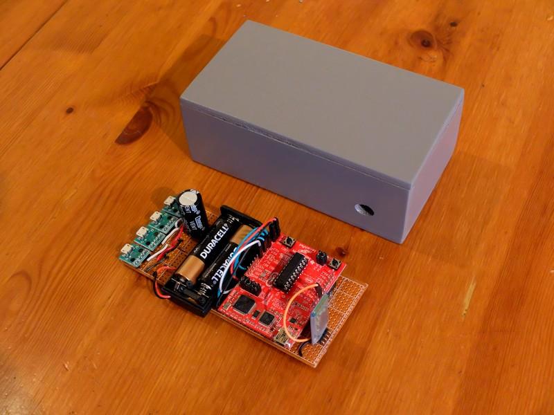

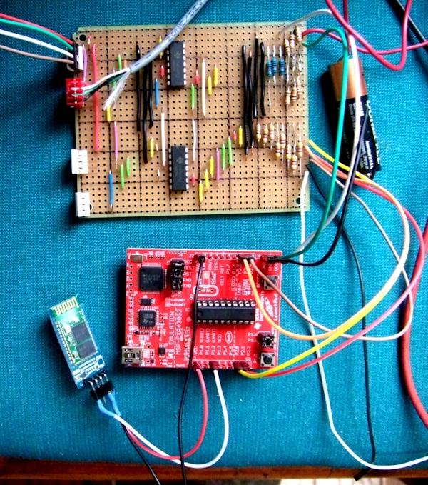

A few years ago I started a project building a low cost bluetooth DRO using a mix of inexpensive digital calipers and an IGaging  scale using plans and instructions found on Yuriy's Toys website. It was a pretty complicated project, mainly because the calipers needed a big hand wired adapter board to interface with a small Texas Instruments controller board.
I built and tested the system, but never got around to mounting it on a machine. One of the calipers was unreliable, and I didn't have much more money to invest in the project.

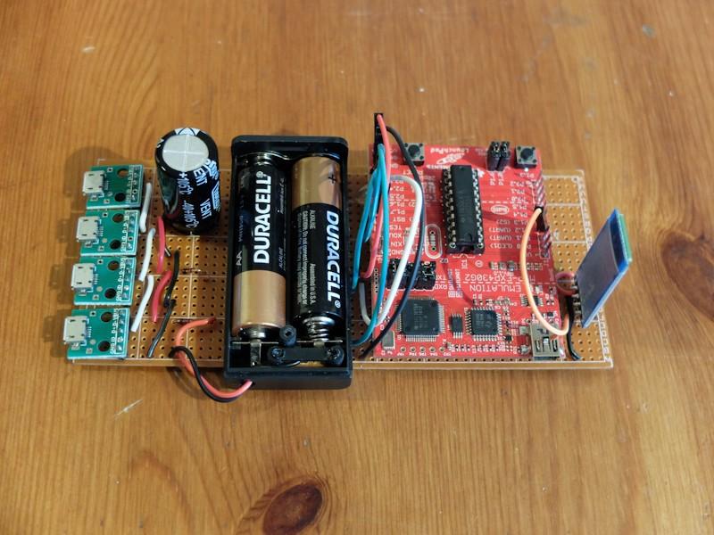

A couple years ago, when the prices came down, I bought 3 IGaging capacitative scale units, intending to use them as-is, but again, never mounted them on a machine. Fast forward to yesterday, while working on the mill I got irritated trying to read the dials in low light and fighting backlash, I decided then and there to build and add a DRO, but this time, to use both the new scales and parts from the old controller project, but without the caliper adapter board.
So I put together this unit. It has the TI processor board, 4 micro USB ports for X, Y, and Z scales and a rotary encoder. The scales have a backup battery of 2 AA cells, which should provide 2500 hours before needing replacement.
The bluetooth connection is provided by an HC-06 breakout board on the right side of the unit. There are two Shotky diodes between the battery and the onboard USB power supply input to prevent battery charging or backfeeding the battery power to the processor board. Batteries only power the scales which draw 17 uamps. A 2200 ufd capacitor maintains the power during transition between usb power source and battery power to the scales. All of this is detailed on the Yuriy's Toys site
For my own preference, I mounted everything on a vectorboard and cut and wired  traces by hand to reduce the number of jumpers. I did keep some jumpers in order to make the system flexible in case I want to change the port assignments and inputs.
I tested it out tonight and it works great with the Igaging scales and an old tablet I have. The Android software for the display is called TouchDRO. It also works with my cell phone.
The first photo below shows the older mixed caliper and scales project while being worked on.
The second photo is the new DRO project which works with the Igaging scales.

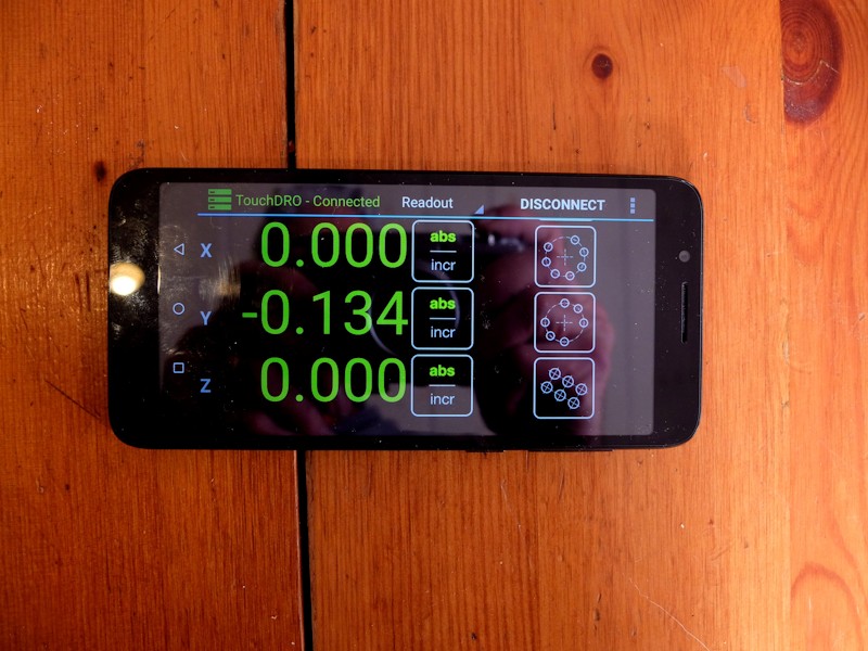

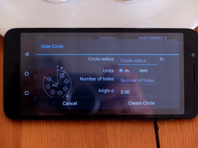

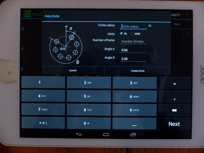

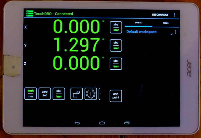

Here are some screen shots of the TouchDRO application on both a tablet and a phone. The various hole pattern functions are at the bottom of the screen on a tablet and can be scrolled horizontally. On a phone they are arranged vertically, and can be scrolled through for selection that way
My setup uses an older version of the MSP430 board firmware (1.3). I found that the later version, 2.0 did not work with my scales because, I believe that version update stopped providing a clock signal from the microprocesor board (formerly available board on pin 1.7) that the scales need to receive in order to send data back.
Maybe a separate hardware clock pulse could be arranged. I don't know much about that -- it is above my electronics knowledge level.
Screenshots of a few of the various functions available in the TouchDRO application on tablet and phone:

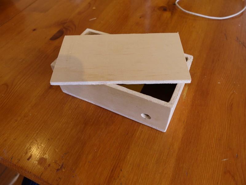

I just made up a small plywood box to fit the bluetooth DRO.
I was thinking about lining it with aluminum foil as a shield (except at the end where the bluetooth transmitter is), but I think I'll just try it out without first and see how stable it is.

Here's the new box, painted.

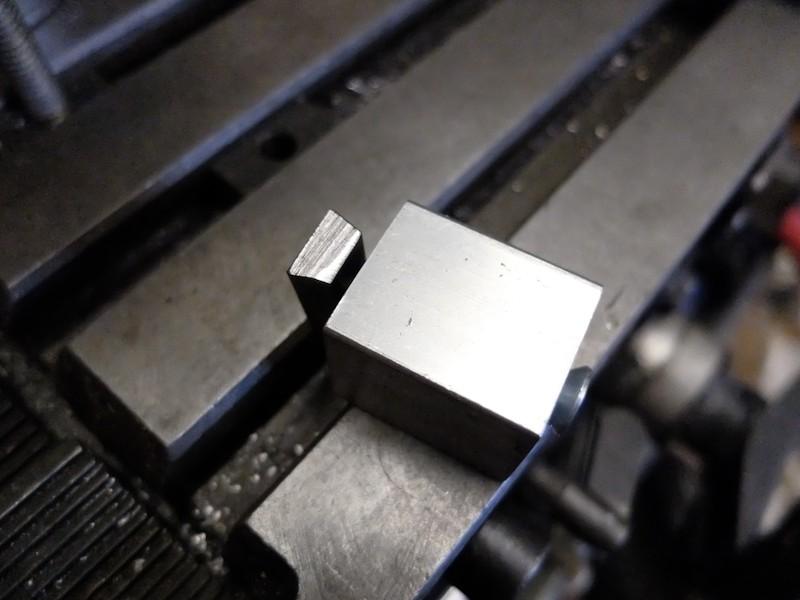

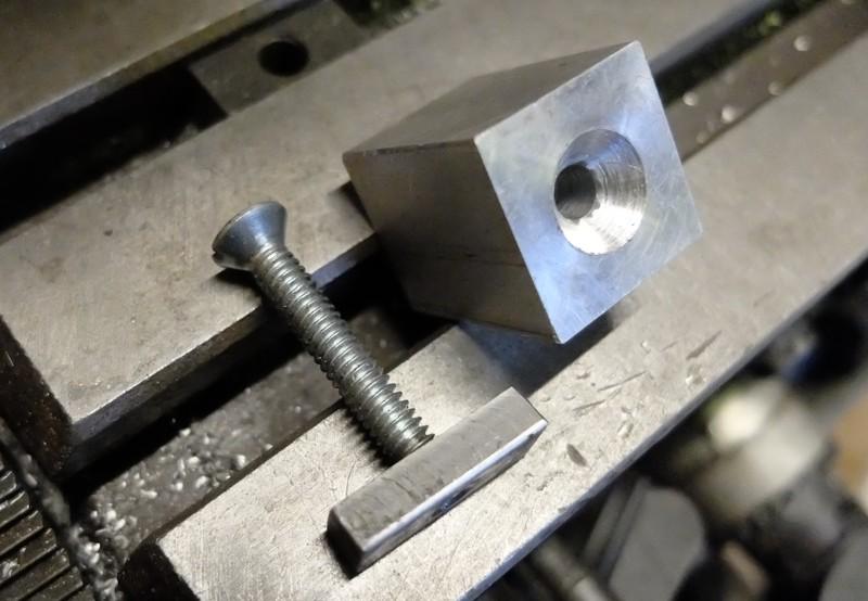

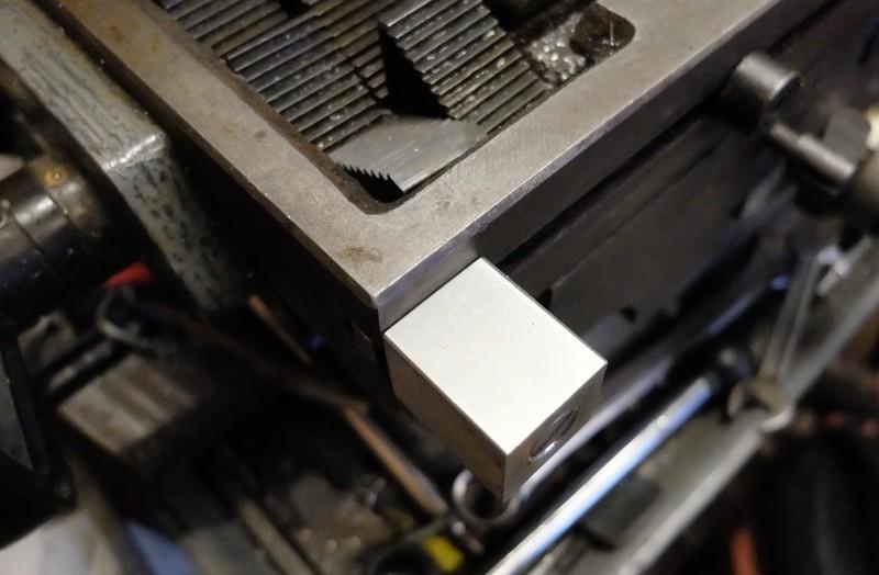

I've finally started mounting the scales to the mill -- a typical heavy Asian round column mill drill, this one happens to be an Enco branded version, which I bought second-hand a dozen years ago from a repair facility. They also had a Bridgeport, and said they hardly ever used the mill drill -- which seemed likely from its like-new condition. The only problem with it seemed to be that the R8 collet retaining bar had broken at the top end and had been brazed together again. Not sure how that could have happened unless it was off the machine when it broke. Anyway, I considered it a good deal at the time, and I got a mill vise and a box of useful accessories into the bargain.
So, back to the scale mounting, today ..... I debated for awhile whether I wanted to mount the X scale to the front, or the back of the carriage, and finally decided on the front. That way I get full Y travel, because otherwise the scale reduces the free distance to the column.
One method of mounting a scale on the front seems to be to re-purpose the stops, which are on the front face of the table. These fit into a dovetail groove that runs the full length of the table. There are two stops, retained by Allen screws into dovetail nuts, and they can be set anywhere. I think most people use them merely to prevent running the mill table too far off the end.
I happen to like those stops a lot, and use them frequently when slotting on the mill. They allow easy milling of slots with clean ends without having to keep an eye on the dial. While I imagine that with a DRO it's easier to know when to stop at either end of a slot, you can do it by number. Nevertheless, I'd rather have a physical stop, and not have to constantly check the readings at all. It definitely speeds up the work when it takes say 20 passes to fully mill a deep slot.
So, though replacing or repurposing those stops to support the scale would make installation easy, I didn't want to do that. Instead, I decided today to make a second set of dovetail nuts (kind of like tee-nuts), and some solid stand-offs to support the scale and use the same dovetail slot that the stops slide in. That way I can retain the stops, and still support the scale by that simple method, and there would be no need to drill a hole in the table. The standoffs would be long enough to space the scale far enough away from the stops, so I can get an Allen wrench in there to tighten or loosen them when I need to. The standoffs would be at the extreme ends of the table -- the stops are free to slide and position in the rest of the length of the table.
I decided therefore that the standoffs should be 1.25" long, and made from some 1"x1" solid aluminum bar stock cutoffs  from a scrap barrel that I won at a machine shop auction.
I measured the dovetail nuts that the stops used, and they turned out to be 1/2" wide, and had 15 degree tapers to fit the dovetail slot. I milled these dimensions into some hot-rolled steel strip and sawed off two inch-long nuts, and tapped them 1/4" -20.  I also drilled the 1-1/4" aluminum stand-offs 1/4" and countersunk the ends. By evening I was able to screw the standoffs onto the table using the dovetail nuts, and it looked quite sturdy, clean and simple. Happy to get that particular slide mount figured out.

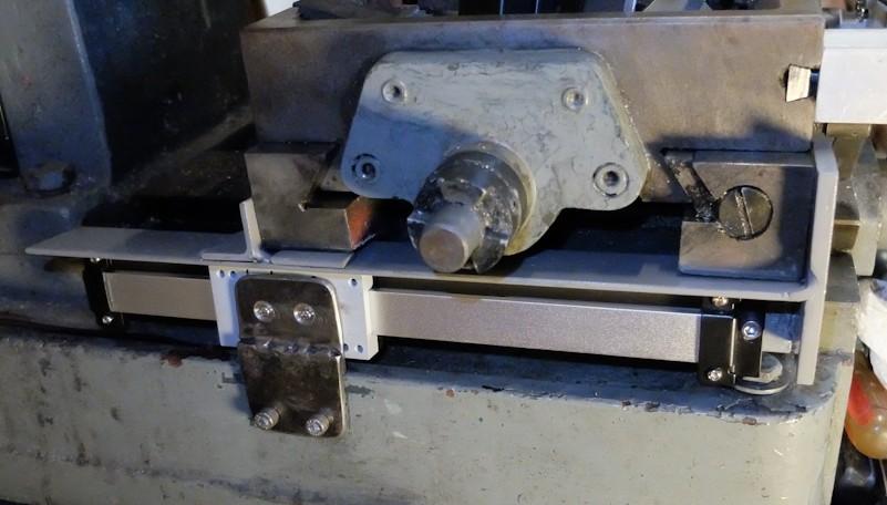

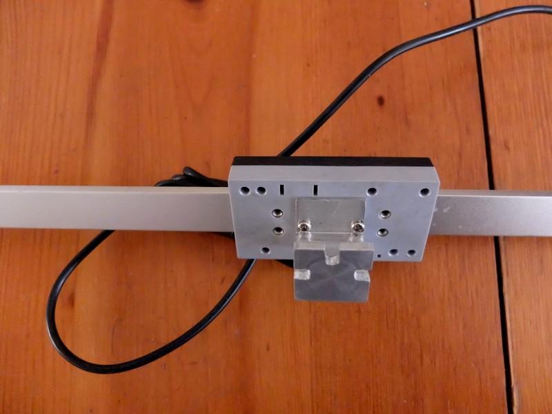

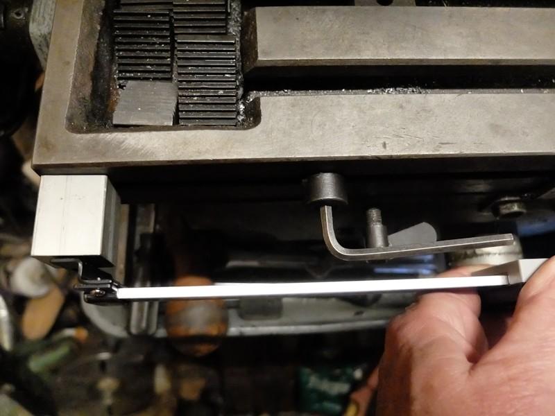

This morning I measured the distance between the reader head and the fixed stop bracket on the mill. I then cut off another piece of the 1x1 aluminum bar that length and cut a channel in it to form a U bracket.
The reader head takes some very short, supplied 3mm screws, so I milled that wall .064" then drilled for the screws which needed a 20mm spacing. (heh, lots of mixed measurments). For the other face I added two side slots to pass a screwdriver, and the vertical slot to take the screw that will go into the mill's fixed stop bracket. I'll be fastening that with an 8-32 screw.
  • Posts: 6941
Re: DIY bluetooth DRO for my mill
« Reply #15 on: April 21, 2022, 04:13:17 PM »

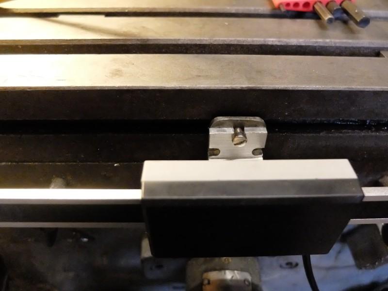

And here's the X axis reader mounted to the mill's fixed stop:

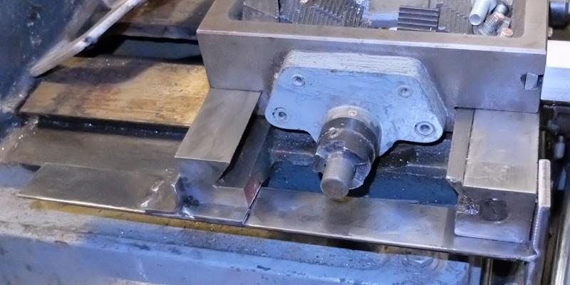

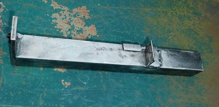

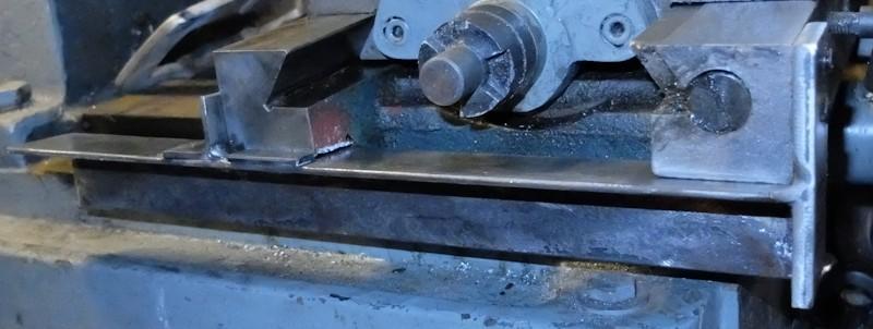

On to the Y scale mount:
I just didn't want to drill into my carriage horizontally in my cramped space and tap blind holes into cast iron in situ. I also didn't want to remove the table. Yet I wanted to mount the scale on the carriage and mount the reading head stationary on the base. It took a lot of thought to come up with something, but it occurred to me that maybe some kind of clamping fixture would work -- maybe fabricated out of steel angle and strip.
Below in the photos is eventually what I worked out. Not the most elegant piece of work, but it does what it is supposed to do -- it's a close fit on the extended bearers, and a couple of setscrews lock it in place. I did drill dimples into the castings for the setscrews to register in.
The main body is 1-1/2" angle iron. The downward facing leg will be where the scale mounts, inside the angle. The horizontal leg above will shield it from swarf.
The angle iron isn't quite square to the mill surface. It is rotated 8 degrees from vertical, because the cast iron bearer surfaces were at that orientation, and in fact so is the mill base edge -- that's the draft angle it was given when cast. This is quite convenient since with both the scale mount and base surface at the same angle, reader head will be straightforward to mount, and I won't need an angled bracket.
Well, I'm definitely glad to get this puzzle worked out after a lot of head scratching, and trial fits. The scale will go on tomorrow.

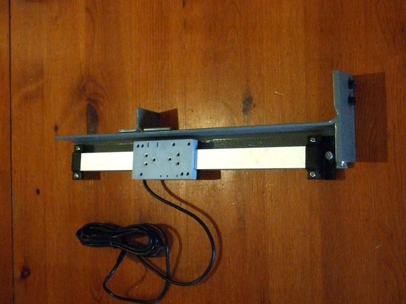

I had to shorten the Y scale by 4" to fit my mill. That was easy to accomplish with just a hacksaw. Then I reversed the end brakets so that the back of the reader head faced out, I drilled and tapped the new new Y axis mount, which I'd painted last night. Here's the assembled scale and mount:
  • Posts: 6941
« Reply #21 on: April 24, 2022, 03:30:33 PM »
I made a fixed bracket for the read head and mounted that to the mill base. With that the Y scale installation was complete.

I did a quick test of the Y axis using the same resolution setting I had for the X. I got different results which surprised me until I remembered that the X calibration was against a DTI set on the table and bearing against the quill. This time with the Y, I was just looking at the dial readings on the crank. I then checked the X against dial, and got a similar result. So that begs the question, which is corret, the cheap DTI, or the dials? Or neither.
I'm in need of a standard......
