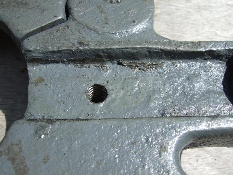

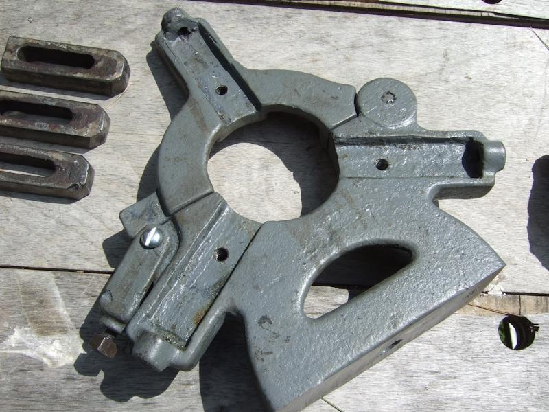

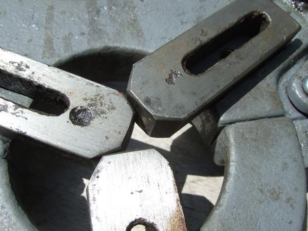

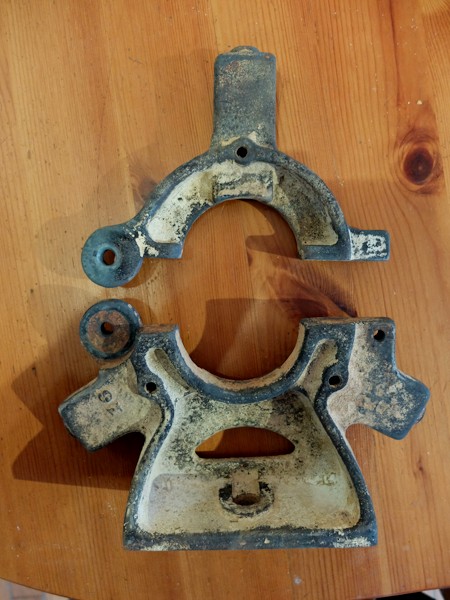

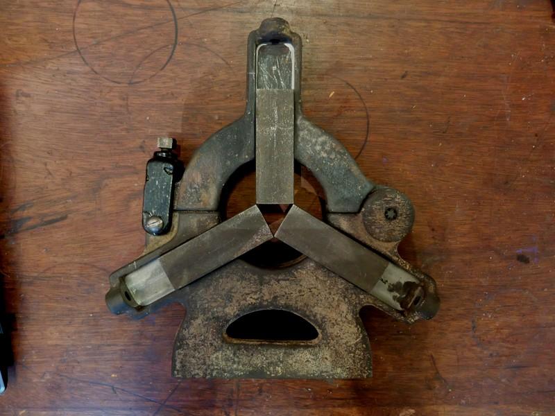

This is a steady rest I bought quite a while ago for $15 at a flea market. Back when I was building my new lathe, I tried to use it by adapting the base. But I eventually gave up on the steady rest as too much of a rehab project in itself, and shelved it for another day. Well that day has come around.
I'm not sure what lathe it was originally intended for. It  had a single prismatic slot on one side of the base and a flat on the other but I sawed off the base to fit the new lathe. It was, in my opinion, poorly made. The fingers were all unmachined castings with the draft taper left in place, making the tops wider than the bearing faces. The slots for the clamping screws weren't machined either. The slots weren't long enough to give full range of travel.
There was just some evidence of crude belt sanding of the fingers to fit their individual slots. They didn't all come together evenly or in the same plane. The base slots themselves were very roughly cast, and weren't machined. When I tried to mill them true, it turned out they were chilled iron, and I chewed  up a good end mill. Even a carbide mill wasn't up to the job. That's when I shelved the project. Here are some photos of what it looked like then, and some of the problems:

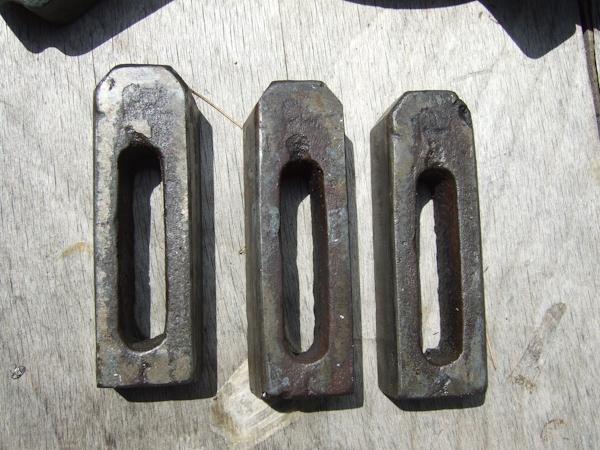

I did try milling the slots again today with a homemade insert mill, but got the same result -- some chilled iron too hard for carbide. That was the last resort before trying to anneal the whole works. I was a little concerned that a casting this large might crack if reheated and cooled again in the ashes of my wood stove. I'd done that trick before with small pieces, but nothing this big.

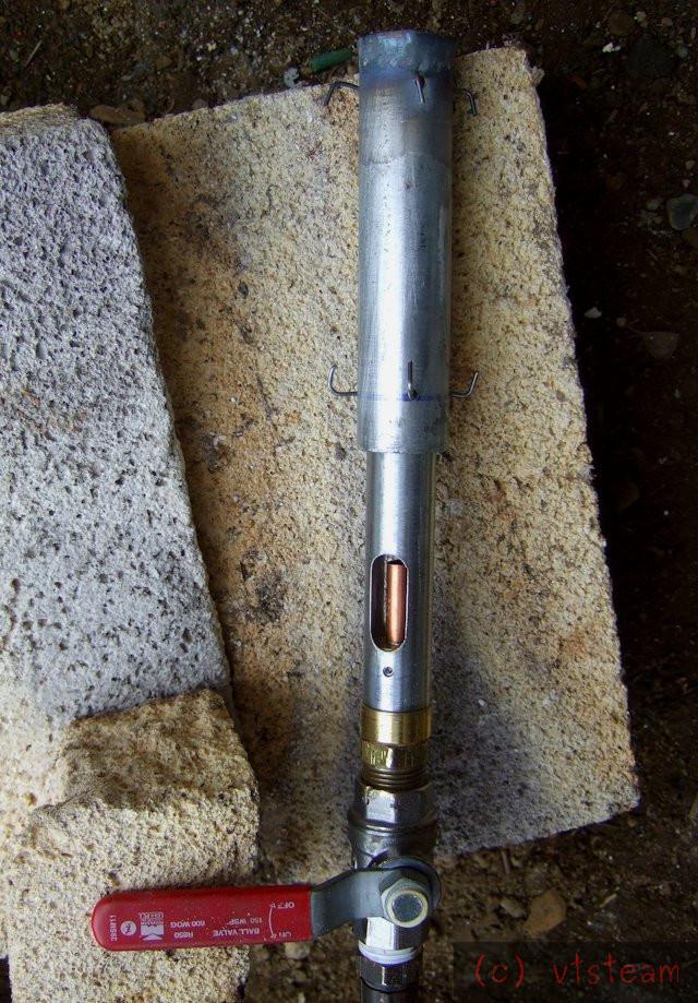

I decided to try my oil furnace instead. Since it's insulated with refractory blanket, I figured the cool-down period might be slow enough if I covered the openings after the heat. In order to slow the heat up period, of reduce the risk of cracking, I decided to remove my oil burner and substitute my atmospheric propane burner -- originally intended as a brazing torch. It could do a slower heat up, and without all the noise of a blower ....I figured it would be up to the job.
  • Posts: 6835
Re: Steady Rest Rehab
« Reply #2 on: March 23, 2022, 07:53:05 PM »
So I loaded the steady rest castings into the furnace, cranked up the propane pressure to 12 PSI, lit the torch and placed it in the tuyere. Pretty simple. I left it there cooking while I did some nearby cleaning and inspection of a new 4-jaw chuck (not a happy experience, btw). A half hour later the inside of the furnace and the pieces were glowing orange, so I shut down the burner.
The casting is not much more than 3/8" thick in any particular place, so this seemed enough time to heat soak. I placed a fire brick over the exhaust hole, pulled the burner out and plugged the tuyere, too.
Four hours later I felt the outside of the furnace and it was just slightly warm. Same for the lid. So I opened her up, and judged the temperature to be about 200F -- low enough to remove the castings. They looked good -- all the paint was burned off, except for some powdery residue. The metal looked good, and best of all, I could notch with a flie the thin edges of the finger slots on the casting. This meant it was machinable, finally. Quite happy with the result!

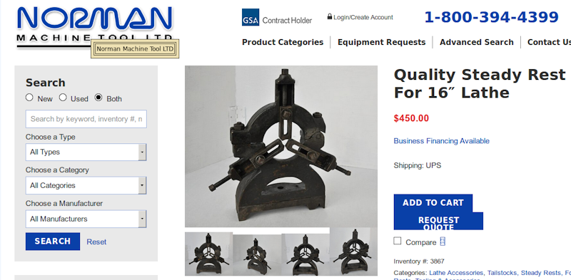

I found an old casting number on my steady rest, the number 16. I was kind of curious about what kind of lathe it was made for. So I did an image search and here's the closest match:
Four hundred and fifty bucks..... :jaw:    The ad also says "Quality Steady Rest" but doesn't actually mention what particular quality.......

Yours didn't look like it was even roughly machined, just a raw casting... Could it have been sold as that, not to you, but some previous owner?
I sure would have given up on it, if I had bought it for my lathe, even as "half finished", as I might not have thought of anealing it...

« Reply #7 on: March 31, 2022, 04:05:16 PM »
Thanks Kjelle!  :beer:
I think it was sold originally as functional, not raw castings for machining. I also think it's quite old, judging by the style of the numerals in the "16". I just don't think it was made with much care -- as a guess, probably just a cheap included item in a lathe package, not probably sold as a standalone product.
It actually was somewhat "machined" -- on a belt sander for the fingers, and the bolt holes were drilled and tapped. But like the rest, that was not done very well. The topmost finger retaining hole is too high compared to the locations of the others, restricting how far that finger can move inwards.

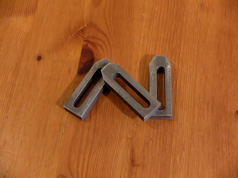

Here are the new fingers, now slotted and the ends beveled on the mill.

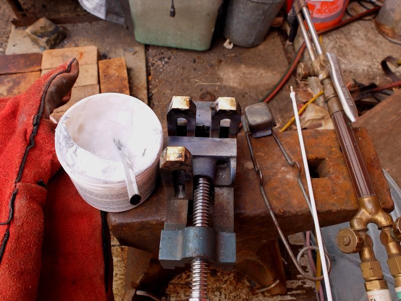

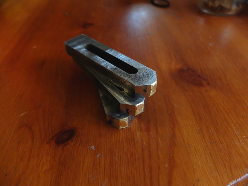

Brazing the tips of the fingers:

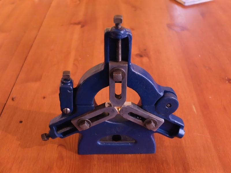

Here's the steady rest painted and put back together. And as usual, one screw has gone missing. Well if I'm working on something complicated like rebuilding an engine, I usually wind up with one screw extra. I don't really understand the physics of that.  :smart:
I do like those square headed adjustment screws -- they look cool. I hope I find the missing one. But for practical reasons, I probably ought to replace them with straighter (and easier to turn) new bolts, or even wiser, with knurled headed knobs, because they really should be adjustable by hand, I think.
I would if I had a knurler, always meant to make one -- I even have the dies on-hand. But just one of those many projects for a future date.
Anyway, this one is ready to check off the list.

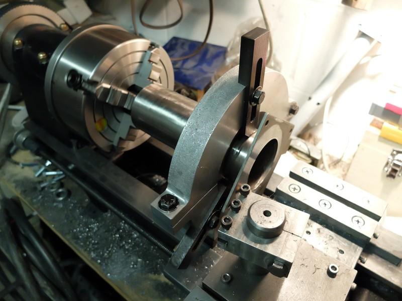

Doesn't fit the new lathe because the edges of the casting interfere with the carriage arms by 1/4" each side. I can't trim the casting edges, because there isn't enough meat in the bottom, and a relief would also cut into the edge flanges of the steady rest.
Uhhhh, the operation was a success..........but the patient died.  :zap:
Well, it will fit the Craftsman lathe with a riser block, with those reliefs cut into it -- the two lathes share the same ways dimensions, but I don't use that lathe much since building the new one. And I really want a steady rest for the new one.

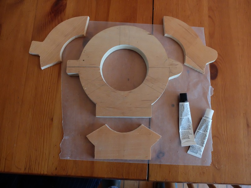

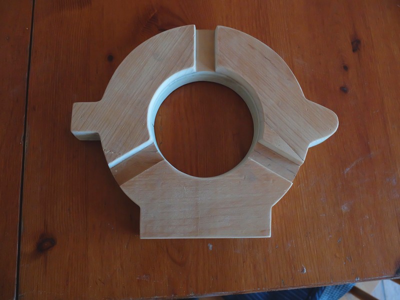

Here are the pattern pieces, all cut on the bandsaw, and every edge is drafted. I don't always do that, depending on how thick the pieces are and whether there are greensand cores. Rapping can get you pretty far, but this one is done right.
A tip to those interested. When adding draft to a complicated pattern via a bandsaw or jigsaw, always proceed around the piece in the same direction with a tilted table. For instance cut as much as you can clockwise, and nothing counterclockwise. Then to clean up any needful unfinished cuts, reset your table angle (or the shoe of your jigsaw) to the opposite angle, and cut the counterclockwise edges.
  • Posts: 6835
« Reply #17 on: April 02, 2022, 10:42:53 PM »
The pattern pieces glued together.

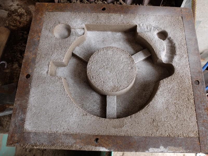

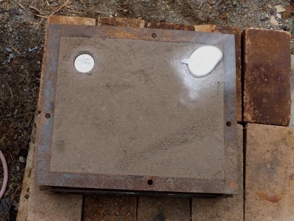

Okay so here's the greensand mold. Notice how clean those corners are and all of the greensand cores look precise. That's a result of drafting a pattern -- they release so much more cleanly. And a result of molding in proper moisture content ordinary traditional greensand.
What is ordinary greensand for me? Just fine silica sand, mixed with fireclay 1:3 by weight. Not even Bentonite --  though that is good stuff. But it doesn't guarantee anything. Just because you use bentonite, doesn't mean your castings will come out the way you want them. High class ingredients are just helpful, not determining.
Nope, this is just the same old 100 pounds of plain sand and fireclay that I have been using for 20 years. I use it for aluminum, zinc, and brass. Iron sand is different, but this mold will be used for aluminum.

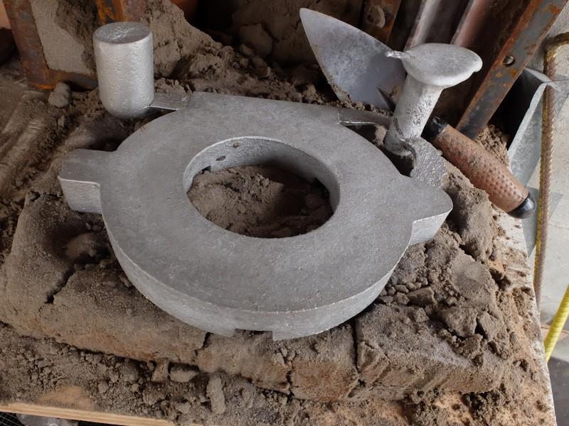

The pour. This was from a mix of my not so good aluminum scrap -- pieces of an old auto bell housing, a thrift store trivet, old sprues, a spill from a prior session a few years ago, and other odds and ends. I melted an excess in order not only to have enough for this thick casting, but to pour some ingots as well

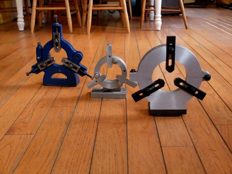

A steady rest is something that doesn't get used often. A cast iron version must have paint not to rust in the high humidity of my small shop. There's water on the concrete floor for one month a year in spring. It's just drying out now as a matter of fact. Even painted, anything ferrous unused for awhile will manage to rust.
This cast aluminum steady is of substantial proportions, and I think aluminum is the best choice here -- it always stays bright in my shop. Zinc alloy also stays good looking in my experience, in this shop. But I'm running low on that, and I want to reserve it for more important uses. I might cast the fingers for the steady rest in zinc alloy -- it's a good bearing material, and much stronger than cast iron or aluminum.
And no, I do not have galvanic problems in my shop when mixing any of these metals in a finished tool. That's through actual experience in over a decade with them. Likewise almost any high class machining project online mixes brass and steel in places, and they are a bad couple in the galvanic series. Okay enough of that..... out of the world of online armchair theory and back to practical experience.....and reality.....here's the pour:

I forgot how easy aluminum is -- it cools in a couple hours instead of 8 or more for iron. Not so much worry about things like chill hardness or thick pasty slag, or inclusions. Aluminum dross is very easy to scoop off and tiny by comparison. Using the atmospheric burner is pleasant and quiet compared to the jet blast of the oil burner.

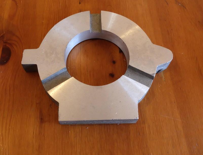

So I was able to unmold this pour this afternoon, and the result is a good one -- no surprises. Very slight smooth shrink cavity on the back which is hardly noticeable. the front, sides and hinge details are perfect -- which is why I placed the face in the drag. I did put a riser in  the base area, because I didn't want a shrink cavity there, and that worked out. This casting should machine out nicely, I think.
I might have to use the 12" swing Craftsman to face it as there's no easy way to clamp it down flat on the mill for that operation, and the new lathe doesn't quite have the swing to clear the hinge and base areas. But it will be easy to mount it on the Craftsman with the outside jaws bearing against the center hole.

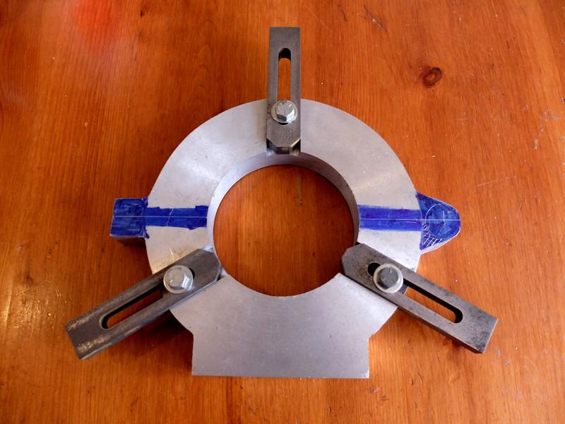

Faced off and bored.

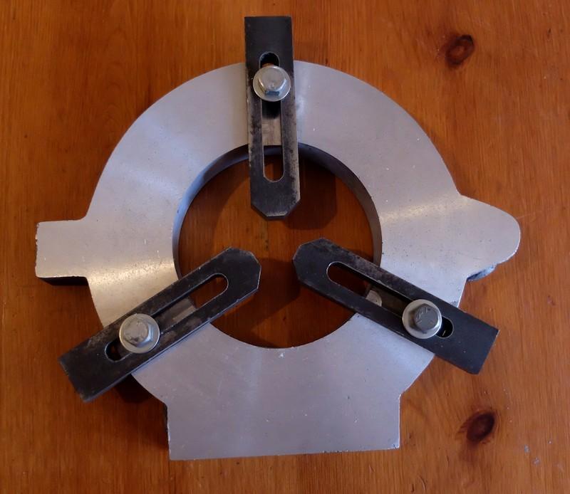

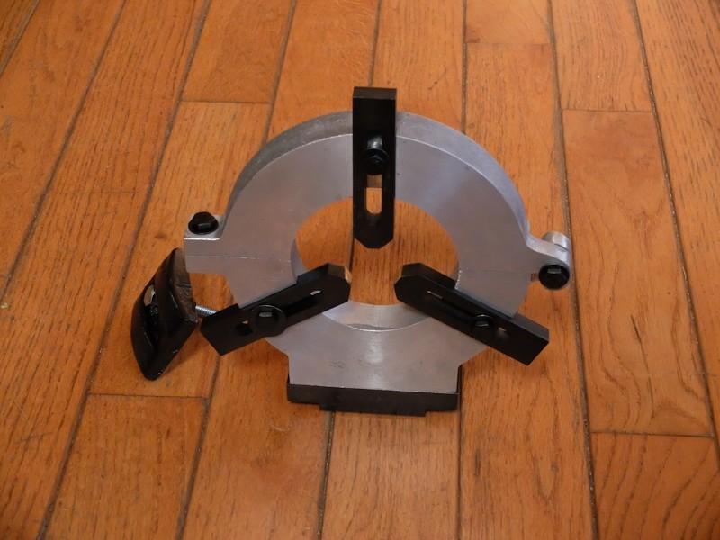

I decided not to cast the fingers after all, but make them out of the same 1/2" x 1" hot rolled steel I used for the older steady. Very tedious with my mill to slot those, but I made it through all three by the afternoon. They still have mill scale on them, they'll get a soak in vinegar and salt overnight, and then they get tabs brazed to them for the adjusters, and brazed tips to reduce marring the work.
I did also slot the aluminum casting to fit the fingers -- a heck of a lot easier milling aluminum! It was a pleasure by comparison. I have to admit, I don't particularly like milling. I'd ten times rather machine work on the lathe than the mill. But sometimes you have to.
Also drilled and tapped the casting for the retainer bolts. Again, easy as pie with aluminum. Hey, a plus, when I searched for the tap I found the missing old square headed adjuster screw for the old steady rest -- it was in the box of taps. I must have checked it against a tap for thread pitch, and then set it down.  :wack:
And finally I was able to fit the new steady parts together for a look-see. I'd managed nice close sliding fit by cranking the mill dials and winding out backlash in the old way -- DRO is still not fitted there.
Here's the present state of affairs;

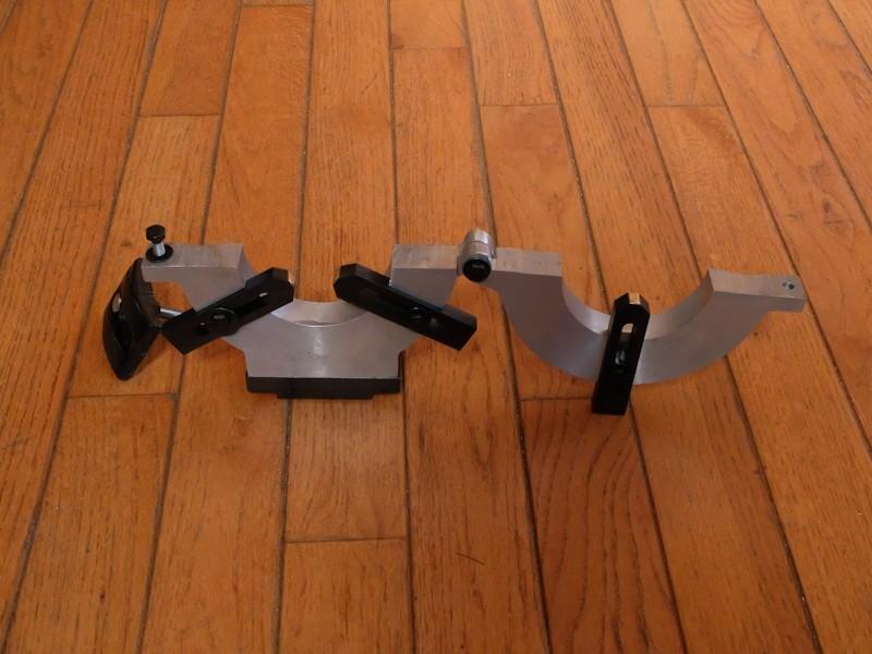

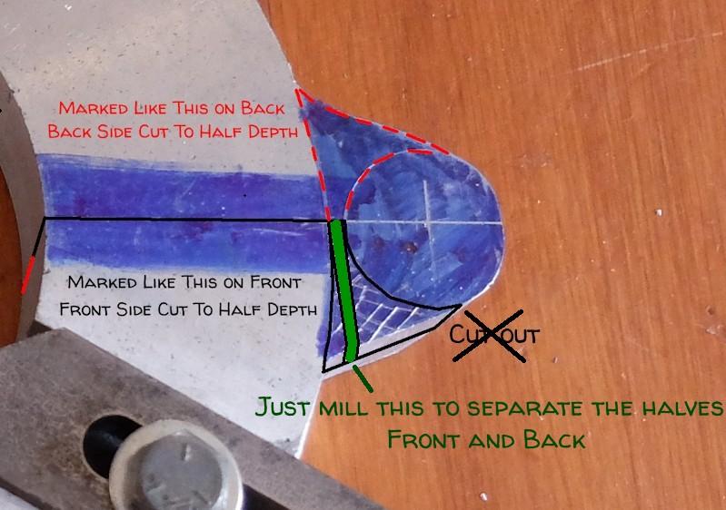

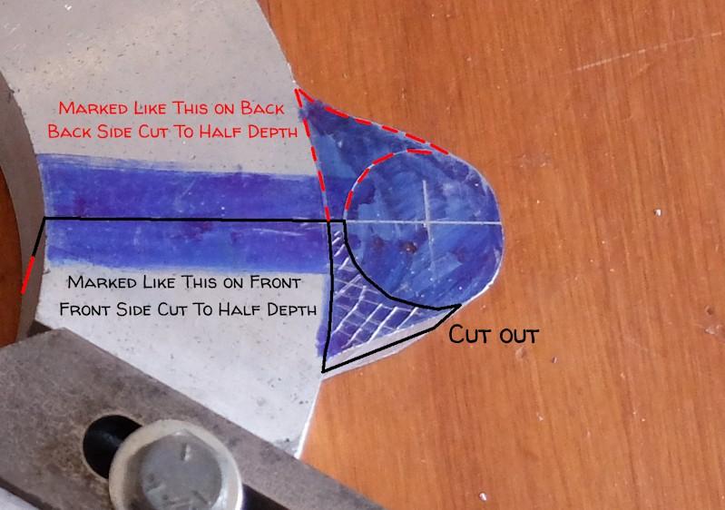

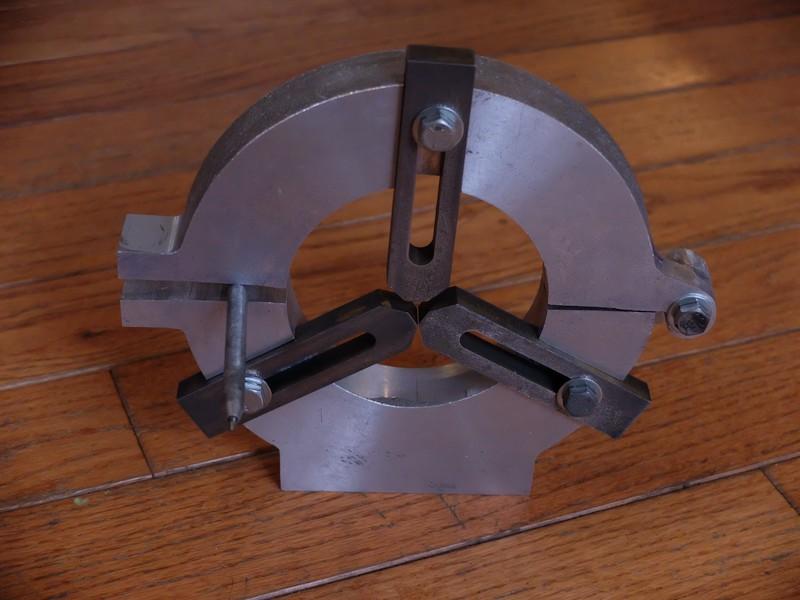

And the casting split and hinged. This required splitting the ring horizontally, and the hinge vertically. Then relieving to half depth alternate sections, front-bottom and back-top, of the hinge.
I see the problem, but not solution....unless cut slanted, but can't see that on the picture or explanation. I just don't see how the hinge is whitled from one part. How it is done?

Pekka, I don't know if this is any help:
Re: Steady Rest Rehab + a New Steady Rest Casting
« Reply #31 on: April 07, 2022, 05:44:44 PM »
Oh. I see it now. Thank you.
  • Posts: 6835
« Reply #32 on: April 08, 2022, 03:09:55 PM »
You're welcome Pekka!  :beer:
BTW after squinting sideways with my head practically on the mill drill's table trying to profile out that shape with a tiny mill -- the view almost completely obscured by the big quill, turning dials, Twice. Once for each side of the part. I eventually figured out there was an easier way. and I'll pass that on to anyone trying to do something similar.... No, I don't mean CNC it, I mean if you're hard core, like me with an old round column mill and an unmounted DRO. Or more properly hard headed....
Don't try to profile out that whole shape. Just mill a straight cut across the middle of the waste area to the pivot line. Turn the part over, re-clamp and do the same for the other side. If you've already done the horizontal and vertical saw cuts, the halves will then separate.
After that it's a heck of a lot easier to profile the hinge bit on each piece. In fact if you are working with aluminum like me, a coarse bastard file will profile these pieces faster than you can clamp indicate, and twiddle mill dials towards an approximation of the shape that needs file cleanup anyway to finish the job.

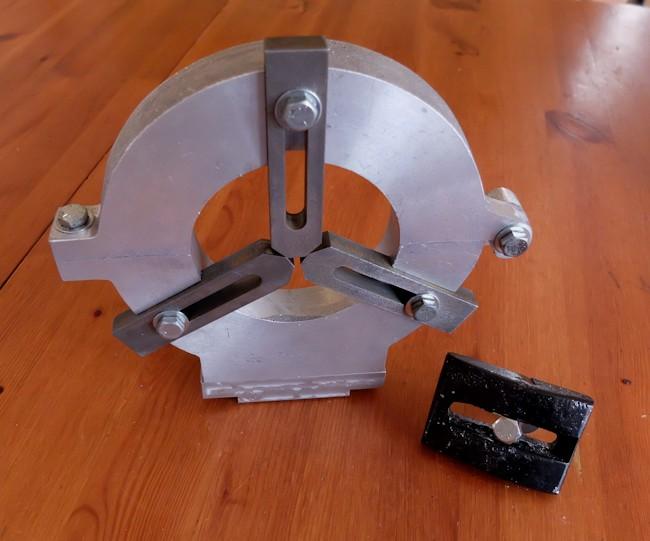

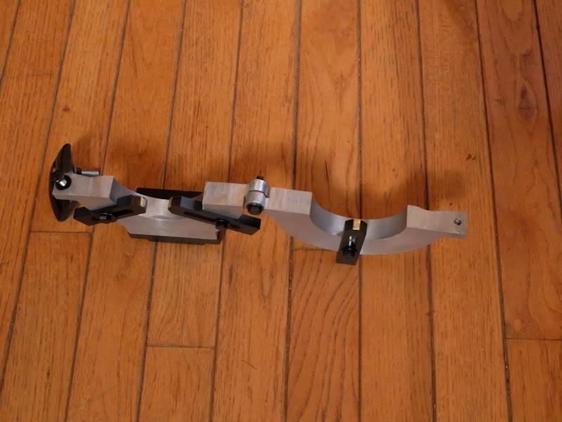

I added the clamping bolt for closing the steady.
I made a 1" thick base for the steady rest that positions it at center height over the ways. It extends back from the rest forming an L shape. It was milled out on the bottom to fit in the gap in the ways and is meant to slide tight against rear way. It is bolted  to the rest from underneath using two countersunk 5/16" x 2" grade 8 flat head socket screws.
I've also cast a slide clamp of zinc alloy, and it fastens through the base with a trapped 3/8" bolt and nut.
The steady is now fully functional, but there are a few more refinements to come. It's rock solid presently on the ways of the new lathe.

Fingers brazed on the tips:
  • Posts: 6835
« Reply #36 on: April 10, 2022, 11:55:50 AM »
This is the steady rest done, with the ferrous parts finished.
I had originally planned to add tabs to the fingers like the Gingery steady rest has, and individual adjustment screws, but have since decided against that. I now think that screw adjustment isn't necessary, or even desirable.
Fingers on a steady should be adjusted to stock diameter via light contact pressure. That's difficult to determine with a screw adjuster, but quite easy with plain slides, as long as they are good fits in deep slide channels, and are well supported and fully locked by the retaining bolts. That's the situation with this new steady rest. You can feel them slide into proper position. It's also much faster to set up without adjuster screws.
This steady has deeper and longer channels for support than either the Gingery or the cast iron rests. It has larger work capacity (4" vs 3" and 2-3/4" respectively), Unlike the Gingery, it is hinged, and it has a base that keys to the ways, so it can be set up on a part near the headstock, and then slid out to it's working position while remaining parallel with the ways, and retaining it's working diameter.
Unlike both, it has brass contacts on the fingers, and no screw adjusters. It has a simpler and stronger casting than either of the other two,
The steel fingers on the new rest are longer than on the iron steady and the slot length and bolt locations allow more bearing when the fingers are extended to the fully closed position.
The Gingery rest's fingers are not slotted, and have less support, due to side-mounted retainer bolts and washers. That's mainly a result of assuming no milling facilities by builders for slotting. The adjustment screws on the Gingery rest are probably necessary to help retain the fingers against end forces.
So, now my new lathe has a new steady... I learned a lot about what I like in a steady rest by having two other examples to look at while making design decisions. Quite an enjoyable project in the end! I'm looking forward to using it for building the Ryder engine.

Simple, functional and beautiful :clap:.
Thank you Steve for opening your thought processes about the design choices. That was very educational.
Jari
  • Posts: 6835
« Reply #38 on: April 11, 2022, 09:44:34 PM »
Thanks Jari!  :beer:
Finally, in use:

That was a pretty loveless product that someone threw on the market. No effort to machine the casting to make it work well. I am sure you will make the foundry proud.
For me it is the opposite. I think the Mig jet causes super sonic flow of the propane, cause the furnace is really loud on gas, but with a little 70w squirrel cage blower, it is pretty quiet on oil.
