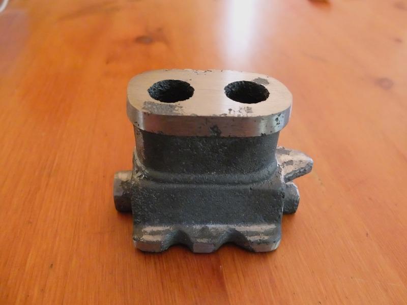

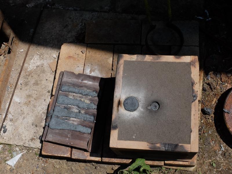

Yesterday I cast a block for a model Westinghouse style twin in iron. I'd tried this a few weeks ago with some questionable iron using an old pattern and without cores, just as an experiment to see if the iron would cast well. This second time around, I made a new corebox, and a baked sand core (mentioned in another thread). This time also I used brake rotor metal, which I'd tried successfully earlier in casting a lathe chuck back plate.
My furnace has been acting up a little for the last two casting sessions -- not sure of the reason why other than repairs to the lining lately, but I'm beginning to suspect the jet in my burner might be partially obstructed. Symptoms are, the furnace is harder to light, and  slower to melt. I was earlier getting phenomenal melt times of 20 minutes for a pour of this size. Now it's more like 40  minutes -- still reasonable, but I'd like to know the reason for the difference.
The other possibility is that disk rotor metal takes longer to melt. Or a maybe a combination of all of the above.
Anyway, I made up the mold and placed the core in it without any hitches. The facing sand was a little dry (I should have checked in advance). So there was a little breakaway/flash at the seams, but no biggie.
The melt took much longer than expected, as mentioned, and I took some pains to slag the melt twice and thoroughly. Perhaps too long with the crucible out of the furnace, or too cool in the melt, because when I poured the sprue filled and stopped accepting metal before the riser was full to the top. I don't think I've ever had that happen before.
But I was still hopeful because the riser had filled to well above the casting's height.

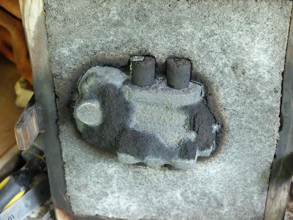

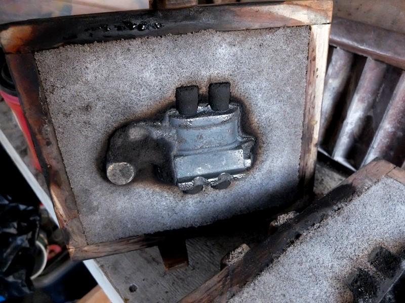

Here's the breakout about 4 hours after the pour. Notice how well the cylinder cores in the block have worked, and burned to black sand:
  • Posts: 6940
Re: Casting a Model Westinghouse-Type Twin Steam Engine in Iron
« Reply #1 on: March 20, 2022, 02:34:44 PM »
I was pretty hopeful, the detail looked good and the core had worked perfectly:
  • Posts: 6940

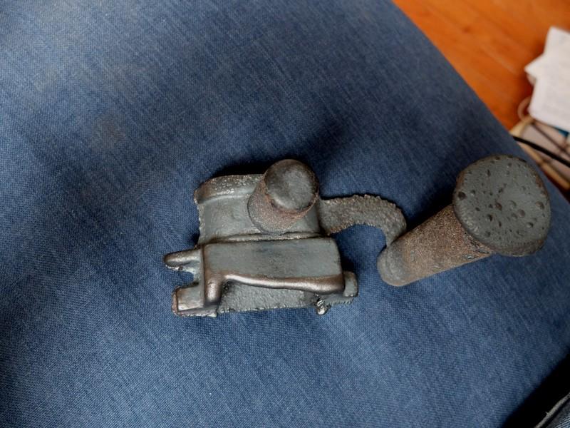

« Reply #2 on: March 20, 2022, 02:38:13 PM »
But nope, the metal just wasn't hot enough to fill the thinnest area furthest from the sprue. The riser had been closer to the sprue and in a thicker part of the casting, so it filled. I'm pretty sure this would have been a perfect part if the metal had been hotter. Oh well, next time.....
I'll relocate the sprue and give it two gates to either end of the thinner part, plus, of course, pour hotter.

That is pretty close to working.

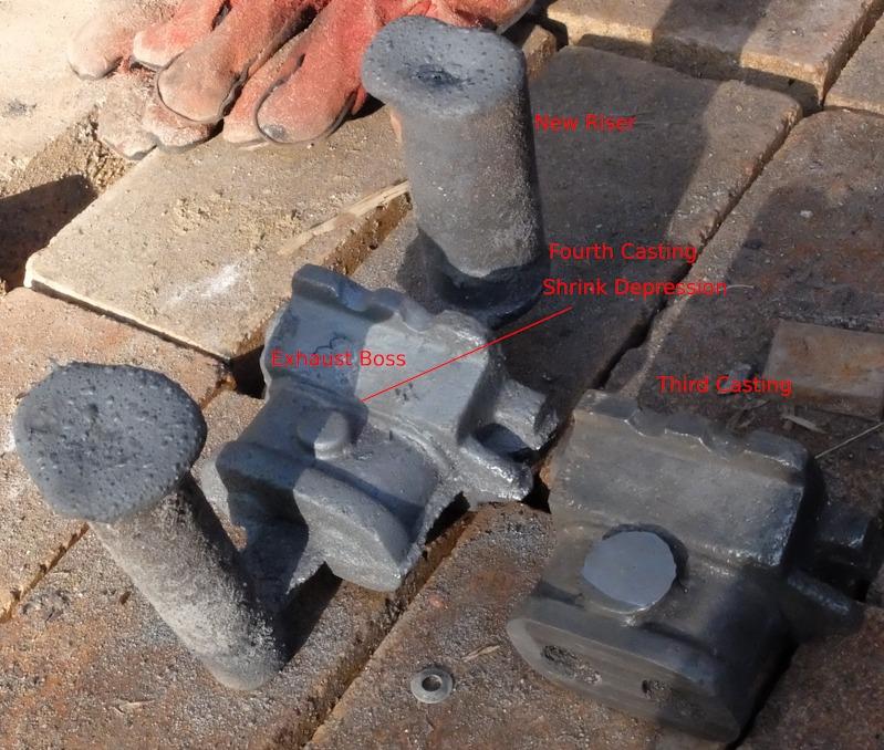

I'm going to give the Westinghouse engine block another try when I get another core made up.

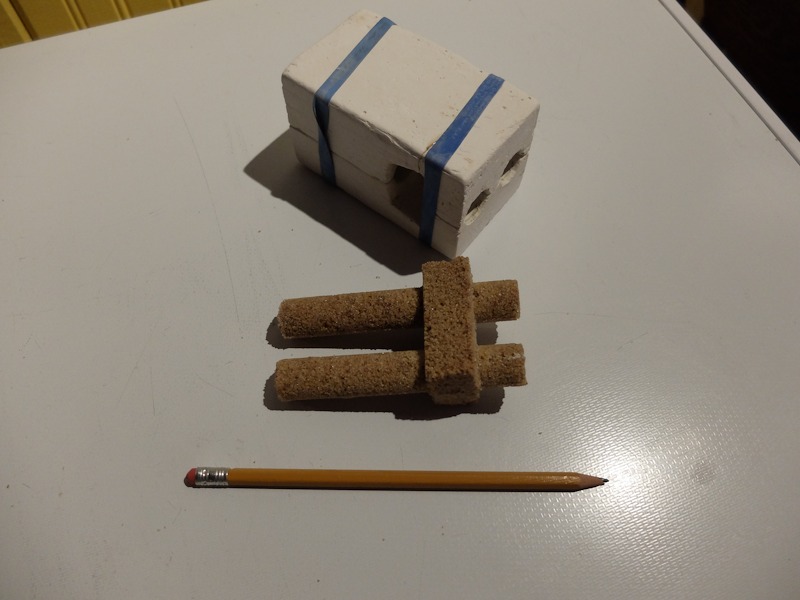

I'm re-thinking the corebox. The plaster of Paris version has a crack in it -- I can repair it, but I'm thinking now about fabricating or casting one in metal. Since I'm using a baked sand core for this engine, it would be convenient to bake the core in a corebox, or corebox half, unless that causes release/clean-out problems. Or I could  make a core plate for that, since I'm going traditional. Then the corebox could be wood, which is easy for me------- well, still thinking about it.
It's interesting to think about....making a corebox from the solid has pretty much the same shaping considerations as making a die, the alternative being molding it with some compound from a plug, eg. plaster, etc
  • Posts: 6940
« Reply #18 on: May 03, 2022, 08:04:33 PM »
I repaired the plaster corebox and baked a new core in preparation for another go at the small Westighouse steam engine casting. This is really a test piece, rather than an engine I want to build at present. But it's an interesting challenge, and it helps me understand how to design a better engine pattern, core and corebox, and I can also try different types of scrap iron I have on it.
To me the ideal corebox for baked sand cores would be made of aluminum so you could not only mold it in the box, but bake it there as well. And the best aluminum corebox would be relatively thin around the core -- say 1/4 or 3/8 inches thick (6-9mm). That way it would heat up quickly, and also use the minimum amount of aluminum.
Plain Plaster of Paris is fairly resistant to heat, but is still rather delicate, and the temperature must be kept around 200F if the Plaster is to last for repeated use, when ideally you'd be able to bake at 350F. Also plaster coreboxes like the one below, poured into a containing box, are massive. That bulk plus the fact that plaster is an excellent insulator means extended bake times for the core.
I would think that an aluminum core box would bake a small core out like this one in about 15 minutes in a small toaster oven at 350F. The existing plaster box took about 45 minutes, and I still had to finish the ejected core for ten minutes at 350.

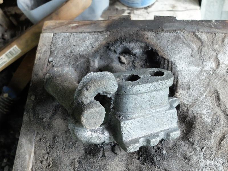

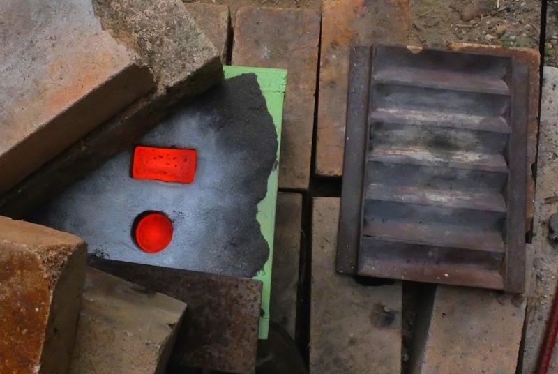

After replacing the furnace lid with a new one built from scratch, I did a melt this morning. I think everything went right as far as I could tell, plenty of metal and it was hot enough. I melted 7 lbs even thought the casting only needed about 3. I useddisk brake rotor, and 11 grams of ferrosilicon was added. It took about a half hour to melt from a loaded cold crucible, and then another half hour to add more iron, slag the melt, add ferrosilicon and get it hot enough to pour.
Not sure why my earliest melts with this furnace this year were about half that time, but I'm starting to suspect the iron itself. I think the first iron I used was an easy melting variety, and the latest disk rotors are not. That might fit with disk rotor metal tending to chill easier, increased toughness and hardness. Maybe rotors are lower carbon. I dunno.
There was a fair amount of really thick chunky slag in this melt. Disk rotors in Vermont get a lot of salt corrosion --especially in the hollow ventilated part.
Anyway, here's the pour....nice and neat. The ingots, less so -- I need to level the base here better...

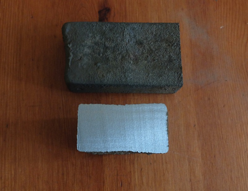

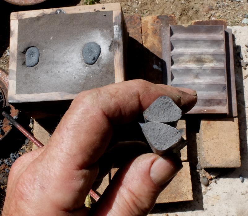

While I'm waiting for it to cool, I broke one of the ingots on half to see what it looks like inside. Well, nothing like I've seen before...
I don't really know what I'm looking this time around for cast iron -- it's very uniform and silver, not white and not gray.
It isn't really chilled because I can file it, though it is tough. It was VERY hard to break. I had to go 4 tries with a sledge. Also it rang when it fell on concrete, In other words, it sounds like white iron, breaks like semi-steel, files like somewhat hardened steel.
Some new kind of animal....
The photo just doesn't show the shiny silvery quality...

The shake out. Looks like the core did its work:

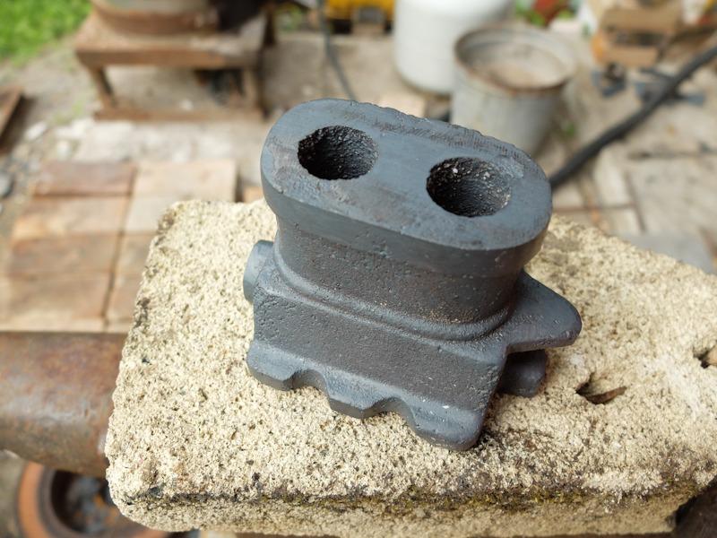

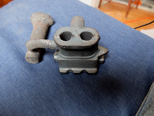

Free of the sand the casting looks good:
  • Posts: 6940
« Reply #23 on: May 22, 2022, 05:54:31 PM »

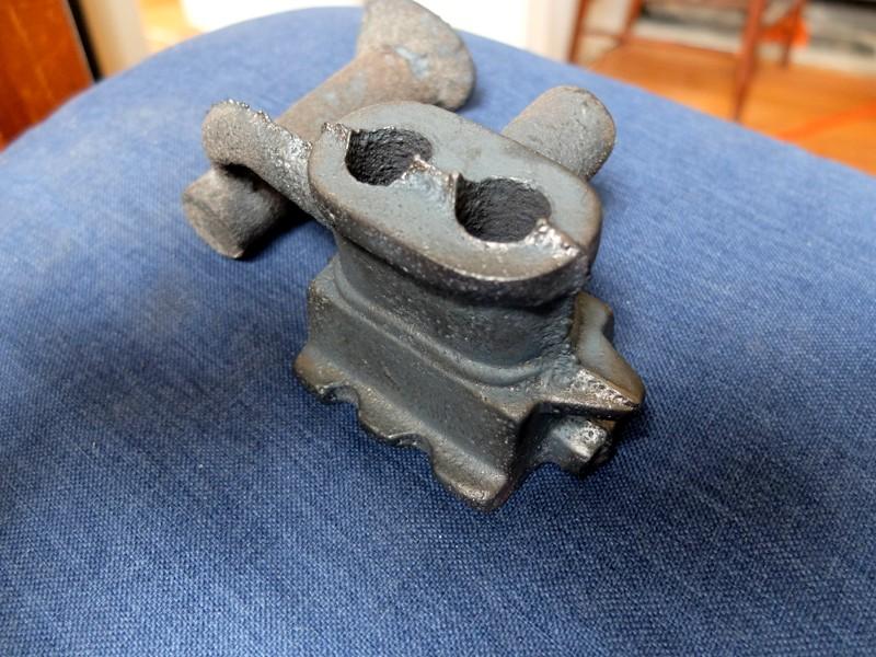

I cut off the runners -- they were in awkward locations and didn't respond well to a hacksaw blade -- chilled at the junction, so I used an abrasive cutoff wheel.
Otherwise I found that most of the casting filed well, with the exception of a couple of small chill spots. I took off most of the flash with a file, and roughed in some other areas just to see how workable it was.
I think I'll try annealing the whole casting tomorrow. No idea if this will work with this disk rotor metal, whether the general hardness is an alloy contribution, or whether like other types of cast iron, it will respond to annealing....guess we'll find out tomorrow....
Anyway, success on the third attempt at the Westinghouse Twin casting! :ddb:

That is a good casting I would expect it to anneal with no problems.
Would coating the pattern with graphite smooth out the casting?
  • Posts: 6940
« Reply #25 on: May 22, 2022, 07:44:10 PM »
Hi Tom, the core was coated with plumbago (graphite), per Ironman's practice, and the facing sand had coal dust in it like his @ 4%.
It will clean up nicely if it anneals -- there's a generous machining allowance, particularly in the upper and lower flanges, and the bores are well undersized. There are no casting flaws apparent at all.

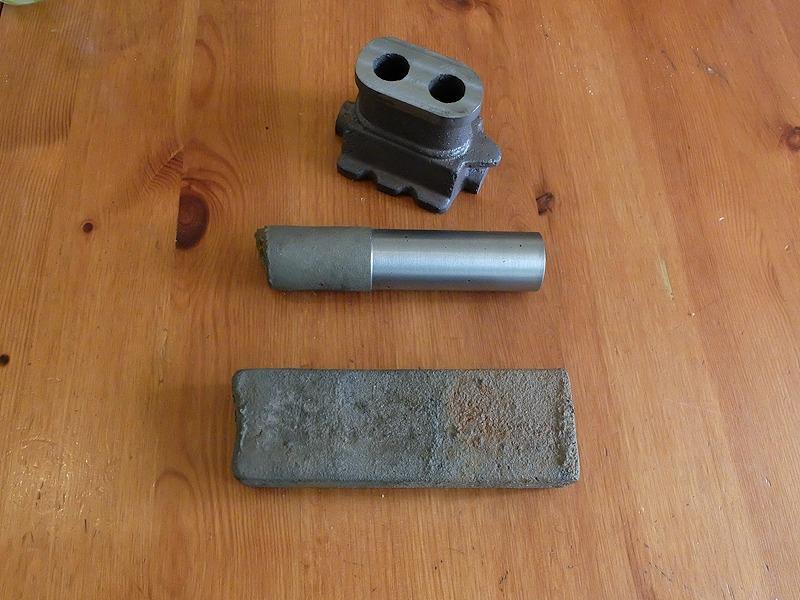

  • Posts: 6940
« Reply #26 on: May 23, 2022, 05:39:10 PM »
Annealing worked. I simply put the casting back in my oil furnace, lit it up for a couple minutes until the casting was glowing a dull red, shut the furnace down, covered the exhaust port with a brick, and plugged the burner blast opening. Four hours later, I opened it up and took out the casting, which was still too hot to hold.
It filed easily, and the hacksaw, which skated before, now had no problem biting into the iron.

Well the Westinghouse Twin casting has some hard spots, discovered after chewing up a couple mills. Very disappointing. I blame the disk rotor metal. Maybe different rotors have different compositions, but the one I used for this engine was tough to cast with -- took a very long time to melt, and was chilled even with .35% ferrosilicon. A subsequent trial melt of radiator metal took half the time, and produced nice gray iron with the same amount of ferrosilicon.
I should factor in, though, that the Westinghouse engine casting is pretty thin. Maybe the rotor metal would have worked better for a thick casting. Though going by the ingot, that was completely white (I think, now -- the fact that it looked silvery didn't mean anything). So I might have needed more ferrosilicon even for pouring a thick casting with it.
I've got another half dozen rotors -- from mixed vehicles, so I'm not sure if they will all behave the same. I'm wondering if I mix half radiator metal in with half rotor metal if it will get something with reasonable melt times and better softer iron.
As for the Westinghouse casting -- probably the best for that job would be straight radiator iron -- since that scrap is in thin castings to begin with, that might be a good match. But I'm a little tired of making cores, etc at this point, so it may be a few weeks before I attempt it a fourth time.

Reboot on the third Westinghouse Twin casting:
I didn't have enough time before predicted thunderstorms today to do a full iron melt, so I thought I'd try annealing that last casting one more time. I was thinking maybe I didn't get it hot enough -- dull red, so this time I went for cherry red, and really let it have the full furnace blast. I also put a sprue and an ingot in there from that melt as test pieces -- to see if they changed.
When red hot, this time, I plunged them into a bucket of wood ashes for slow cooling.
This evening I'm really encouraged tio report that the ingot definitely went to gray iron, and the engine seems like it may have done the same. We'll know for sure once I get it on the milling machine. But I'm hopeful!  :dremel:

Had high hopes for the second round of heat treatment for the third casting attempt, but milling showed it still had some hard spots on the thinnest part of the casting -- the lower crankcase around the base flange ( < 0.25", 6mm thick).
The upper flange machined nicely, and the exhaust boss did as well so there was improvement. But I have to face it, there's no saving this casting. For thin casting sections, disk rotor metal appears to have been a poor choice -- unless additional ferrosilicon might have made a difference. But .35% was already a substantial amount. I do think steam radiator iron might have been a better metal to use, and If I had done, the casting might have been successful.
But another possible approach would be not to core out the crankcase and bores at all, and just open out those spaces after casting. That might actually be easier anyway because coring leaves hard to remove inner surface sand inclusions and scale particularly on a small size casting. And those rough surfaces would requiring milling anyway. So there's not much savings in machining.
Also, small cylinder bores in a twin are unlikely  to be perfectly centered and aligned when cored, that makes a milling cutter the only way to adjust those locations. If machining a solid casting, however, the centers can be accurately located by drilling.
I think it makes sense to core larger cylinders because they can be more easily cleaned and bored afterwards, and you're eliminating a lot of excess metal in the casting, but these were only 3/4" in diameter. Better to drill that out from the solid.
So, one more lesson learned....well several lessons learned!  :coffee:  I may try a solid casting of the twin next.  :dremel:

This ingot broken in half shows very fine grained gray iron throughout.

Of interest, not 15 minutes ago I broke up another disk rotor, and the inner rim bent for several blows of the sledge before breaking -- much more bending than you would normally see in thin cast iron. Ductile iron, perhaps???

Well the operation was a success, (gray iron), but the patient died  :bang:, Faulty riser position allowed a major shrink depression.
I should have known better. This particular engine pattern really needs a riser bang in the middle of the casting, right on top of the exhaust port boss. I've seen this particular problem before, and solved it. Not sure why I tried a different riser location -- I guess I just thought a really big one off of the casting would preserve the boss detail.
Here's a photo of the new 4th casting on the left with shrink depression (looks much worse than photo shows) and the third casting on the right, which had the riser on top of that boss and no shrinkage. The riser did kill the detail of the boss, but I could have whittled it back into shape. I'm going to guess that radiator metal also shrinks more than disk rotor metal -- I did get some shrinkage in the iron bar I cast. Oh well.....  More to keep in mind.
Sometimes I long to go back to aluminum casting. Iron is tough. But there is the thrill of really hot scary iron and a roaring furnace, and the reward ......some day....... of seeing what you want finally accomplished.  Uh...I hope.

Post Mortem:
Yup to the plumbago being a problem. It was found in a clump in the bottom of the crucible -- still powder ---which is odd because it is far lighter than iron and should have floated. It was at an angle and the only thing I can figure is since the crucible was tipped over against the wall of the furnacethere was a cold pocket of slag and colder metal trapping it.
I cleaned out the crucible thoroughly.
Also yup to the furnace having leaks. I found some cracks in the hotface near the bottom, and oil under blower pressure was building up in the blanket insulation behind. This led to copious long lasting smoke through a few small holes in the stainless steel jacket after the furnace was shut down. It also meant difficult to control mixture settings while burning. And loss of fuel and heat.
I patched the interior with ganister and then satanite, and did a small wood burn to set them.
Finally late today I decided to re-melt the metal from the last pour to see if the problems were external, and not the actual metal itself. I put sprue, casting and riser back in the newly cleaned crucible, and added 2.5 more pounds of mixed disk rotor and radiator metal to bring it to 7 pounds again. I added 14 g of ferrosilicon and poured into two vertical bar molds, one round (1.335" dia.)  and one rectangular (1"x2" section). The melt went much better, slag was manageable. Melt took 1/2 hour. The furnace hardly smoked, and seemed to heat more quickly.
I'll be interested to see how much shrinkage I get in these test pieces and how hard the resulting metal is, and how much slag got in. Yesterday was a major disappointment, but today, i feel like I'm back on track, and there's the possibility of not only salvaging the metal from last time, but getting some more useful stock out of it. Fingers crossed!
ps. On the off chance that one more try might soften up the hard spots on casting #3, after the pour, I put the casting in the empty crucible and fired up the already hot furnace for a couple minutes, then shut it down and covered the openings. Couldn't hurt!
  • Posts: 6940
« Reply #49 on: June 01, 2022, 04:46:23 PM »
Well great day in the mornin'! June 1st and all the castings did well, but especially Westinghouse Twin #3, which was fully annealed by the last (and third) go at it. I was able to machine all mating surfaces with absolutely no chill hardness anywhere.
What was different? Well putting it in the furnace immediately after another iron melt, inside the crucible, and then giving it more blast for about 5 minutes really heated it up. Then shutting the furnace down and plugging the exhaust with a brick, and the ituyere with a rag. Then leaving it overnight to cool.
That was a real demonstration of the furnace's blanket insulation's efficiency, because when I took the casting out it was still quite warm after 20 hours of cooling! There's not a large amount of thermal mass in this furnace. It's really the insulation doing the job of heat retention.
What was different than the other attempts at annealing this same block?
Well, the in the first annealing attempt I added it to the furnace after a melt, but didn't fire up again, thinking that residual heat would be enough.
The second time, I heated the part up in the furnace from cold -- it was a brief firing to get the part cherry red, and hadn't been preceded by a melt, so the walls of the furnace hadn't stored much heat. Instead, I buried the part in a bucket of wood ashes to slow cooling.
So the third time was the charm, and lots of initial heat in a sealed furnace overnight seems to work the best.
As for the other two castings using "bad metal" from the fourth Westinghouse casting attempt....well the metal wasn't all that bad after all. Must have been the operator. in the photo are the resulting two bars. The round one cleaned up nicely to 1.25" with only a few tiny slag imperfections. Little slag at the very top. No apparent shrinkage. Nice gray iron easily machined. Certainly useful as a post for a Drummond style QCTP, etc.
The rectangular bar shows a little more shrinkage mainly because the center cools slower than the faces and corners. This results in slightly concave sides near the top, reducing as you get to the bottom. Not a lot of shrinkage but some. Little slag near the top. I haven't machined it yet, but expect it will be similar to the round bar, if not better. It would probably be fine to make a couple of tool holders to fit the above Drummond style post, or any other similar purpose.
Anyway a red letter day -- where everything that seemed to be going wrong last week did an about face, and went right!  :ddb: :beer:

As a follow-up here is the rectangular bar cut open -- nice clean metal inside. The outside was rough because it was simply poured into a rammed vertical open topped single-flask mold -- like a sprue. No facing sand and no parting line.
Shrinkage measures a total of 1/32" across both wide sides. The thickest section at the corners is 1-1/16". the thinnest near the center is 1-1/32". That's roughly 3% shrinkage due to differential cooling. The metal was roughly 1/3 rotor iron and 2/3 radiator iron. Remelted from a failed casting and sprue and riser.
The original pattern (a steel bar) was a true 1" across by 2" wide. The casting is thicker and wider than the steel bar because rapping makes the mold cavity larger.
If the finish is better it is sometimes possible to machine back to true size using this molding method..
« Reply #53 on: June 02, 2022, 05:34:04 PM »
That is pretty small shrinkage. Last bar looks good industrial quality. It's really nice to read your stories, there is a lot of experiment and though there.
