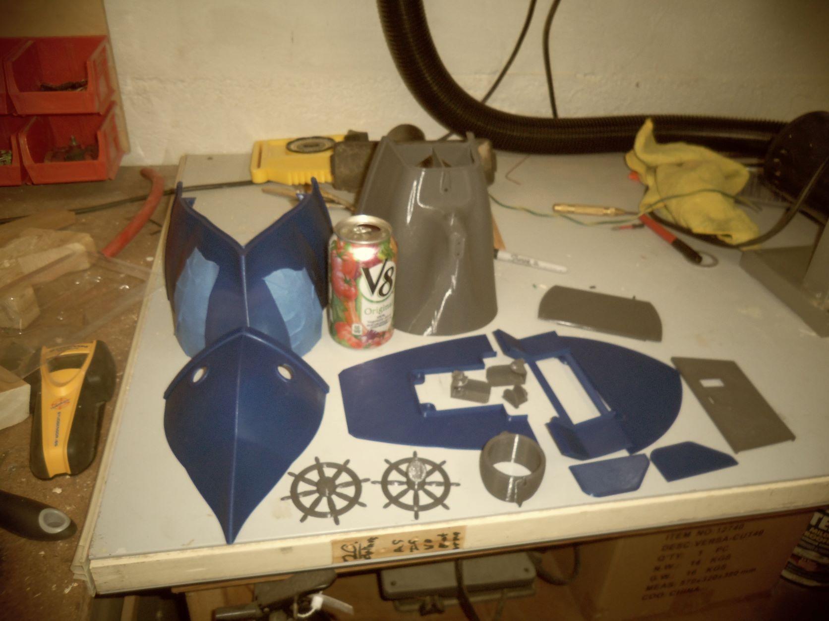

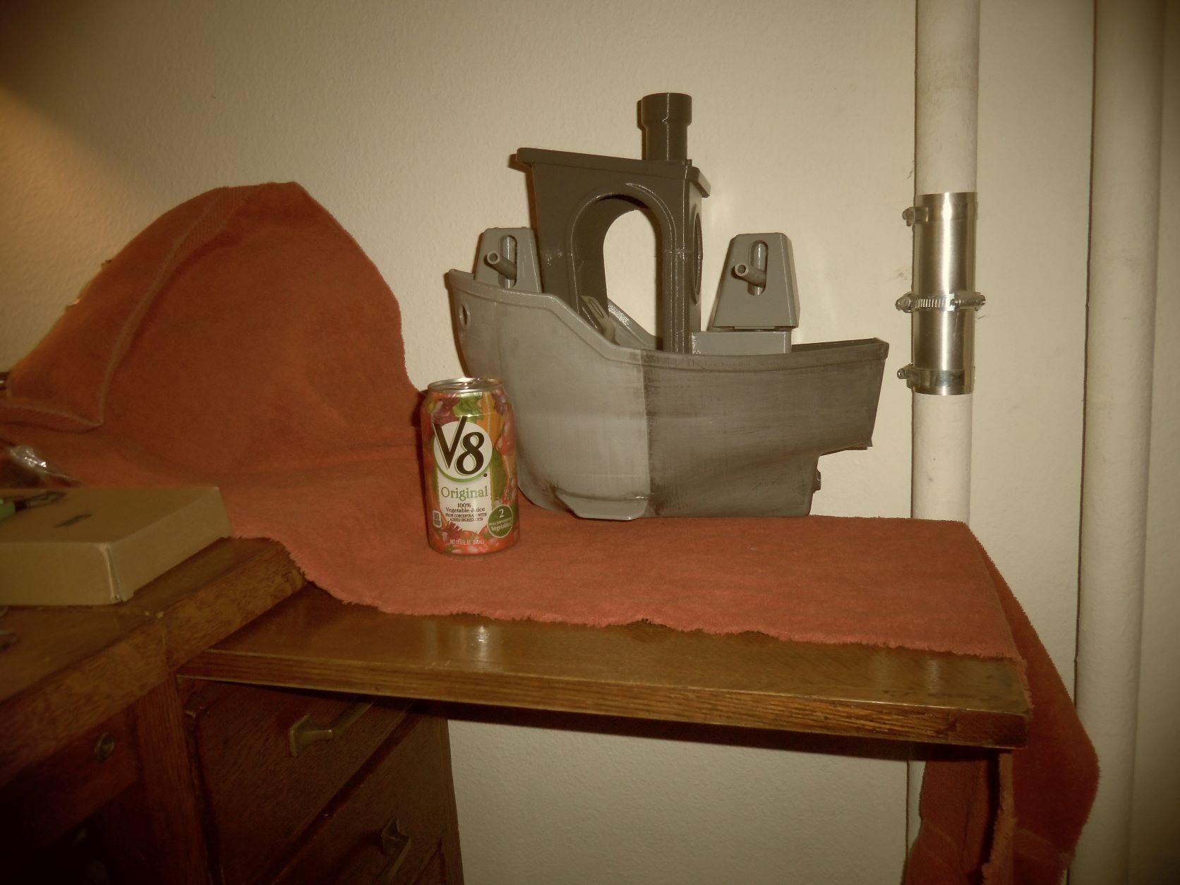

The attachment is a group shot of almost all the stuff I've got printed so far.  There's an empty 12oz can included for a size reference.  I say almost all because I KNOW there's one more part someplace.   I remember stepping on the little sucker in my stocking feet - don't remember where it went after that though.
I was off in my size estimate.  This Benchy will be about 15-16" long, and it's about 7-1/2" wide.  From the STL files you can decide if you want to build the fishing boat version, or the tugboat version.   I'm seriously considering building Option 3 - the Heavily Armed Tugboat version - The S.S. Dreadnought Benchy.
I started another part on the printer last night, the bottom of the cabin for the tug version.  The part on the printer was about half done when I left for work this morning.  It'll either be done and waiting for me when I get home, or I'll have a mess to clean up when I get home.

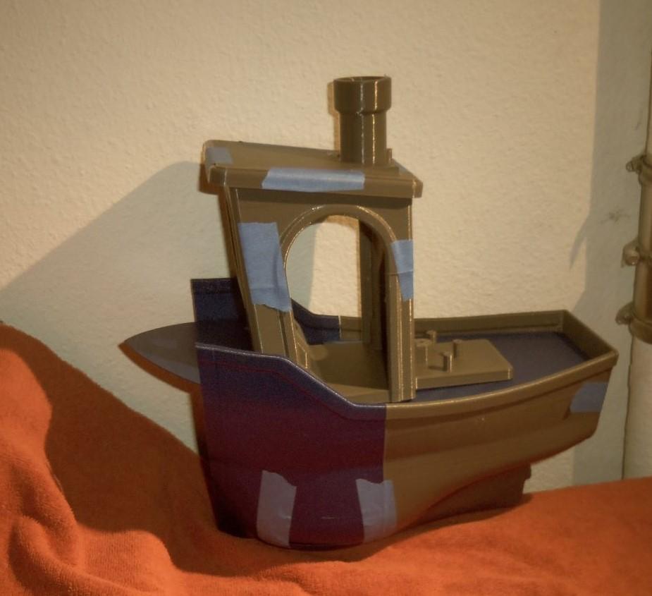

Well, it was done when I got home, just one little problem...  IT DIDN'T FIT!!! It was too small and wouldn't fit over the deck opening.  It was a 15 hour print and I apparently didn't scale the part to allow for shrinkage.  I tried printing new deck parts to match, but they were too small for the hull.  Oh well, nothing for it but to re-print the lower cabin - properly scaled this time.
I started fitting the parts together and the attachment is is what I've got.
The more I looked at it, and the fit of that blue hull part, the more I didn't like it.  That's the second time I printed that part and I got a layer shift both times at about the same height both times.  Also both times I printed the part, one side had started to lift off the print bed.  I started printing it for the 3rd time about 5:00 yesterday afternoon, it should be getting done about the time I get home from work.  This time I added some support, and a brim to keep it attached to the print bed.  When it started printing I saw that I wasn't getting good adhesion in the area that let go on the other 2 prints.  I canceled the print and got out the glue stick.  That seems to have done the trick, I'll find out for sure when I get home.

The reprinted hull section printed with the brim and the support worked perfectly.  When I printed the blue hull section it has peeled loose from the build plate in same spot, at the portside railing.  You could see a gap between the part and the build plate for about 25-30mm down from the railing.  As the part was printing I would hear a ticking sound periodically.  It was printing an overhang, and the overhang was shrinking and curling up as it cooled.  This was at about the height where the layer shift occurred.  My theory was that the printhead hitting this curled up plastic made the ticking sound, and eventually caused the printer to lose steps, giving me the layer shift.  Along with the layer shift, the bow curve was definitely not a smooth curve .
I reprinted this part, for the third time, only this time I added a brim to keep the part stuck down to the build plate.  I also had concerns about the unsupported side of the part wanting to pull inwards as they cooled, this was a 25 hour print after all.  So I supported the sides in several places.  The part would print without support, that's how both of the blue parts were printed, they only took about 18 hours.  If I had used all of the automatically generated support it would have been a 33-34 hour print.  Anyway the brim and support worked and the part fits about as well as you can expect from an FDM printer.

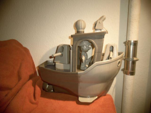

Friday night when I got home, my Weldon #4 order was waiting in my mailbox.  So Benchy is starting to come together - literally.  Benchy's hull is now in one piece, it's not water-tight yet, but it's in one piece.
As you can see in the picture, Benchy had his V8, and in the process he grew some TEETH.
The turret's kind of like a cartoon version of the deck gun on a USN destroyer, that or a cartoon Imperial Scout Walker.  Either description would be appropriate.
There's a WHOLE lot of sanding to be done to smooth out the layer lines to get the hull ready for paint.  And almost every other printed part as far as that goes.

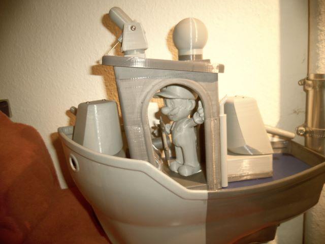

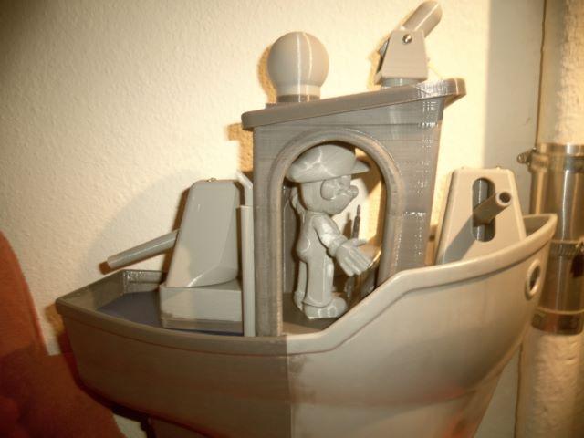

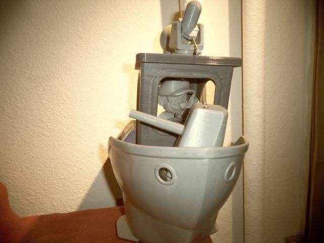

Take a look at this and see what you think, has Benchy got a Cap'n?   (I think so.)
Here's a slightly blurry side view.
I printed Mario out at 100% and stuck him in the wheel-house, he was just too small.  I reprinted this version at 120%, which I think looks a LOT more better.  I think he's going to have to go under the knife and have a little surgery on his right arm though.  To make it look more like he's holding the wheel, and less like he's just standing there like a Dork.
Benchey got several other modifications.  He got his Close In Weapon System, his smoke-stack was modified to be a radome, and he got his diesel exhaust stacks.  I originally had a really neat set of barrels designed for what was supposed to be a Mini-gun.  I took one look at the printed version, realized that they were WAY TOO SMALL, and said - "Nope, not gonna happen."  The Mini-gun then got replaced with the chain-gun seen in the picture.  As you can see this is not just a Close In Weapon System, it's a REALLY Close In Weapon System.  In fact it could be used to pick-off the seagulls and keep them from crapping on top of the turret.  I've got some seagull figurines on order to set up just such a scene.
I've got to get some more hardware, motor, ESC, prop, bearings, prop-shaft, rudder-post, and all the other Bit's and Bob needed to make a functional boat - that I haven't already got stashed away somewhere.
Then Benchy will be almost ready for the test pond, and his weights and balance testing.  Painting will be done after that.

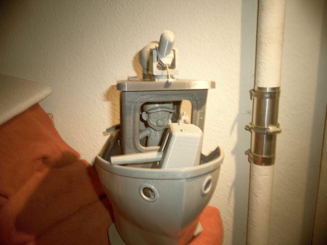

Mario is out of surgery and recovering nicely.  His time spent under the knife wasn't too drastic.  I just bent his arm a little, and twisted it a bit.  Just enough so that he doesn't look quite so much like he's the Fonz going Heyyyyyyy.  I'll get a little filler on his arm, enough to cover the scar and give him a bit of an elbow.
Re: RC Benchy
« Reply #13 on: April 21, 2022, 03:52:56 PM »
Did you use physical tools for that?
Offline ddmckee54
  • Posts: 376
Re: RC Benchy
« Reply #14 on: April 22, 2022, 12:22:37 PM »
Oh yeah, I don't have the software tools to do it any other way.  I just amputated his arm at the elbow and then reattached it.  I think it turned out OK.  Here's a couple of views of the wheelhouse, this first one is from forward looking into the wheelhouse.
This next one is looking at the port side.  I plan to attach a chain to Mario's left hand to make it look like he's going to sound the horn.
This last one is looking at the starboard side.  I didn't get too crazy with how much I bent his arm, wasn't exactly sure where his hand would wind up in relation to the wheel.  I think it looks OK.

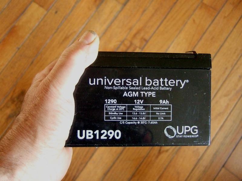

The instructions on Thingiverse said it needed around 1Kg of ballast.  One of the upgrades on Thingiverse were glue on "fins" to keep him from rolling so much in turns.  I printed my own version as bilge keels.  I'm not sure if the ESC that I've got coming is 2S/3S, or just 2S.  I should have an old 6V SLA battery from my first boat.  I changed it to a 12V, probably wasn't a good idea since the boat now sits a little too low in the water.
I can kind of relate to the unintentional sailboat bit.  I converted my first boat, a "Dickie's Workboat", to use a real RC system instead of the POS it originally had.  I was playing around with it one evening and I realized that I couldn't turn any direction other that to the right.  I was alone and had NO way of getting to the boat.  After a few minutes I realized that the boat didn't turn as sharply to the right in reverse and it did going forward.  After about 10 minutes of see-sawing back and forth I was able to get the boat close enough to the bank that I could grab it.
Since that day part of the gear that goes with me when I take a boat out is a collapsible fishing rod with some line, some sinkers, a bobber, and a blunted treble hook.  I try not to sail any farther away from the bank than I can cast the line.  The boat might get a little banged up if it gets hit by the sinkers, but the way I see it that's better than losing the boat.  Haven't needed it yet, wonder if I need a special fishing license for RC boats?

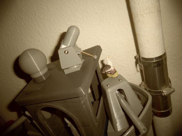

My seagull figurines showed up yesterday.  When I ordered them there were 3 poses of bird in the ad, so naturally I ASSUMED I'd get one of all 3 poses.... Not so much, I got 3 copies of the same pose.  Oh well, I can work with it.  I had to try it out to see if the birds were about the right scale.
Whatcha think, I think it looks about right.  They're resin, so they'll be fairly easy to modify into a sitting down bird and get rid of the pilings.
