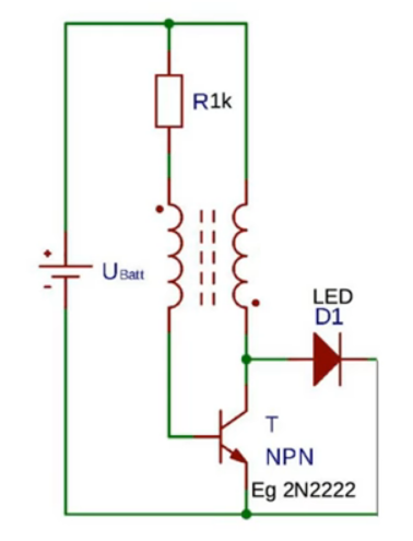

It's basically simple circuit like this:

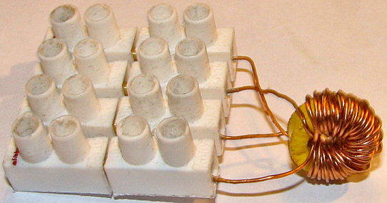

There are dozens upon dozens of versions of it, but generally one thing appears to be common between them: toroidal bifilar coil. And they are pita to wrap, especially if one would like to experiment with different sizes:

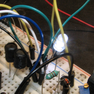

Current circuit on breadboard:

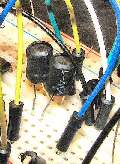

Then somewhere came the idea to test instead with two separate 180uH inductors side by side:
It's weird, but it seems to work. To make sure, that the oscillation happens between those two coils, I pulled them slightly apart, and it stopped.

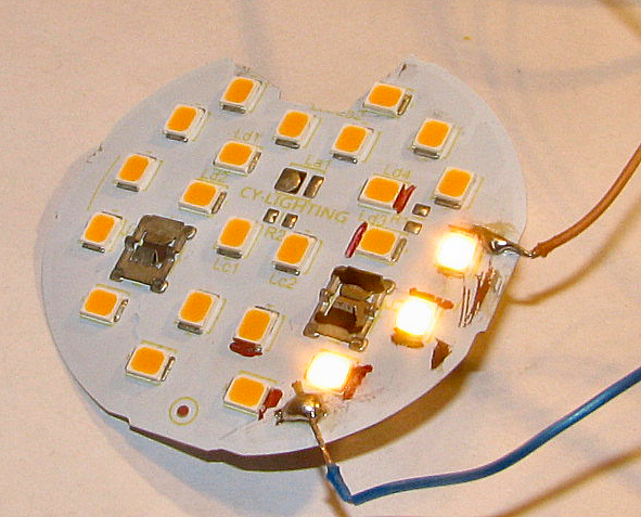

The results with current settings so far, with 3V led at 0,8V 48mA:
Three 15V(or perhaps rated at 18-20V like similar size 2835 leds) leds at 0,8V 54mA:
In both cases, the leds aren't overly bright, though. I tried increasing the voltage to 1V and above, but it starts to use excess amount of current, like 100mA or about as much as the source provides, even when there are no leds connected.
Nothing weird :-) the two coils are magnetically coupled when close  just as if they were wound on the same former . If you place  pieces a permeable material on the top and bottom , you'd have a toroid .
