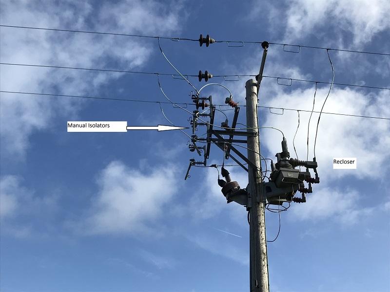

Thanks Pete,
I've just managed to collar a couple of UK Power Networks staff working on their equipment.
It turns out that the 'Recloser' has operated so many times in recent days that it has burnt off it's contacts. This unit sits on a pole and takes in the 11 kV lines and is basically a whacking great three pole HV switch that can be remotely operated via radio but has internal intelligence to trip on faults and attempt remaking the switch after predetermined intervals.
So it needs replacing which is not a small job I expect  :bugeye:

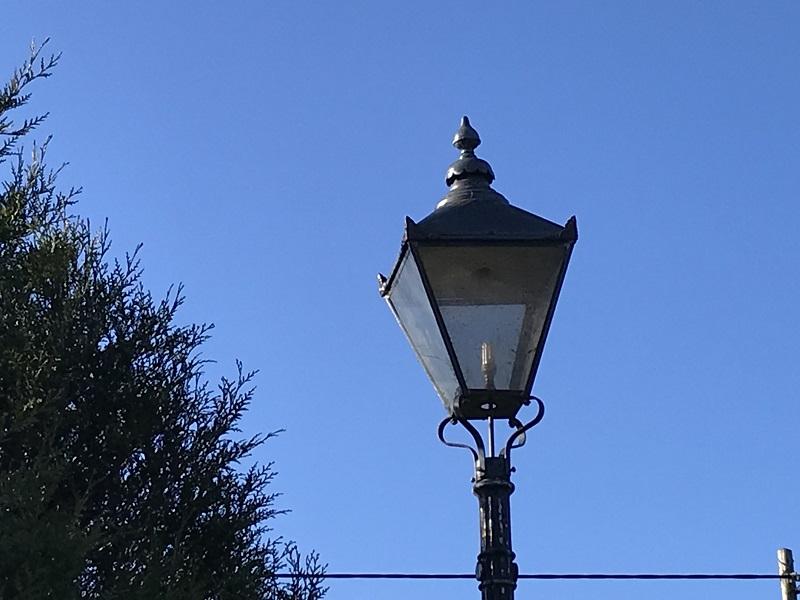

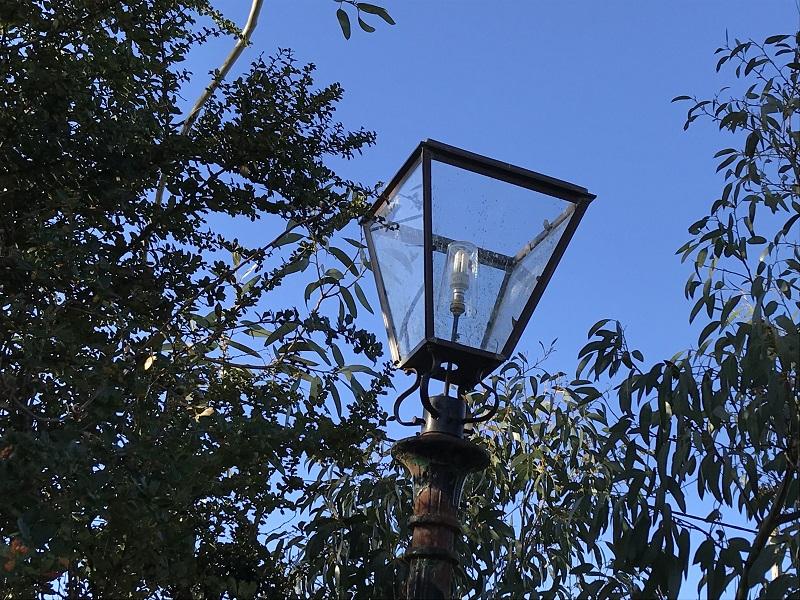

Storm Eunice blew the cap off one of our farm yard 'Street Lamps' - a large sheet metal affair that has totally vanished - no sign of it.
The result is we were getting constant RCD trips (once the mains returned !) due to rain getting into the bayonet bulb connector.
I could have put a plastic feed sack over it (my first thought) but it would blow off with the first bit of proper wind and look unsightly.
. . . my solution . .  :beer: Put an inverted pint beer glass over the bulb - it sheds the rain nicely and the light shines through .
First picture - the missing cap
Second picture - how it should be.

That is a shame Andrew. Quite a job to make another cap like that.
It must be around somewhere  :Doh:

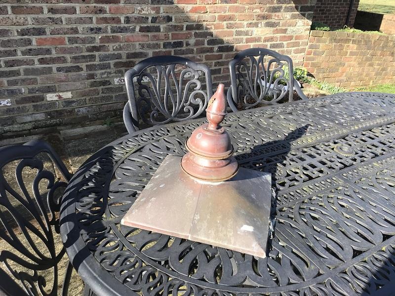

That that was lost is found  :ddb: :ddb: :ddb:
Actually hadn't travelled far and has sustained remarkably little damage - just a bit of bending needed. It hinges on two sliding pin hinges and a third one on the opposite edge acts as a retaining latch. Hinges made from copper and pins look to be brass.
. . . needs a bit of re-engineering. Simple job if down on the ground but not too clever at the top of a ladder. I'll probably have to remove the entire head, bring it to ground and fix it but as the electrical bits won't fit through the hole in the base plate it'll need disconnecting first. I've a feeling that hole may end up bigger when it goes back!

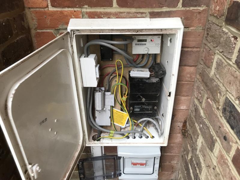

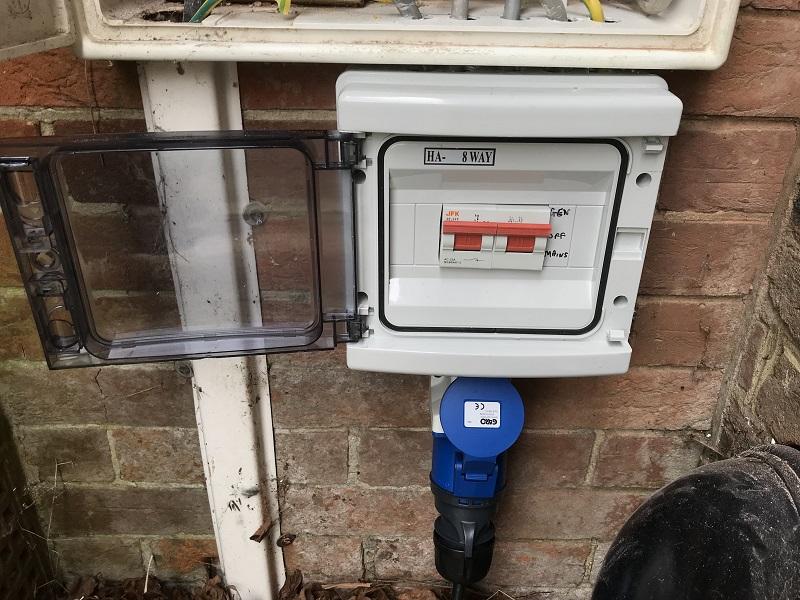

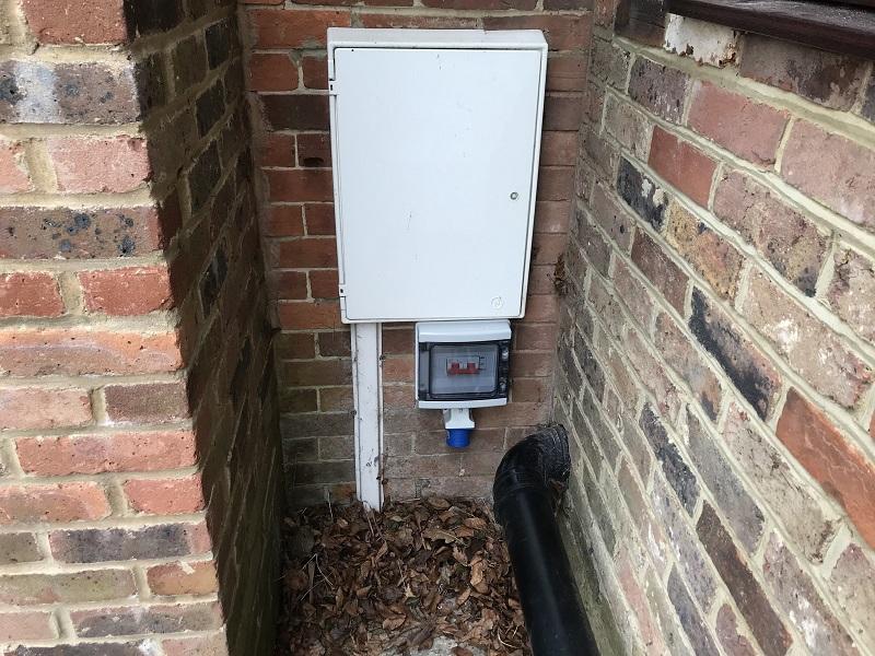

The stars were in alignment today - Not raining and cottage guests leaving at 09:00 so I could plan to connect up the generator change over unit and input socket.
Last night I'd told the guests that power was going off at 10 am being 1 hour after their check out time, so I'm afraid despite that fact they hadn't left I threw the switch at precisely 10 AM internet time  :clap:
Theoretically a straight forward job as my meter box was already equipped with an isolator switch that I'd had fitted some years back, but made fiddly as the box is at the end of a bit of a blind alleyway.
Apart from the fact that 25 mm csa meter tails have a will of their own, and a habit of loosening fastenings at one end when you fix the other despite torquing the screws close to shearing point, it all went well and I'm still alive  :ddb:
Put it back on mains initially while I tidied up, then ran on generator for half an hour to prove all was well - no hot cables etc, then reverted to mains.
Hopefully having done this at last will ensure we NEVER have another power cut or the need to use it.
Although I've only put a 32 amp input socket on it, all the internals are stout enough that I can replace that with a 63 amp commando input should I ever find a 20 kva diesel enclosed silent generator which would be much more satisfactory.
(Don't blame me for the excessively long earth cable - that was UK Power Networks when the box was installed and both ends are in sealed terminals :bang:  )

Tut, tut Andrew. You know that you're going to find a 20kVA generator. You've now made work for yourself by not fitting the 63A commando  :lol: :lol:
Nicely done, BTW.

Being the cautious type, what’s the failure mode of your changeover switch?
I’d hate for it to fail in a fashion whereby the incoming mains is parallel up with the genset…. :zap: :zap: :zap:
Re: Storm Eunice
« Reply #17 on: March 07, 2022, 07:16:23 AM »
It's a three position manual switch so you switch through all isolated when going from mains to generator or vice-versa.
I suppose a welded together connector pair might make an issue but it's rated at 125 amps (and 200,000 operations) and that's at least double what it's ever likely to carry when on mains, and far less when on generator.
At the worst were your scenario to occur the generator would go pop, but I expect in reality its 32 amp circuit breaker would trip.

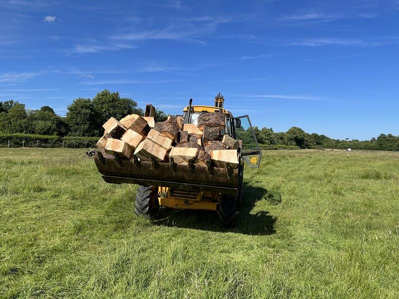

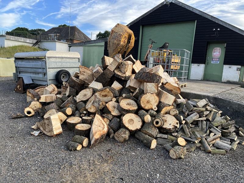

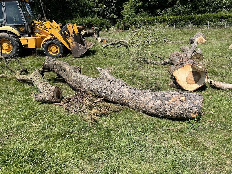

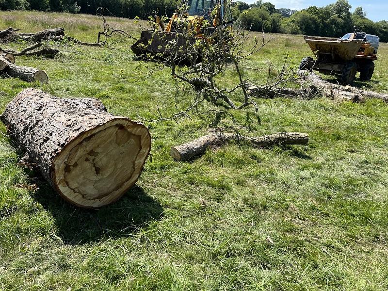

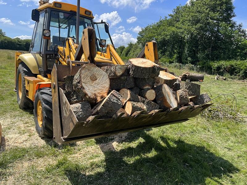

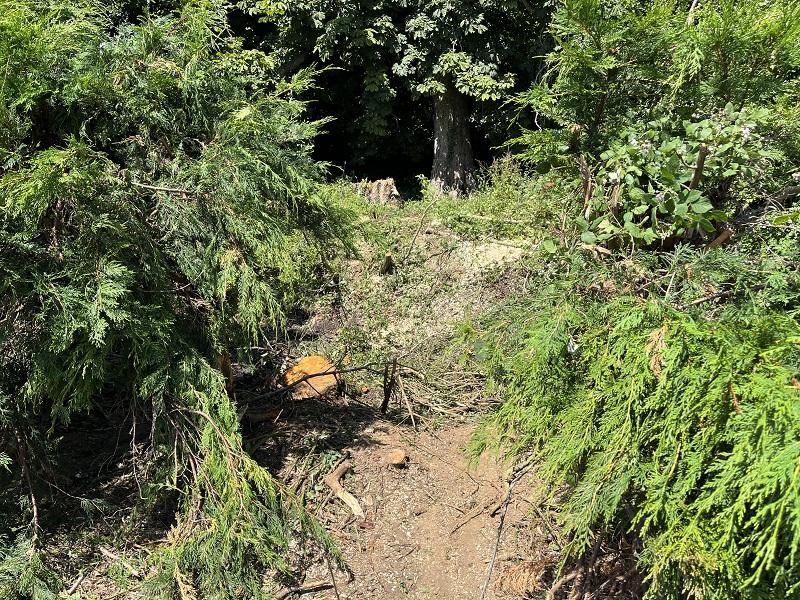

At long last I've been able to secure the services of a Tree Surgeon and clear up the Sweet Chestnut tree that came down in Storm Eunice. He's the son of a friend but has been incredibly busy up until now due partly to the storm.
This Chestnut had fallen across one (currently dry) ditch, flattened my stock fencing and demolished a tap stand.
The task: - Cut it into manageable parts, drag it across the ditch and through the Leylandii hedge and slice it into 10" 'rounds' that I can split for use on our log burner in years to come. So repetitive chopping, tying up, pulling out and slicing for which he needed a chain saw with a 30" bar  :bugeye:
Numerous trips up and down the field bringing the rounds into the yard - the JCB has earned it's keep today  :bugeye:

So the next job is to set up for log splitting. Fortunately I recently acquired five IBC caged 1 cubic metre tanks which will produce ten log storage stillages when I've removed the plastic tank and drilled loads of ventilation holes in them.
 . . at least we now have fuel in store for several years to come  :thumbup:

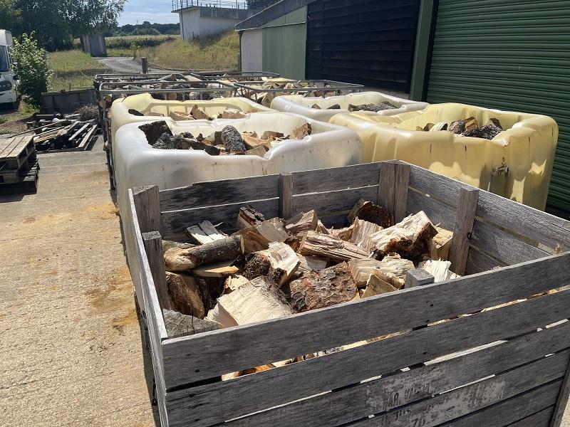

Well I finally finished log splitting this morning - or at least as much as I'm doing as I've run out of stillages to put them in!
There's barely half a stillage left but I'll probably leave it at that unless I can distribute the remainder in existing bins, as they tend to settle a bit as they are moved.
I'm taking a break from physical work for a bit as this lot has taken it's toll :(
So that's eight stillages stacked in the Tractor Shed, a further ten on the concrete outside my workshop, and the log store near the house (a bit like the ready to use ammunition locker at a gun emplacement!) is crammed full.
We should be good for log fires for a few years now - a bit of insurance against future oil shortages  :thumbup:
Re: Storm Eunice
« Reply #23 on: July 12, 2022, 03:03:25 PM »
Good work Andrew.  :thumbup: That's a little under 4 cords by our measure, or 7 face cords (which is what our local cutters like to sell as "cords"). We go through just a little less each year. I cut and split ours myself on our land, a yearly ritual.
Just eyeing some trees now.  :beer:

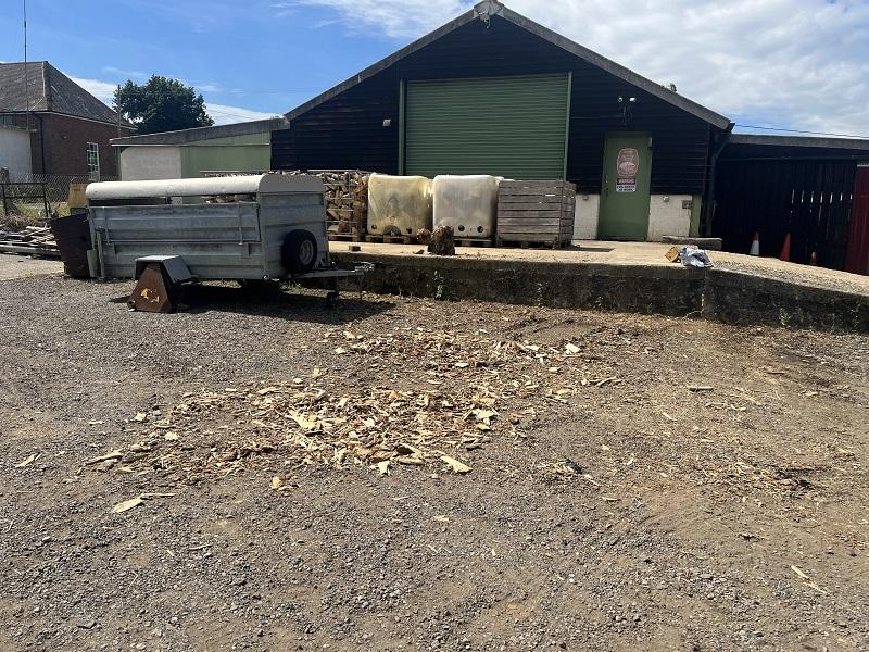

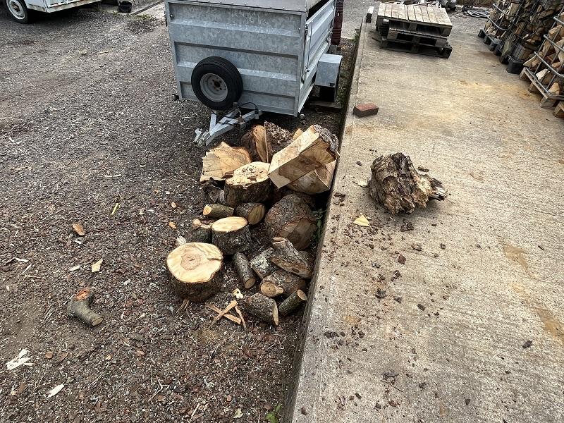

Well the 'barely half a stillage left' translated into a practically full apple bin. This is the last of the apple bins that I used to use for logs years ago, but they were falling apart when I got them. I'd extended their sides to 1 metre so roughly the same capacity as the stillages I'm now using.
So that's the log pile all split bar one lump that's so decayed I don't know why I brought it in from the field  :scratch:
Just need to rake up the fallout, bag it as kindling and find a home for it but it's far too hot to do that now - currently downing a pint of chilled milk !

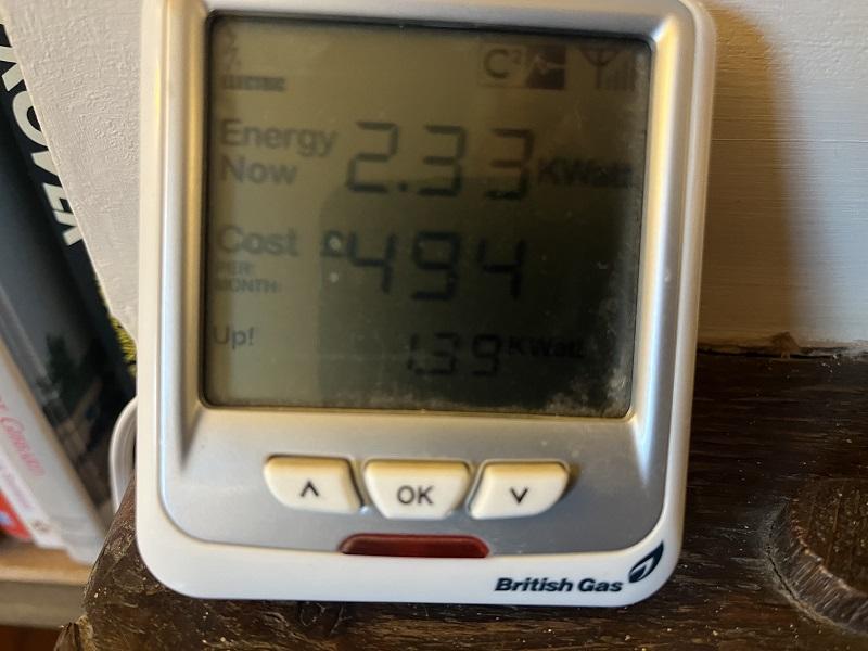

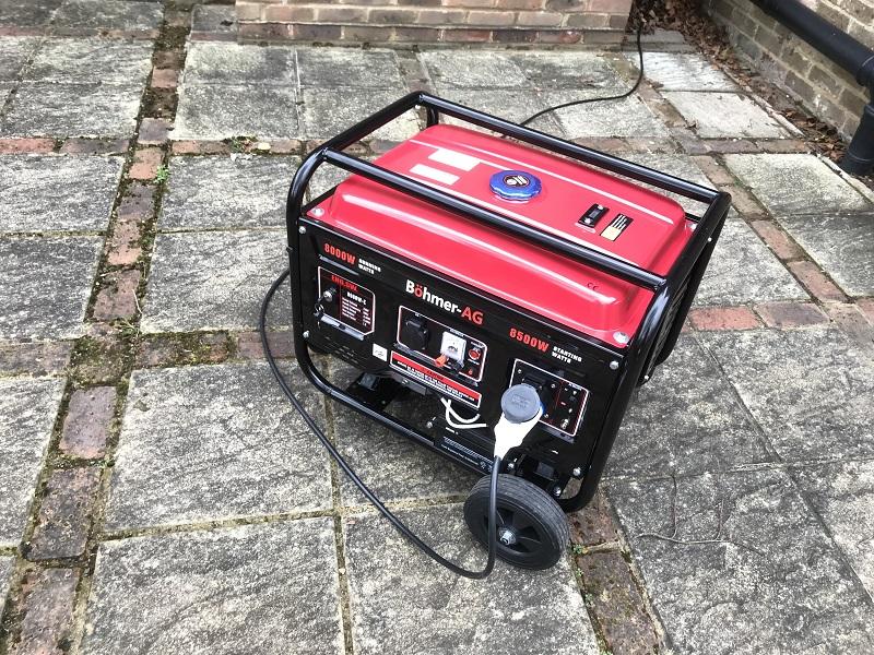

Well the Standby Generator that I installed following Storm Eunice has come into it's own tonight  :thumbup:
Very high winds here and over head supply make it not surprising that we are off grid power. I do regular 'start tests' about every month on this generator but this is the first time I've actually used it in earnest. Usually we are back on supply after about 20 mins so I don't bother dragging it out, but they are saying 10 pm before it 'may' be back on.
Seems to be going magnificently with loads varying from 1 KW up to about 4.5 KW. That's our house and domestic offices and two holiday cottages which are both occupied. So I don't have full control of what loads are applied and when - after all they may boil kettles or cook super as they wish!
I've wired an Owl energy monitor on my incomer in such a way as to show my consumption whether I'm on grid or generator
« Last Edit: July 15, 2023, 03:40:41 PM by awemawson »
