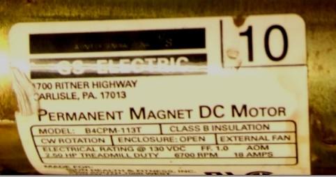

Well mc you started me thinking....I'd given the motor specs in my second post only from (faulty) memory. Mainly because it had been quite a few years since it was added to the lathe, and the tag had been painted over. So I spent the last half hour looking for old pics of the lathe during construction, to try to see if there was one that included the motor label.
Finally I found one -- had to enlarge and enhance to read it, but I was fairly far off on the specs. Here it is:
And also note that there is a 5 to 1 reduction via toothed drive belt to the spindle as mentioned in the same post. An online motor calculator puts torque at 3.33 Nm direct drive, and I'm assuming that means 16.6 Nm after reduction. Is that correct?
