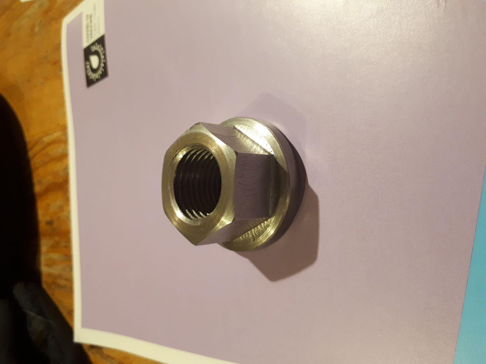

A week or two ago I needed to make an oddball 20mm metric nut but found that my internal threading tool to suit the pitch was too big to fit in the bore !! I hacked one end of a piece of 5/8 square bar down to fit the bore and brazed on the threading tip. it got the job done without waiting weeks after ordering one! The nut is made from EN24 fits the end of the crankshaft of an 8hp De Dion (1902) and holds on the clutch

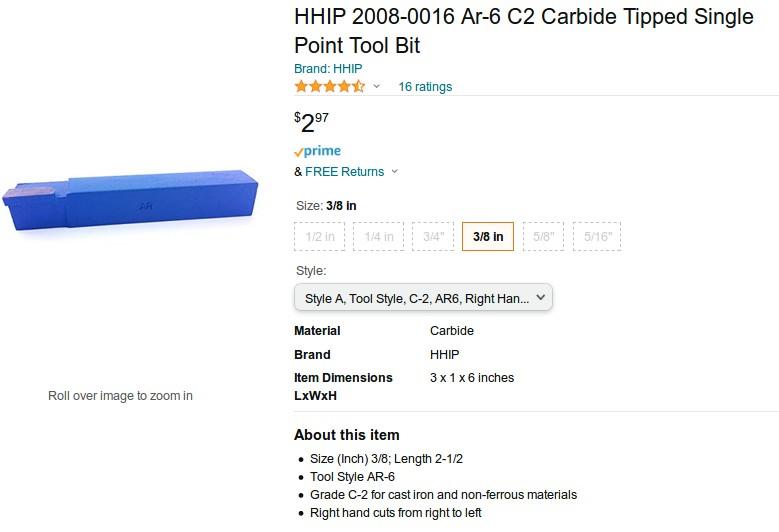

Spotted a C2 brazed 3/8" AR lathe tool bit on Amazon for under 3 bucks, so I had to give it a try. Ordered three at that price. I'm curious to see how C2 holds up.
By looks and description they look very close to tools I have been cleaning up cast iron. They need a little sharppening often. Just a little careful push on bench top grinder with a cheap greengrit or diamond wheel and quick turn to make good radius. Radius is too big if it is bigger than DOC and too small if the breaks way before dulling. keep clearance angles small to support the tip fully. Sounds like you will not be taking grazy cuts, then you don't need all out clearances, just enough to avoid rubbing.

Thanks Pekka, will do and I'll let you all know how they work out for the purpose.  :beer:

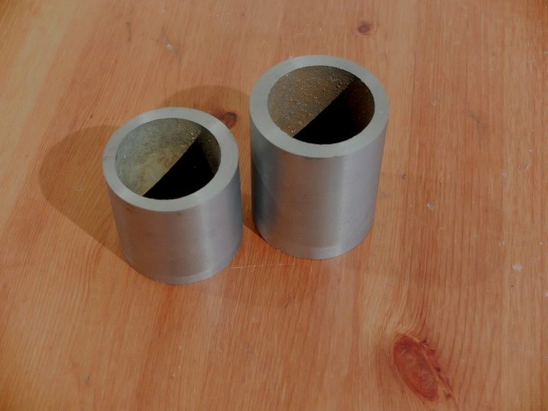

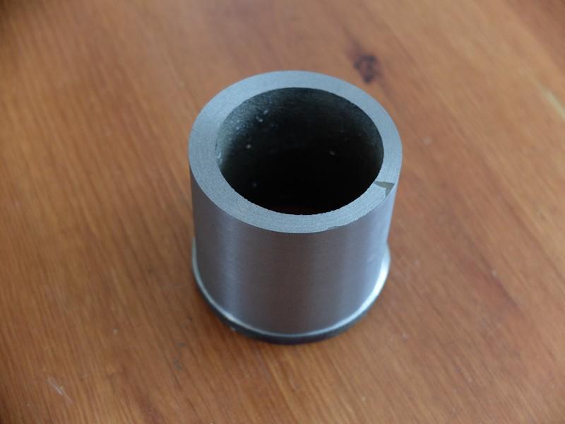

Hi mc, no nothing was printed on the side of the tools other than AR or AL, etc
I do know the original insert part number now (TCMT090204) C6 and also know that ideally I'd want a .8mm radius(TCMT090208) and C2 carbide for my application -- but hard to find that combo. I have been successful now with original replacement inserts with careful and relatively fine passes on interrupted cuts with my sand castings.
But looking forward to trying out the other tooling ordered as mentioned earlier in the thread. I actually think that the cheap-as-chips brazed C2 sticks I mentioned a couple posts ago might be the ticket for roughing these castings. We'll see, and report back.  :dremel:
Iron, casting below machined from rough with replacement original "wrong" C6  .4mm. Didn't break a corner on it.......so far. But it was slow going.

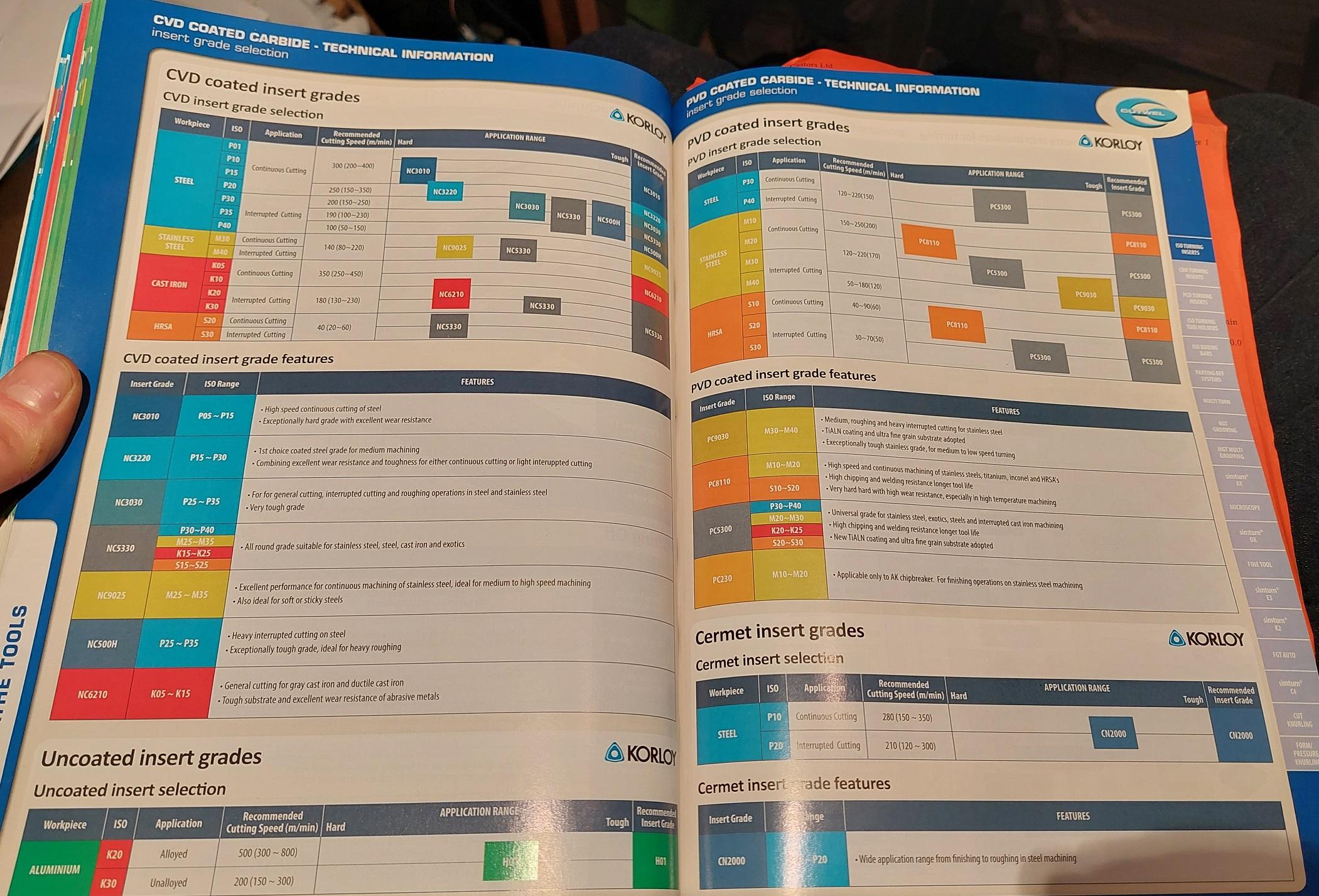

Carbide grades for inserts do vary between manufacturers, as there is no standard.
C2/C6 is pretty meaningless in the grand scheme of things.
Now you know the insert type and size, you really need to do a bit research into what different suppliers offer. Most will give recommendations for different materials, and different cuts.

To give you an idea, I've attached a photo of one brand in one of my regular suppliers catalogue. There is no mention of C grades.
(I did look for a PDF, but the only PDFs I can find are for insert types/sizes/grades with no explanation of the grades)
Every manufacturer will usually have their own grading system, which is why if you want to find the most suitable insert, you need to research what each manufacturer produce.
As well as the grade, there will also be various chip breaker options, although it's more common for the insert grade to also cover the chip breaker option now.
Then there is the option of other insert materials, like PVD (diamond - more suited to softer non-ferrous or non-metallic materials), CBN (Cubic Boron Nitride - more suited for tough/hardened materials and demanding cuts), and ceramic inserts (similar applications to CBN).
But having had a quick look at what options are available in TCMT09 size, the options seem to be very limited.
Personally, I'd suggest getting a SCLCR(or L) (or another style of holder depending on how you'd like to approach work/take cuts) that takes CCMT inserts, as even in the small 06 size, the insert options are far greater. Or if you can fit a bigger holder that takes the bigger 09 inserts, the options seem to increase more.
You do only get two usable corners on the rhombic inserts for any given holder (you can get other holders that allow you to use the larger angle corners - SCBCL/R), but they are a more popular inserts shape than triangular, so more options exist.
For the TCMT inserts, options don't really expand until you reach the size 16 inserts.

To give you an idea how cheap and reactionary I am, for carbide inserts, this is my supplier's catalog, and yup, they do stock indexable C2 inserts, not just brazed C2:
https://www.ebay.com/sch/i.html?_from=R40&_trksid=p2334524.m570.l1313&_nkw=c2+carbide+inserts&_sacat=0&LH_TitleDesc=0&_osacat=0&_odkw=c2+carbide+inserts
Of course I have no objection to brazed C2 tooling -- as mentioned earlier, I just ordered three of them to see what they will do when pitted against one of my home castings.

Today I received the three $3 Chinese 3/8" C2 carbide brazed lathe tools, so I put one to work right away. It did great, taking off rough surface iron from the sand cast hot piston in an interrupted cut (~ 0.125" eccentric) with no problem. It seemed to have almost no nose radius and I haven't ground it on the green stone yet, but it performed well enough anyway. Last pass looks good and finish consistent with the first. No chipping or breakage and it looks like no wear.
I was cutting .010-015", didn't go deeper mainly because the casting was unsupported by the tailstock. I didn't want to jar it out of the three jaw where I was holding it by the bore. I wanted to reduce bore eccentricity, rather than that of the surface. That just makes boring easier.
I'm very pleased with these inexpensive brazed tools for my particular purpose. A definite bargain.
Below are the roughed out hot piston (taller one) and the cold piston, which was done earlier with a carbide indexable insert tool. The brazed tool was faster to finish the job, even though the casting was longer.
